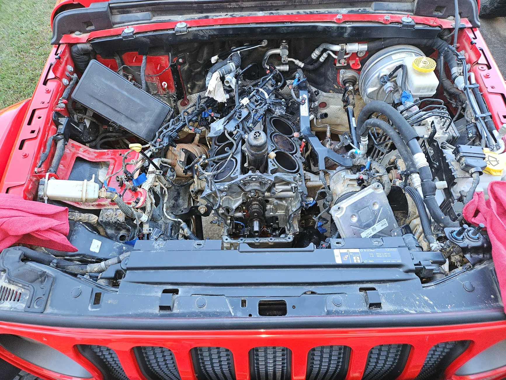

I'll confirm in soon, but I don't think the lower bolts have to be completely removed to yank the heads.
Each cat has 4 bolts; 2 on top that go thru the cat flange into head, and 2 below that go thru an intermediate clamping bracket that seats the cat flange to head. The top 2 are easy to remove. The bottom/rear on both sides are tough to access. On the pass. side, it seems like there's no room to completely remove this clamping bracket, so I wiggled the cat up/outboard, then snugged the lower bolts and the clamping bracket back into the head without clamping the cat flange. It looks like there will be enough clearance to pull the head straight off the block.

Alright, time for a little keyboard time, order some parts and get this back together.

You're making good progress. What other parts are you replacing 'while you're in there'?
I'll be doing this job soon as well, i have a cylinder 3 misfire and losing coolant. A borescope showed that cylinder to be perfectly steam cleaned!
How many hours in are you so far?

I figure about 26 hours to get to this point. That's about 5 separate days of 3-5 hrs, then an hour here or there.
All basic handtools except the pneumatic impact for the crank pulley bolt and one of the cam phaser nuts to get the timing chain off.

As far as parts to replace...I'm still deciding. My rear 2 cylinders look awful with carbon deposits. I'll post the pics separate post.
Of course all the basic gaskets, Mopar OEM. They have a couple different kit p/n's with overlapping content, need to sort that out. None of them include the head gaskets themselves.
PCV valve
Thermostat
Spark Plugs
Oil cooler (probably)
Head bolts looked alright, I'm leaning towards reusing them. Factory service manual even says its OK to do so if they're not necked down/yielded.
The cylinder heads are the big unknown to me. I haven't inspected closely for flatness. With the carbon build-up and oil fouling, it maybe be simpler and almost as cost effective to just get a new set.
and the Mopar sealant...
