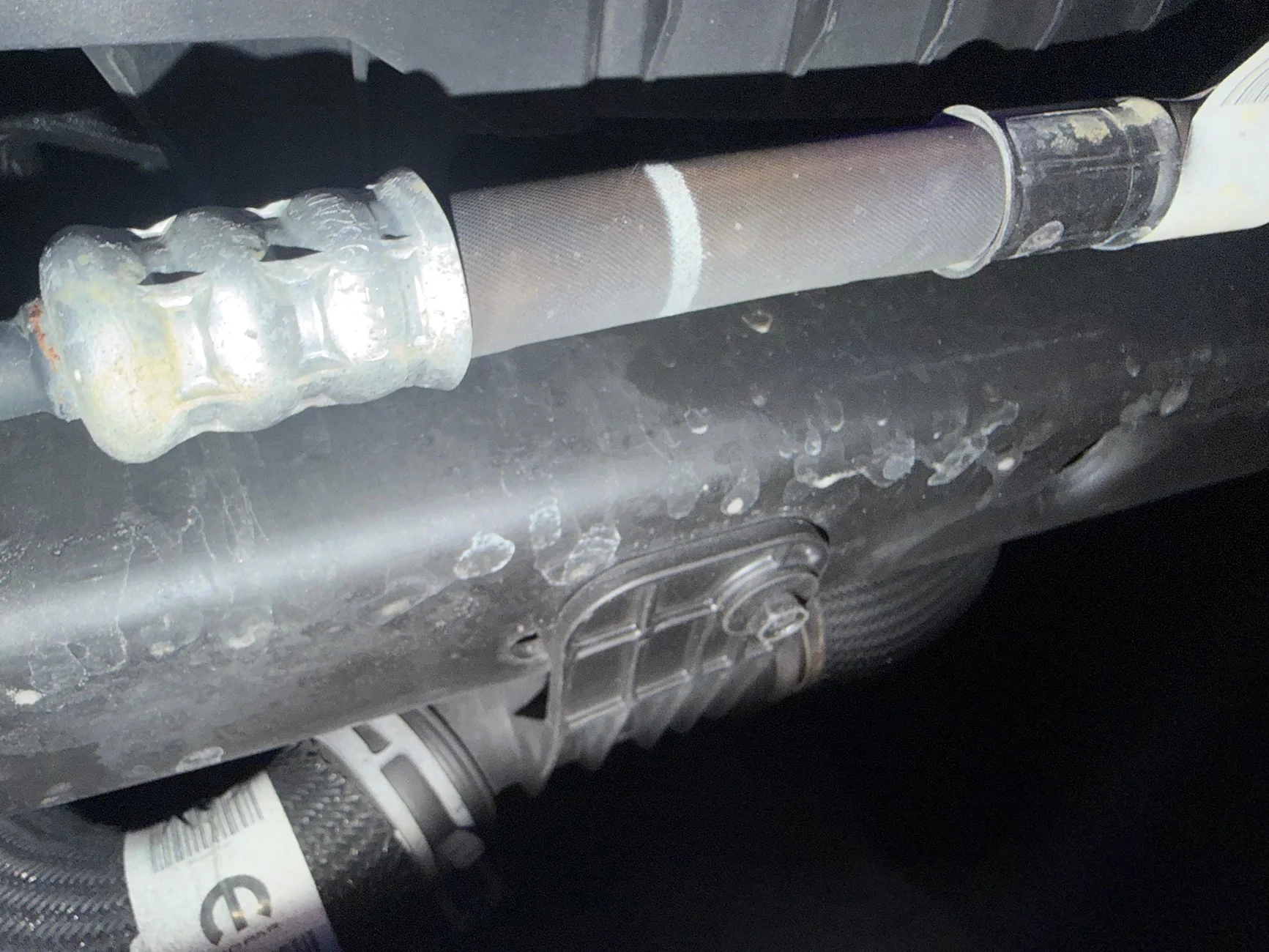

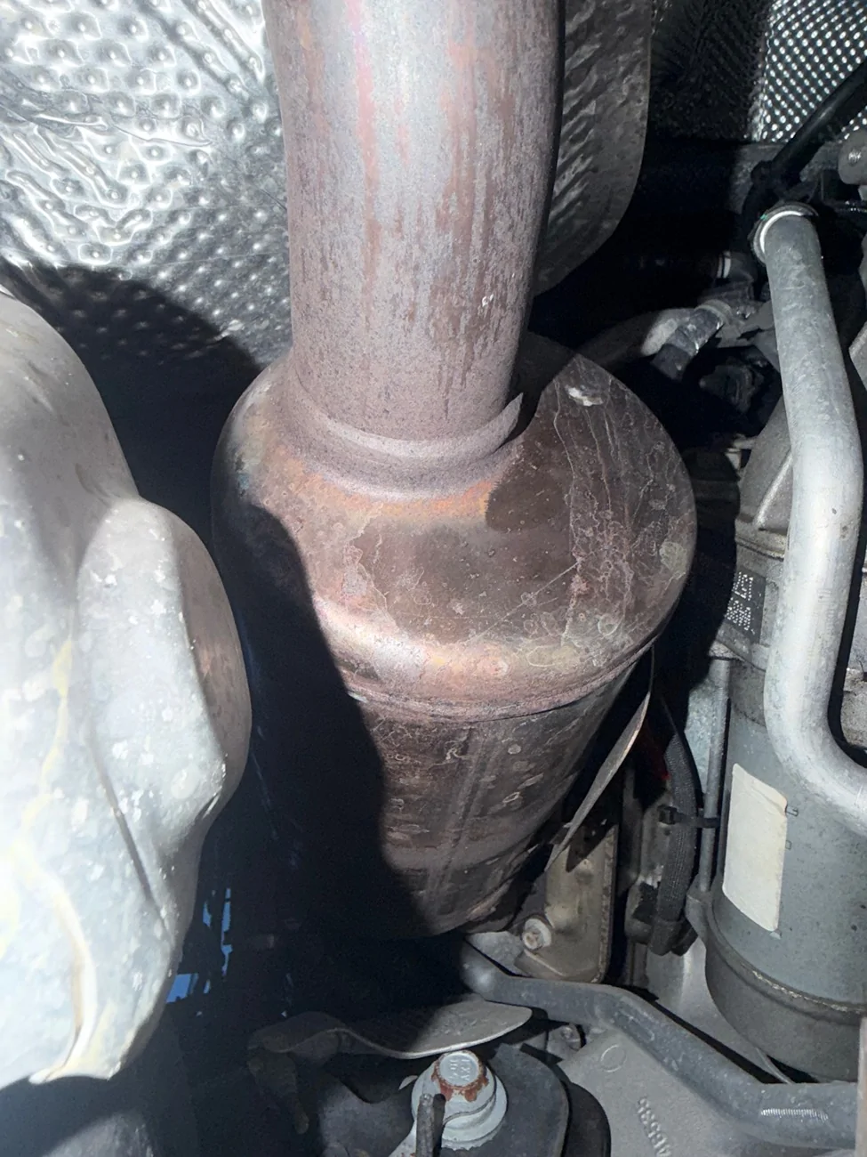

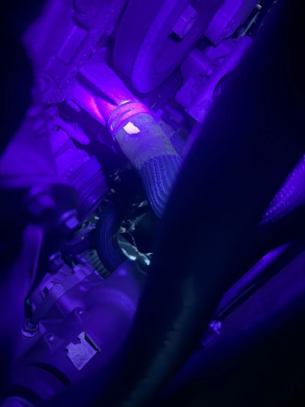

So using a UV light here, I found some green (which I can only imagine is coolant) from one of the hose fittings. I also found dried white stuff on the bottom of the front crossmember behind the radiator fan, and some dried white on the cat.
What do we think here? seems like tiny leaks from many places

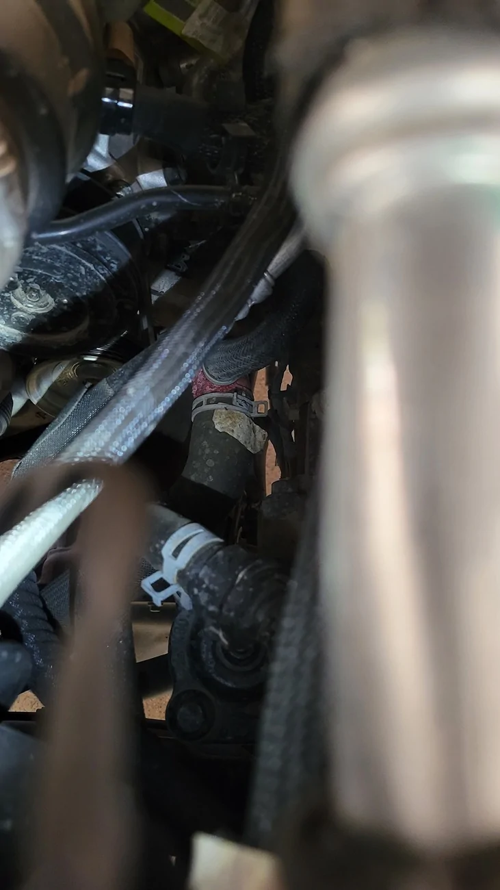

The crusty pink by the hose clamp in the middle of this pic is what a coolant leak in a JL looks like. I was slowly losing coolant but never had a drip.
