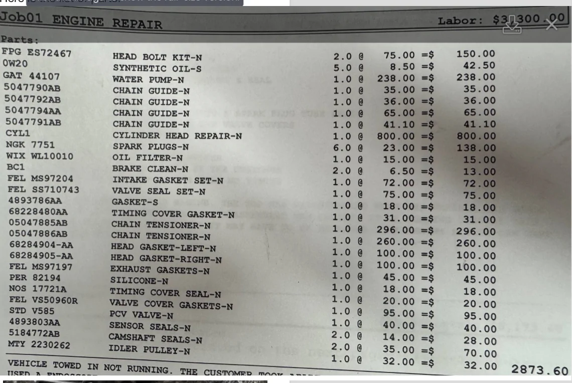

‘18 JLUR owner wirh 66k miles.
Just went through this. Just do both heads.
As other have noted, have the heads sent to a machine shop. They resurfaced mine and replaced the valve seals.
Had them replace the water pump and wear parts on the chains while they were in there.
You should be able to get better pricing but here is the list.
Keeping in mind i had just done the oil cooler so that is not on this list:
Jeep Wrangler JL head gasket swap after P0301 code IMG_4474

So, what was your total, for both heads, labor and parts?
