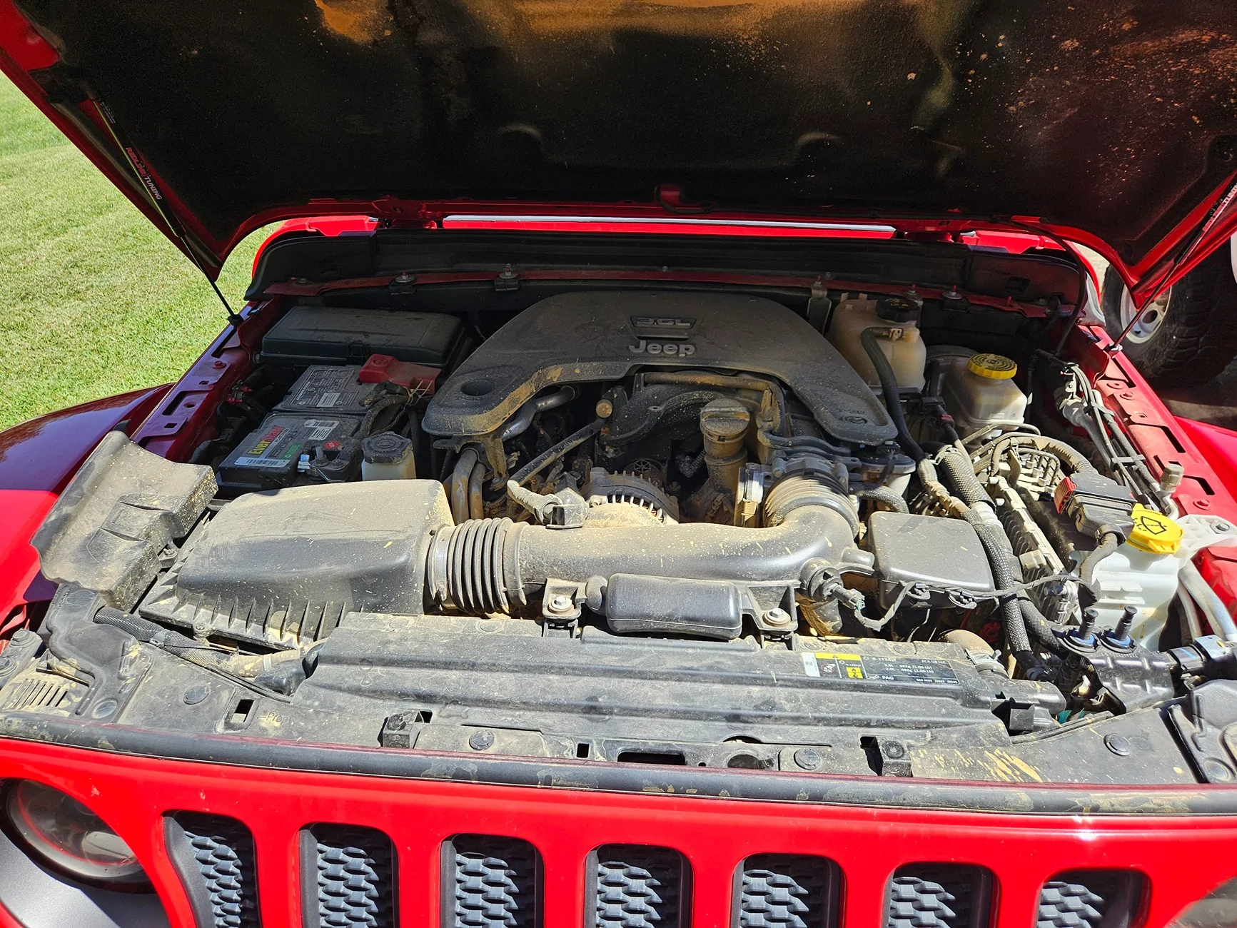

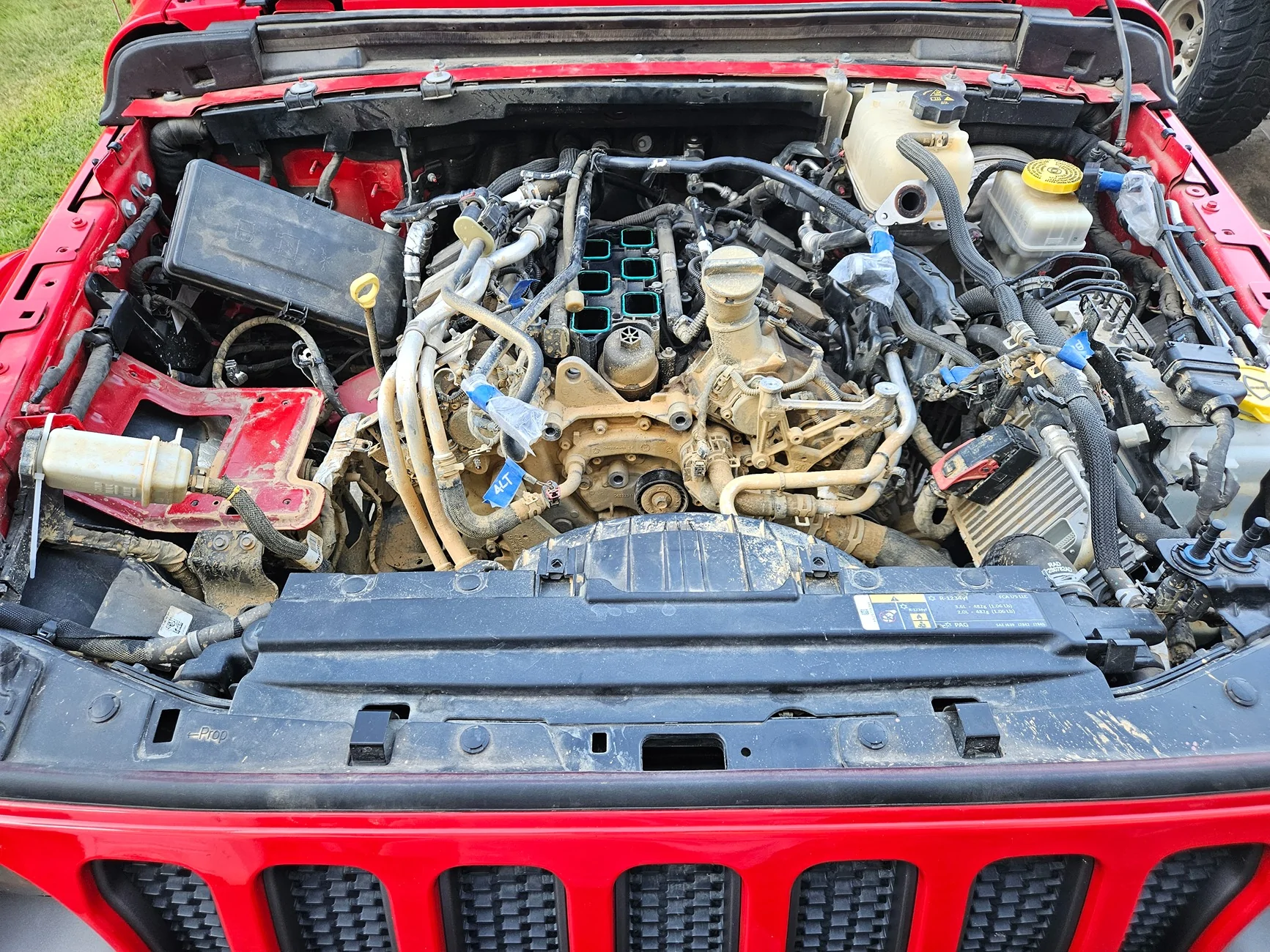

I started the tear down yesterday. Got a late start and only put in 5 hours.
Spent too much time getting the battery tray out., but finally worked it out Front of the engine went alright (front 2 alternator bolts are super tight, WTF). Never seen a hydraulic tensioner...that was interesting and also required the breaker bar.
Then the EGR valve and stacked brackets was a bigtime pain to free up the air intake. It was late in the day and I didnt feel like draining coolant, so worked around all those hoses.

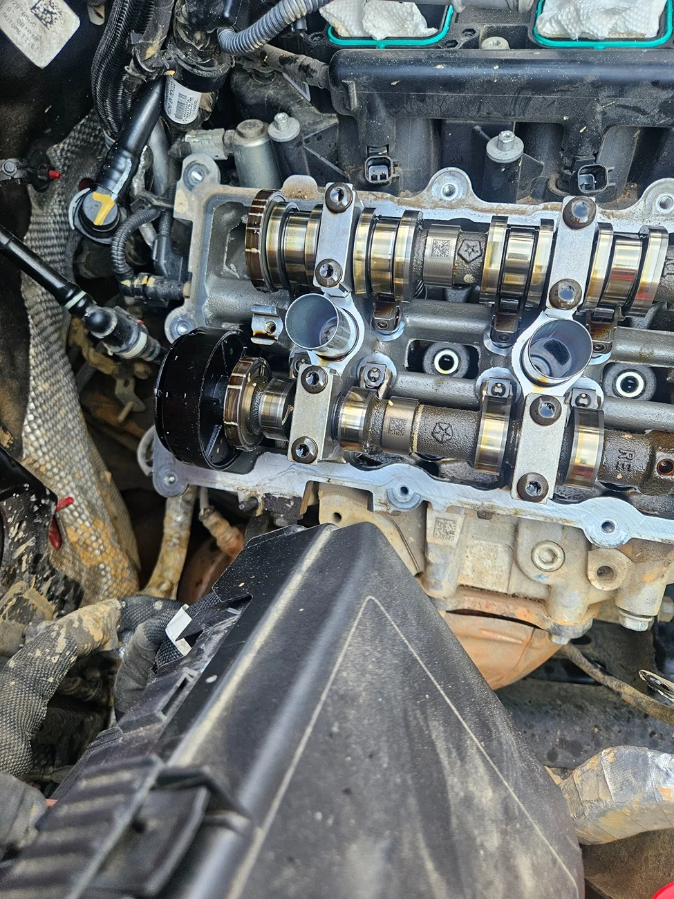

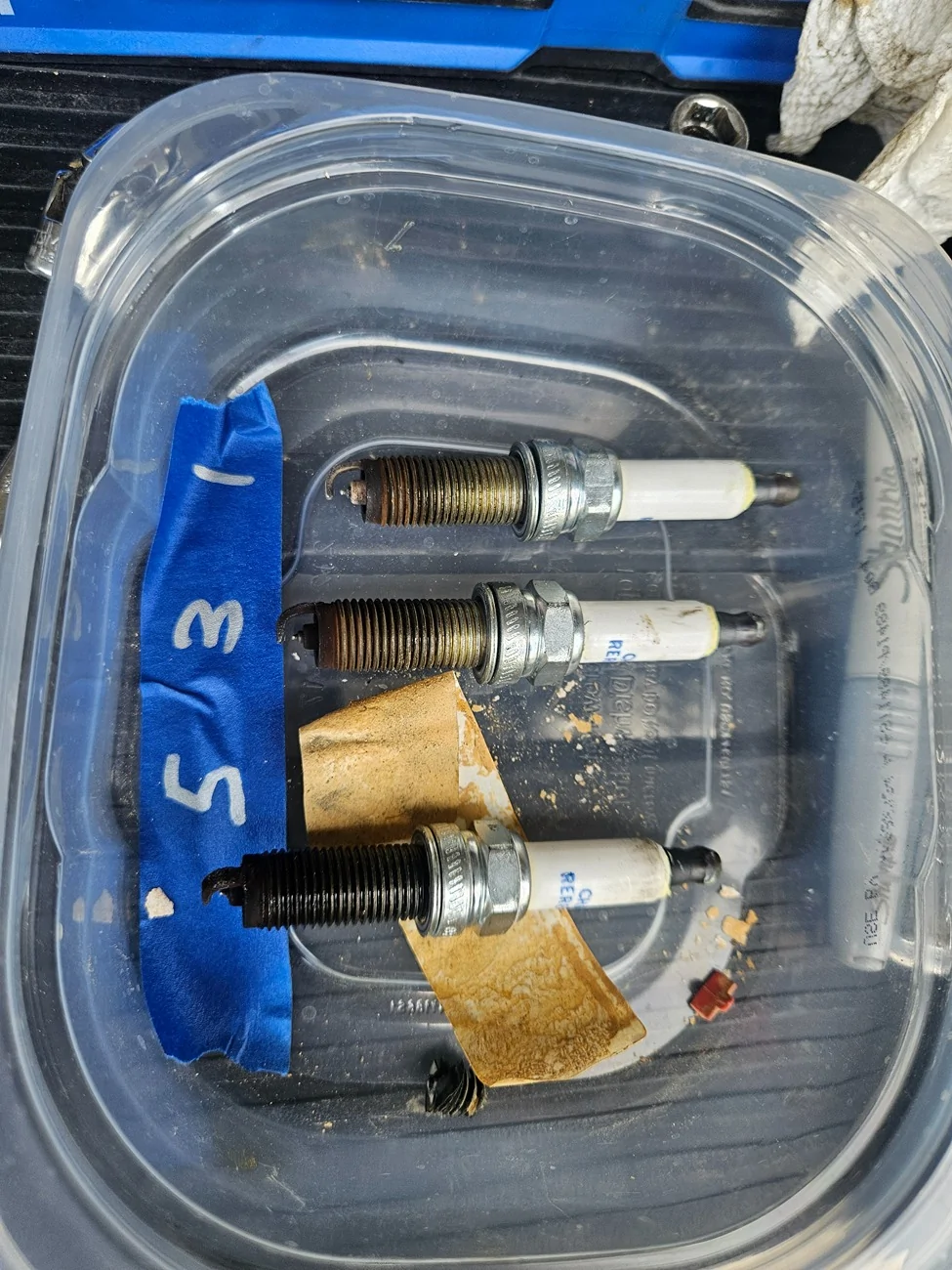

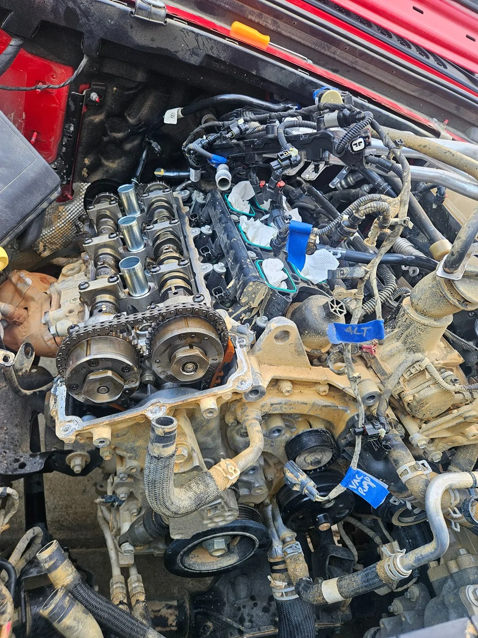

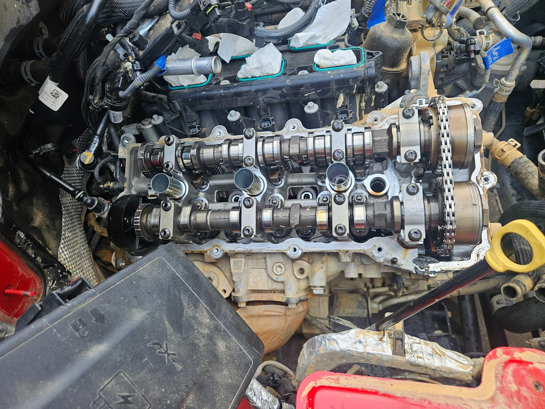

2.5 hrs more labor today, got the passenger side valve cover off.
Man I'm hating these electrical connectors.
What a PITA just to get the valve cover off.
Spark plugs didn't look terrible. 0.040 gap. #1 looked clean, as expected.due to the cylinder 1 misfire where the coolant is supected.to be leaking in. #3 normal and #5 was little oilier than expected.
Question about these odd deposits on the rear.cam inductor things, presumably magnetic. There were stripes of milkshake oil/coolant slime. In the research ive been doing, i hadnt seen anything mentioning this...is it normal? It wipes right off
Rotated.the engine to TDC. Cams looked OK to me, will know more as I get deeper into this.

The stripes on the camshaft reluctor wheel is steel dust from engine wear. The cam reluctor is magnetic. Do not allow any magnets to come into contact with these rings. Careful not to bend them either.
RenegadeT
RenegadeT
Tony
Apr 15, 2022
153
183
North Carolina
77 CJ-7, 99 XJ, 2018 JLR
that's what I figured. Is this normal to see on a 7yr old engine with under 60kmiles? I was also alarmed by the light color of this sludge, similar to what I've seen on engines with coolant/oil slime.
mwilk012
Mar 10, 2018
10,947
11,266
Oklahoma
2018 Ocean Blue JLU Rubicon
Service
it’s always there.
