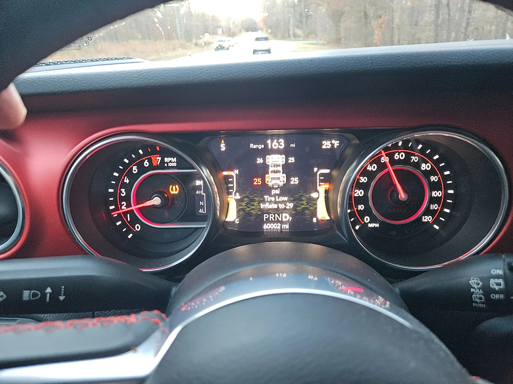

Rolled 60kmiles on the maiden voyage off to work this morning. Officially out of warranty lol. Everything was good.
Not so on the ride home. I was enjoying toasty hot air from the HVAC ducts, then it went cold and i wasnt enjoying anything. As I was processing that, the temp gauge went from halfway to full red. I quickly decided to pull off into the grocery store 1/4 mile ahead. The center display said something like HOT plus some more words i forget. As i scrolled the menu to show coolant temp, i passed thru oil and transmission which looked normal. Coolant temp said -- which i took as no coolant, sensor is in air.
