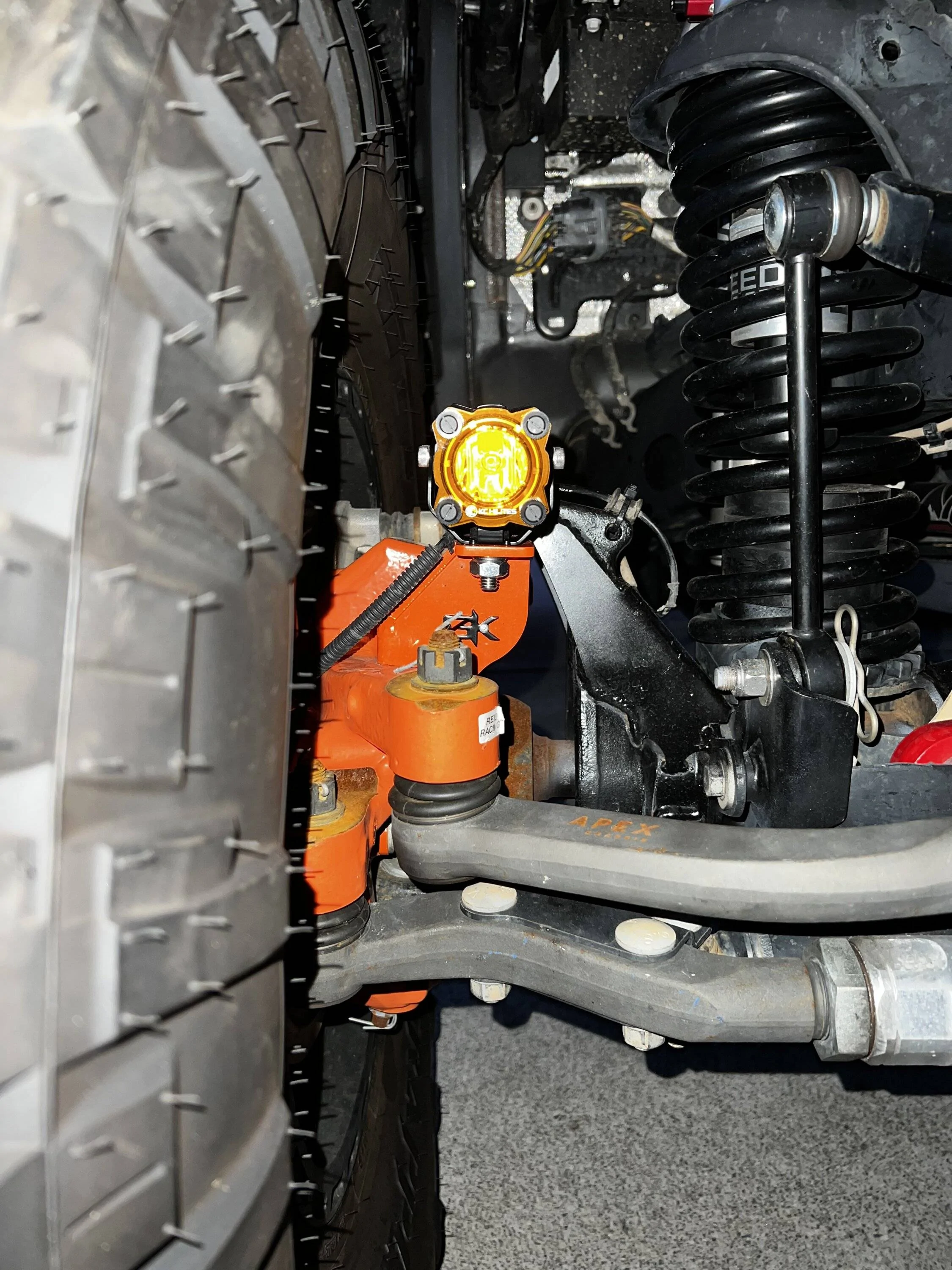

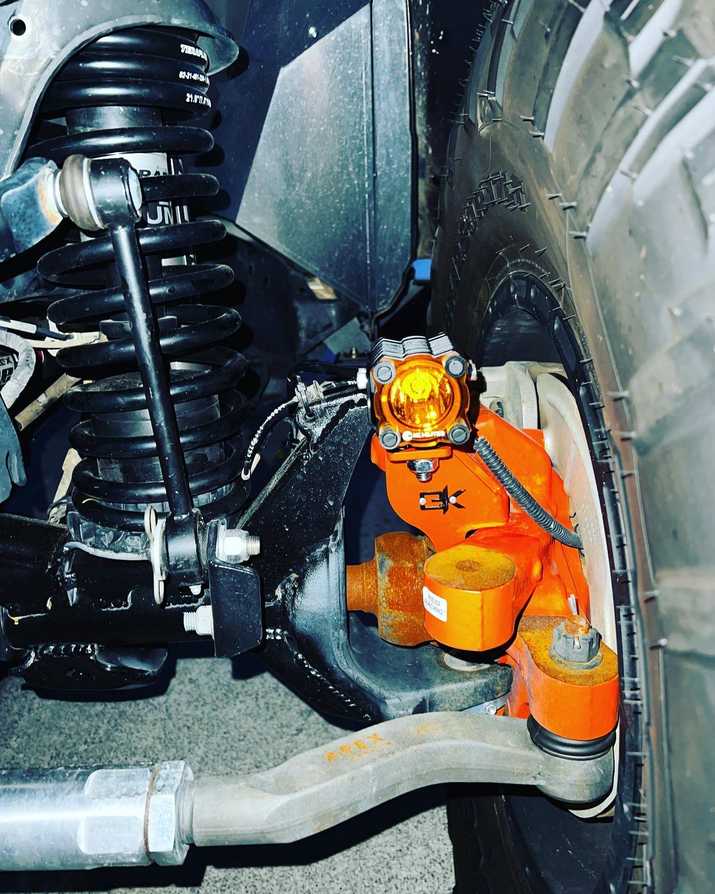

Have had mine for about a year, wheeled it all over the US and in pretty much every condition. Zero issues. I run small KC lights and have not had a single problem with them. Mud, snow, ice, lots of water crossings, "mud pit" that I believe is also the septic system at the park LOL and every day driving. I spray them off and keep on going.
The lighting is perfect for navigating low speed areas. They don't blind my spotter but allow enough light down low to see what is where. They also are fantasic for foggy/dusty conditions for the lead jeep to see me following them (I run amber covers on the lights). You can see them in my profile pic during the day but here's a better shot of them installed. Of all the lights I run, these compliment things nicely.
When you are working on a lighting plan these definitely make sense to consider. I will say running them on bigger tires, the angle you set them for makes a difference as the tire will block the L/R lighting.
Looks really good.
Did you use the extra kc light bracket that gatekeepers sell separately or are those just the brackets that come with the kc light?
Looks like Reid knuckles was there any mods to the knuckles or the light brackets to get them to work together or did they just bolt up?
Thank you.

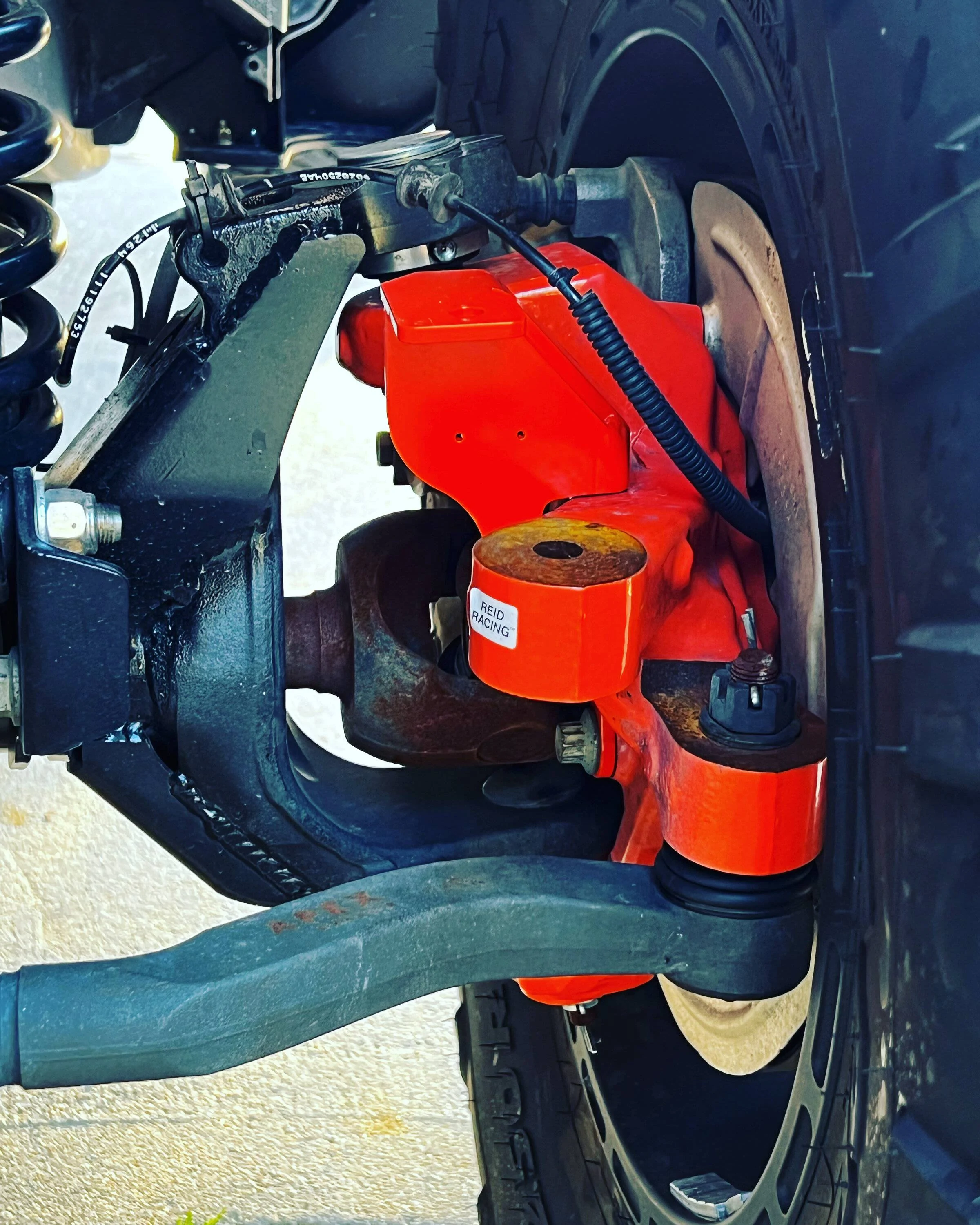

I just bolted them up on the hole from gatekeeper. They are Reid knuckles, no issues bolting them up. Had them powder coated to match so they look pretty "factory" Here's a shot before mounting the lights
Thanks to exactly what I was hoping and looking for.
