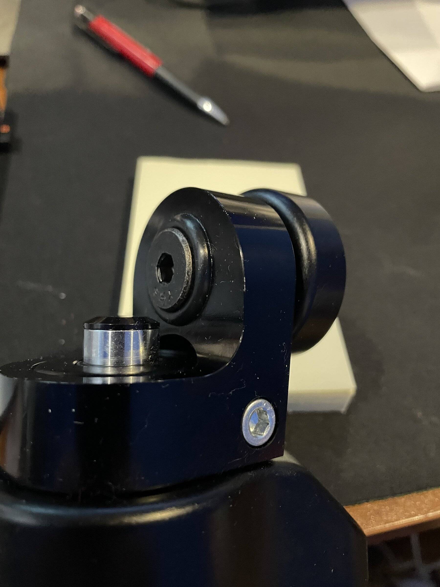

OK, sorry I'm such a dimwit; can you just unscrew the hex bolt, or does that stay and you spin off the plastic part?
The large round disk part attached with the bolt is aluminum. Put that (not the integrated flange) into a pipe wrench or vise and use an impact to remove the allen bolt. Neither the disk or the allen bolt will be needed.
Check my thread here:
https://www.jlwranglerforums.com/fo...eries-2-0-steering-stabilizer-jk-or-jl.91320/
PS...ONLY do this if you are going to relocate the ATS. If you are installing in the stock location, then you need the disk and do not need to remove it.

So, are there any other parts needed you could give me links to, for installation to my 2022 JLUR?

If you’re going with the EC the eyelet is a little narrower, I put some washers on the back side, helps it be nice and straight with the tie rod…….

The Fox ATS comes "configured" to bolt onto a fully stock JL with nothing else needed. If you are not off-roading in your Jeep, you can leave the ATS in the stock location and you have everything you need in the ATS kit for installation.
EDIT: saw you are adding a lift kit. You will want to relocate it then. I used the Synergy bolt and clamp on my Fox ATS installation:
Tie-Rod Clamp (be sure to get the proper OD size for your tie-rod) = https://www.synergymfg.com/synergy-steering-stabilizer-clamp.html
Axle Side Stud = https://www.synergymfg.com/synergy-jeep-jk-jku-jl-jlu-jt-stabilizer-mount-stud.html?category_id=4883
Tie-Rod Clamp Bolt = https://www.synergymfg.com/fox-ts-and-ats-synergy-steering-stabilizer-clamp-adapter.html
You can check out my thread for the install here (with lots of help from @Roky, @Dyolfknip74, and @hoag4147) - https://www.jlwranglerforums.com/fo...eries-2-0-steering-stabilizer-jk-or-jl.91320/
Hi again, one more question.
Would the kit linked below work for my 2022 JLUR/Fox ATS steering stabilizer relocation, if I add just the Synergy 4051-01 bolt to replace the big gold colored bolt?
Synergy Jeep JL / JLU / JT Steering Stabilizer Relocation Kit for OEM Tie Rod End (polyperformance.com)
