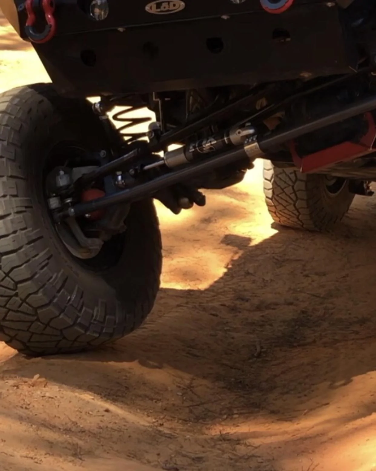

That’s the shock I’m using. Here’s mine..... no drilling for this one. I think that the oem stabilizer is the one that needs drilled , IIRC.
Jeep Wrangler JL Steering Stabilizer Relocation Kit 843B1029-12B4-46D2-9541-24AF20E7F28F

That’s the shock I’m using. Here’s mine..... no drilling for this one.......
Perfect; thank you. I have the Fox stabilizer in the box, so I just need to grab the Synergy mount. Thanks for your help!
