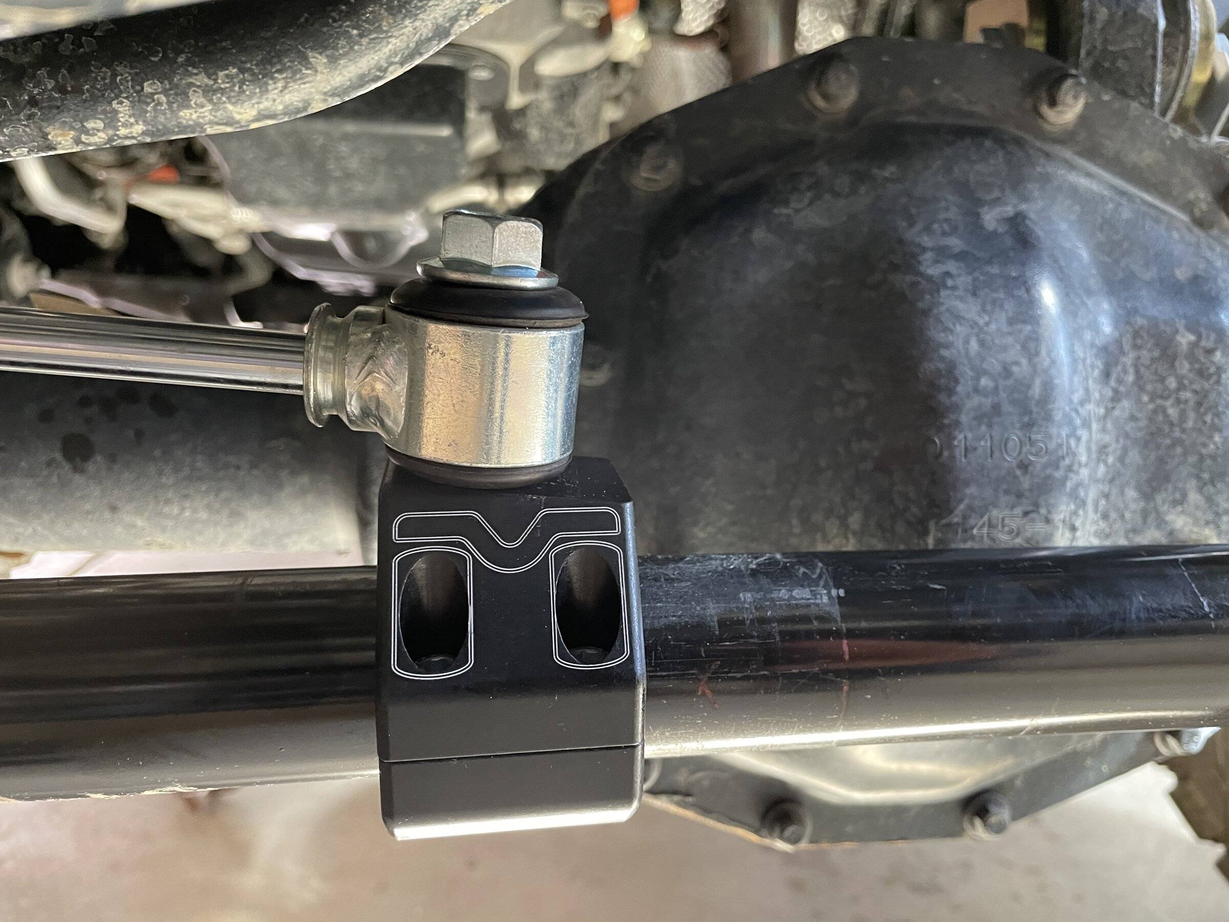

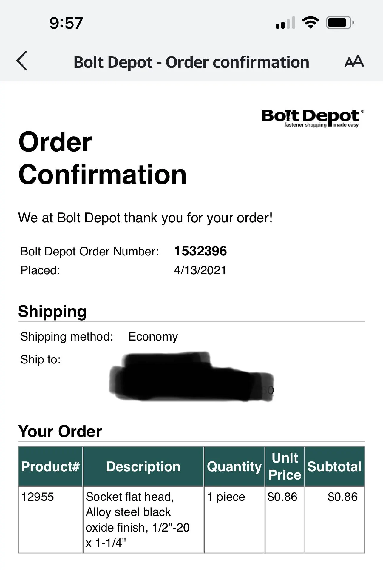

That is very kind of you sir! But looking at Metalcloak's specs I don't think that bolt will work, I did find one on Bolt Depot's site I think will do the trick.
https://www.boltdepot.com/Product-Details.aspx?product=15731
Metalcloack specs:
https://images.metalcloak.com/Metal...er-Billet-Mount-Installation-Instructions.pdf
The only concern I would have looking at specs would be length on bolt. MCs version is mounting through normal shock end. The Fox ATS mounting point is not as wide/thick as normal shock end, but I haven't messed with many of these...

The only concern I would have looking at specs would be length on bolt. MCs version is mounting through normal shock end. The Fox ATS mounting point is not as wide/thick as normal shock end.
I thought the same so I ordered different length bolts just in case, hopefully one of them fits! I'll be sure to post my findings.

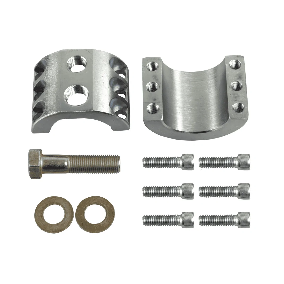

I had my shop grind off the Metal Cloak bracket they welded on and installed the Synergy bolt. I didn't like the angle of the Metal Cloak bracket, it's too high, the Synergy bolt keep the steering stabilizer level.

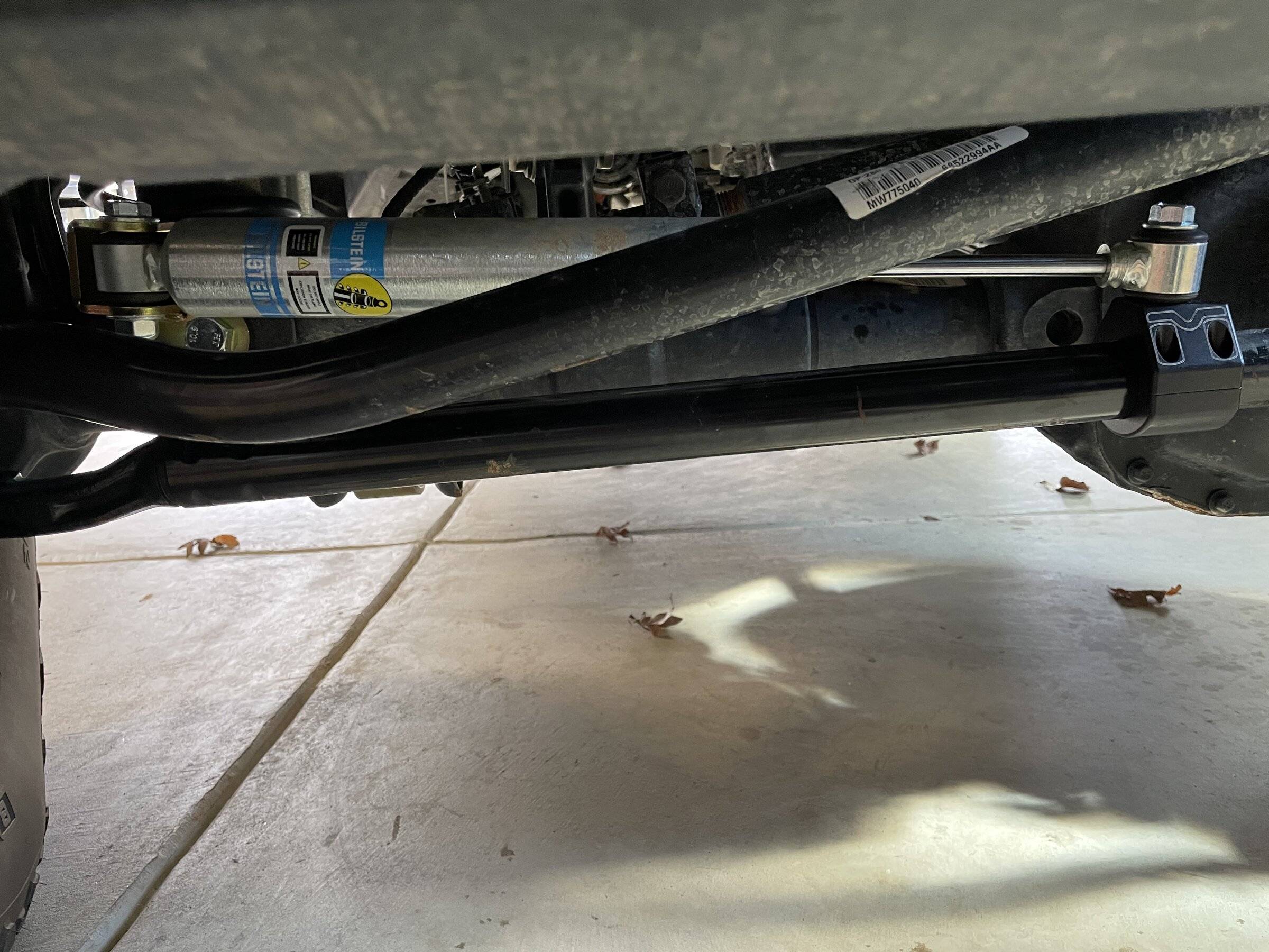

So… I went with the fox bracket and while it’s far from level, the spherical bearing isn’t fixed and allows for plenty of movement up and down when tightened properly. Does anyone have an example of failure due to the Fox joint? I think I’m gonna roll with it otherwise.
