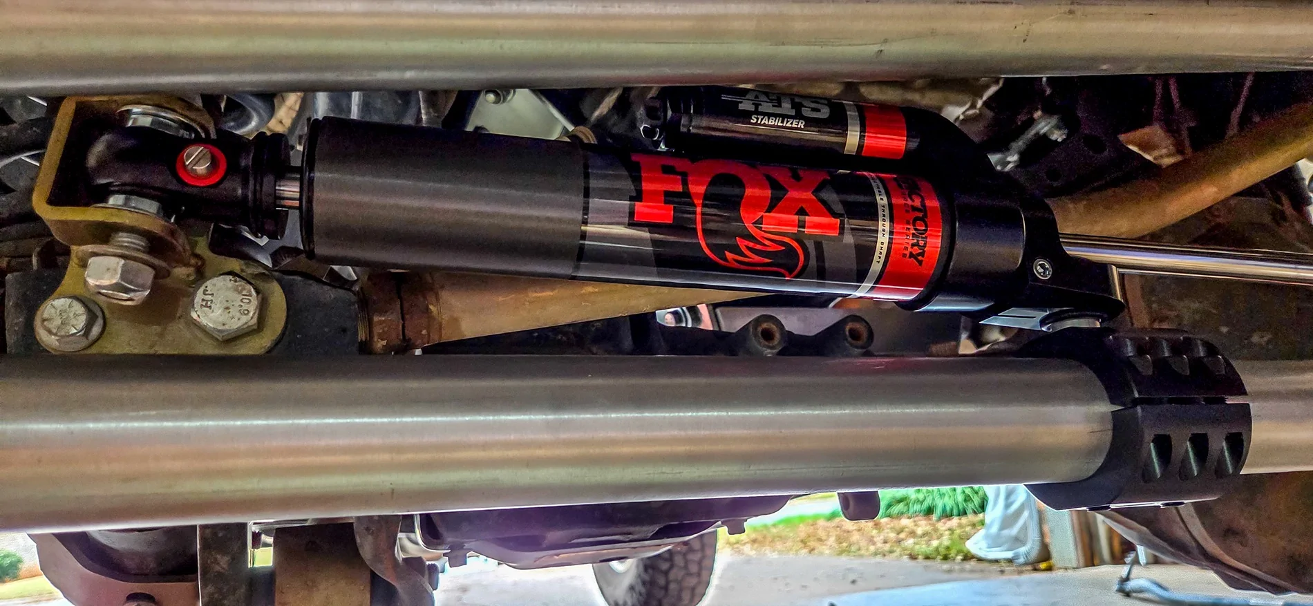

Are there any relocation brackets that work with a Fox or Teraflex thru shaft damper?
I used a Metalcloak relocation bracket and an Apex Chassis 2" clamp to mount my Fox ATS. Works just fine. This is a view of both bracket and clamp with the Jeep at full turn to the passenger side.
(Yes, I know the mounting bolt is loose in this pic. Taken during install.)
Jeep Wrangler JL Steering stabilizer relocation 20251213_102953
