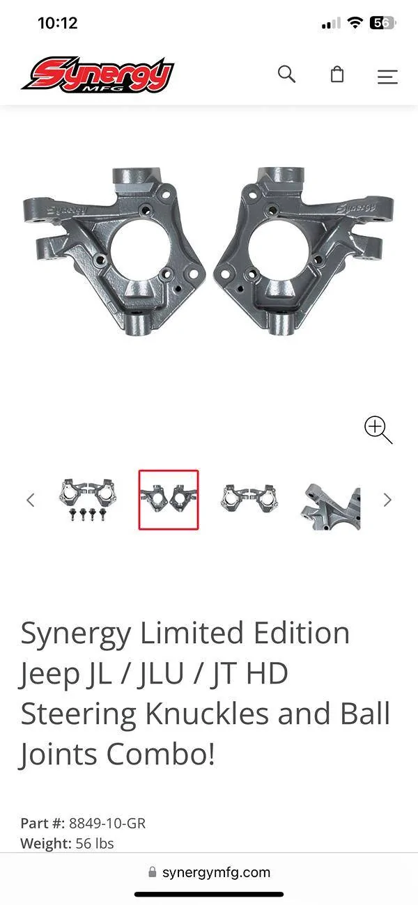

Anyone running Synergy knuckles? I have the Reid knuckles on my (to do list) but looking at these as an alternative.
Jeep Wrangler JL Synergy Steering Knuckles IMG_2483

I have them. Overall good value.
It has pretty thick powder coating, and the caliper bracket hole has small mis-alignment due to the thick coating. Just be very careful when installing it and hand tight the bolts. If not aligned, push it against the coating to align it. Won't take more than one minute of effort. I made a mistake by using a ratchet when I couldn't hand tight, causing the bolt and bracket hold stripped. And bought another bracket/bolt for $100

Thank you for the info.
