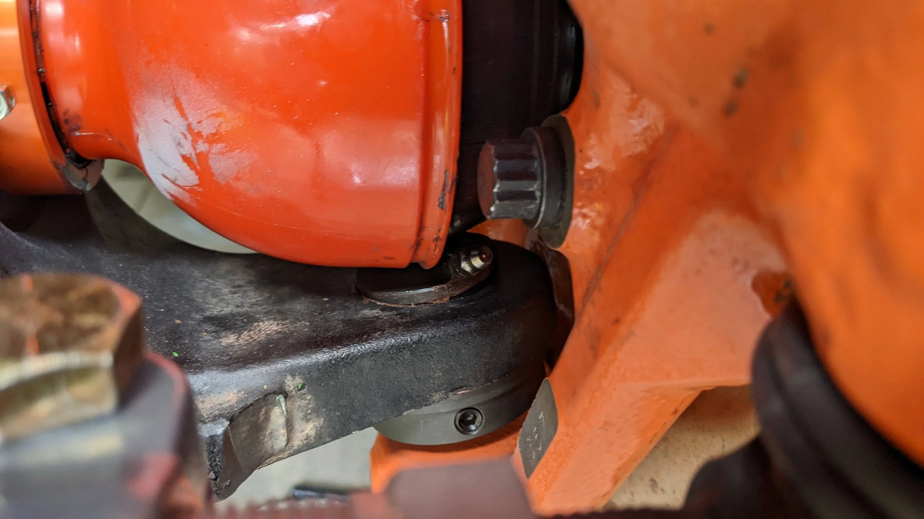

Just got done with Teraflex ball joints, Reid knuckles, and RCV shafts.
Only issue was that the RCV boots rubbed the grease zerks on the ball joints. You have to install them rotated 180° from the Teraflex instructions. They're close but they clear. Along with the Artec truss, this axle is pretty well set. I also did a Synergy tie rod and drag link, along with the sector shaft brace.

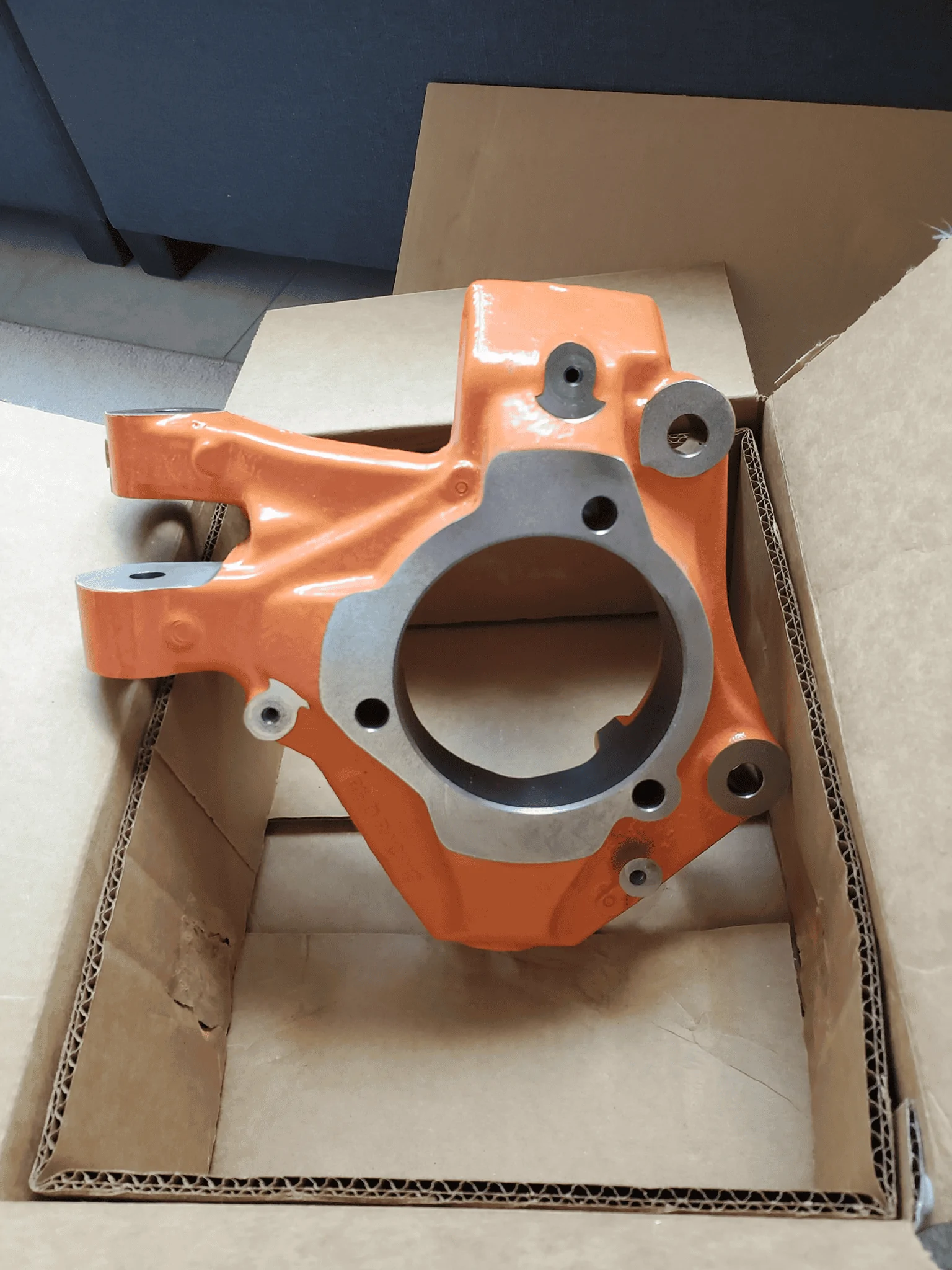

I just saw this message as I was out of town. I appreciate the offer! I just got a call from Poly Performance this week and it turns out they sent me two left hand knuckles. I did not pay attention to the part numbers when they arrived, but looking at them now sure enough I got two left hand knuckles. Apparently another guy got two right hand knuckles according to the customer service rep. Thankfully I wasn't in the middle of installing these and realizing the mess up then. I got a good laugh out of it overall. Sometimes in life all you can do is laugh at a situation.

So after two months and 10 days Poly Performance FINALLY got me the correct passenger side knuckle. I went from finding the situation comical to being beyond frustrated. I could not get any of their reps to call me back with an update as to what was happening and the replacement they finally sent me was a used previously installed part. Ended up sending that back and waiting another month for a new replacement. Last time I ever order from them. Their customer service is atrocious.
On a positive note, ill be installing these soon. The quality of the knuckles is something else. For those who have done these there seems to be some toe differences before and after the install? Is this common? I would have assumed there wouldn't be any difference but figured I would ask as I saw it mentioned a few times. I have my Steer Smarts tie rod that I need to install still so if there is a difference ill just do the tie rod and be done with it. My Jeep tracks straight and true at 80 down the highway as it sits so anything im doing is going to make it that much better.

I would check toe before and after just to be safe……. Anything is possible…
That's what I was thinking too. I have the toe measurement plates so it's easy enough to do.

The tolerances of the location of the tierod holes, balljoint holes etc., all are magnified many times over by the geometry. A small difference in location of one or more of these holes will result in a much larger difference with your OEM knuckle toe setting.
So, yes. Check that toe-in setting after installing a set of knuckles.
