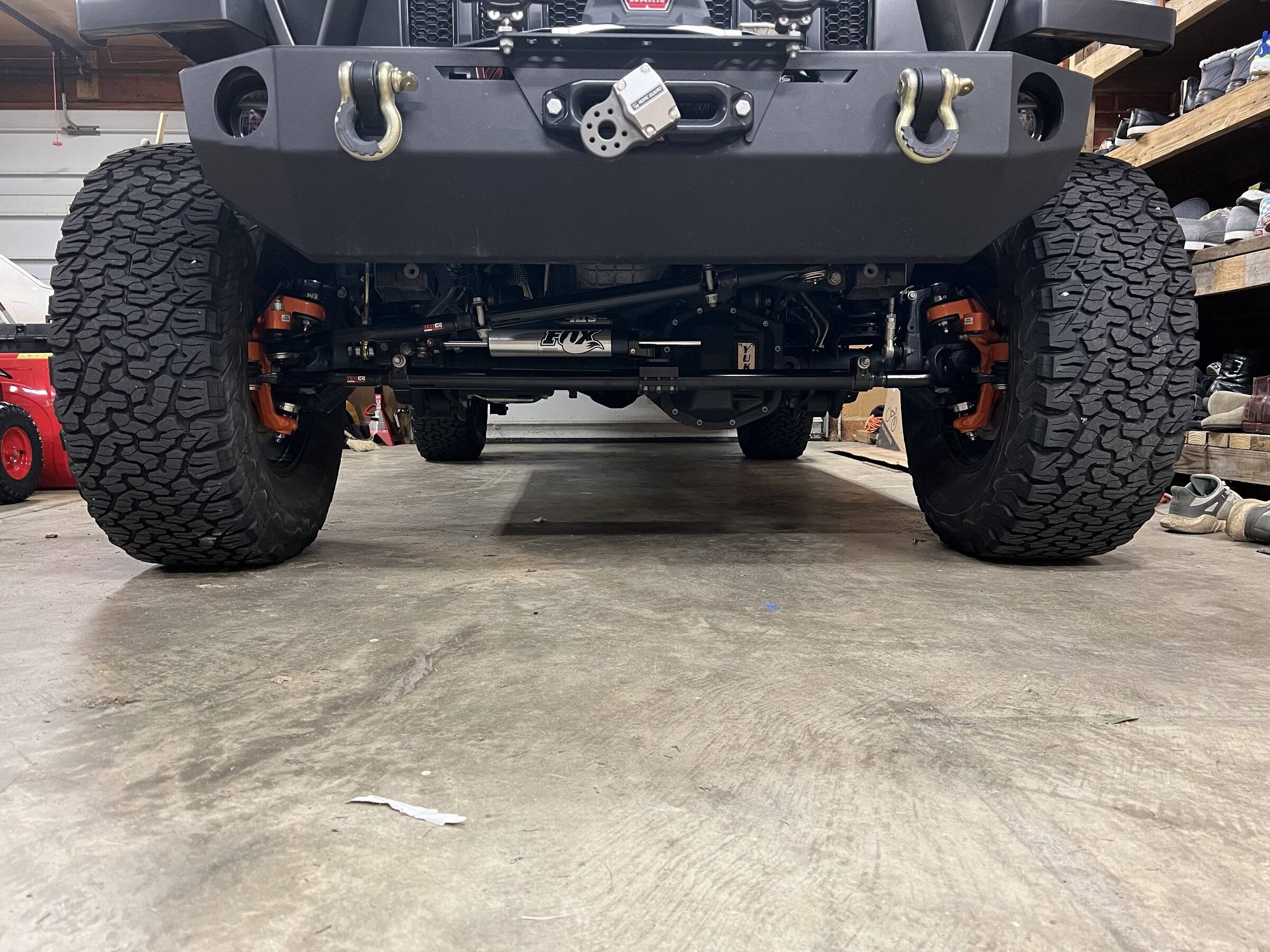

I'm of a similar mindset, so I opted to install the outer seals.
Jeep Wrangler JL Reid Racing Steering knuckles 20211013_132548

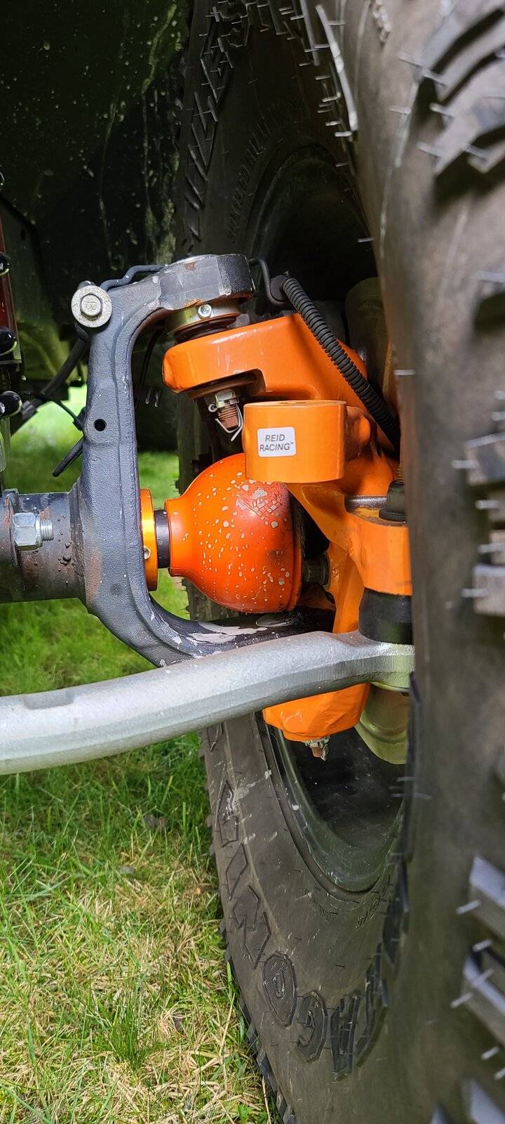

Jeep Wrangler JL Reid Racing Steering knuckles E1EF406E-780D-4750-9267-7AF1448FC6C1
Jeep Wrangler JL Reid Racing Steering knuckles 7F1A3134-C2A9-4C3E-8210-1CC6BA7492D8
#314/322 checking in. This thread was incredibly helpful and hilarious. Couldn’t have done install w/o it. Made a terrible mistake though and pressed in ball joints in the wrong order. Other than that instal went smoothly.

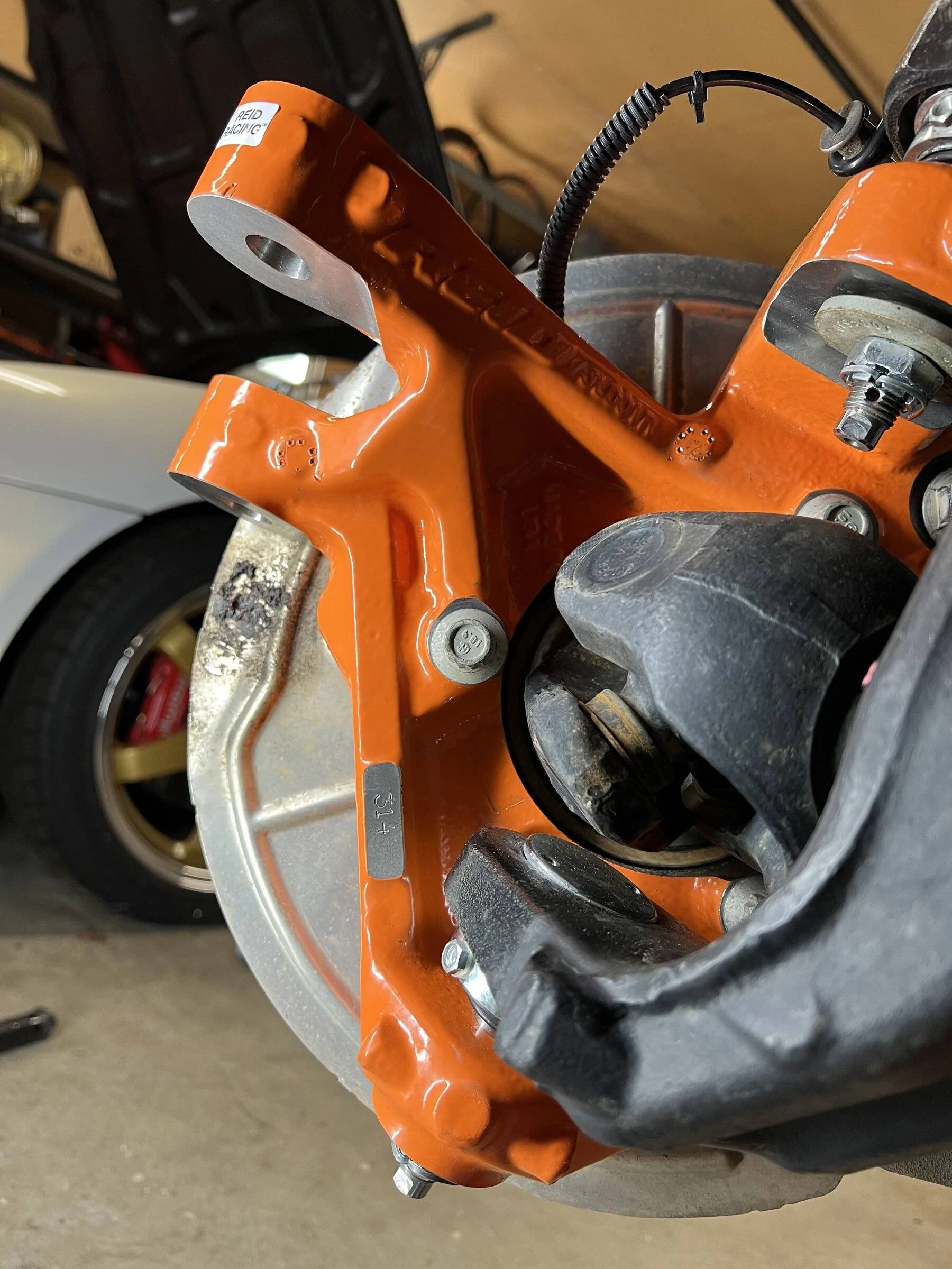

One thing about the Reid knuckles is that you need to grind the cast steering stop to facilitate full factory steering movement/turning radius.
I used my 4" DeWalt angle grinder with a composite abrasive hard disc (radiac wheel to you other old guys). It took about 3/16" of removal to get it to the OEM turn angle.
To measure the OEM turning angle, be sure to measure it with the OEM knuckle installed. I removed the brake caliper, disconnected the tierod from the OEM knuckle, rotated the knuckle against its stop, and used a straight edge (I used angle aluminum) to lay across the brake disc and mark the frame with chalk. This became the reference point for grinding the Reid knuckle. It was quite a lot of difference of turning angle to adjust (by grinding the stop). This picture shows when I was getting closer with the grinding. It started out about 3 or 4 inches away from my reference mark.
Jeep Wrangler JL Reid Racing Steering knuckles 20220403_164020
Roky
Roky
Oct 4, 2018
10,715
29,487
Just when I thought my ocd was the worst ever……..:LOL: …… my Reid stops were less than a 1/4” longer so I left them alone, shhhhhh…..:bandit:
