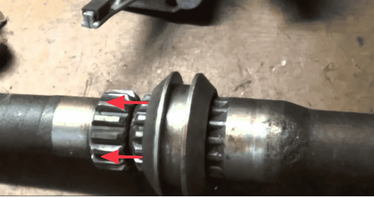

So you want the FAD to be *engaged* before you pull/reinsert the passenger axle-shaft? What happens when it doesn't line up? The shaft doesn't go in all the way or it does but the FAD gets messed up?
So basically, when the FAD is not engaged, the collar sits exclusively on the passenger-side axle shaft. So when you pull it out, theres nothing keeping the collar in position, it'll retract a bit into the housing, requiring you to open the FAD to orient it back into position.
When you have the FAD engaged, its positioned onto both the passenger side axle shaft and the portion that goes from the pumpkin to the fad - at the same time. You remove the passenger side axle shaft and it stays lined up because it's still half way on the other shaft.
This is a photo of what it looks like when it's disengaged, imagine the collar moving the direction of the arrows when it engages, and "joining" the two axle shaft sections
Jeep Wrangler JL Reid Racing Steering knuckles 1632803064947
That make sense?
That make sense?
Thank you so much. This is an awesome explanation and totally makes sense.
Very helpful, even if I decide not to do it myself, I'll tell the shop to put in 4HI. But knowing that I can avoid opening the FAD is huge if I do it on my own.
