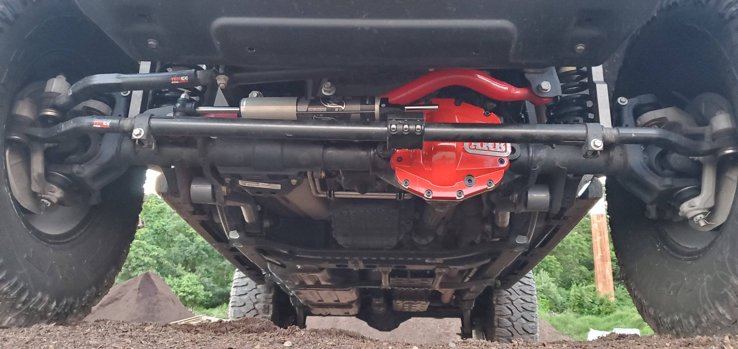

I've been very pleased with the RPM Performance linkages and tie rod clamp. I prefer the 2" aluminum bars over the 1.75" used by fusion. Also, RPM utilizes serrated Bellville washers between the jam nuts and bars.
A couple of recent pics. 1st was during some prep for a road trip to Tennessee. 2nd was taken in Windrock.

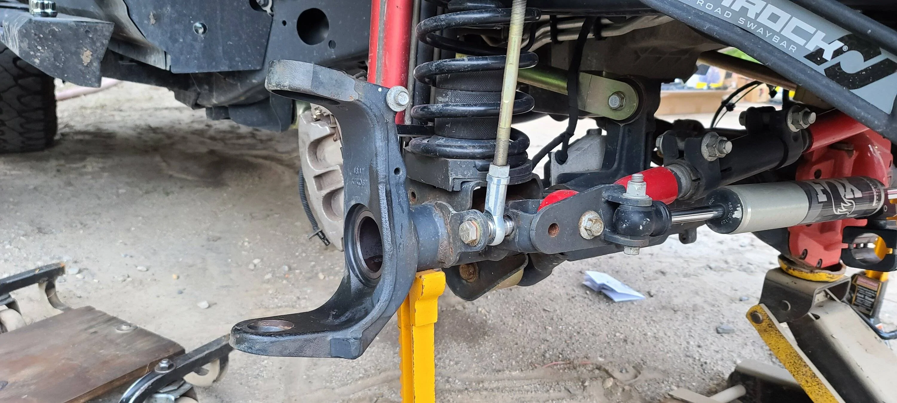

For the axle side stabilizer mount, I'm using the SteerSmarts double sheer bracket.

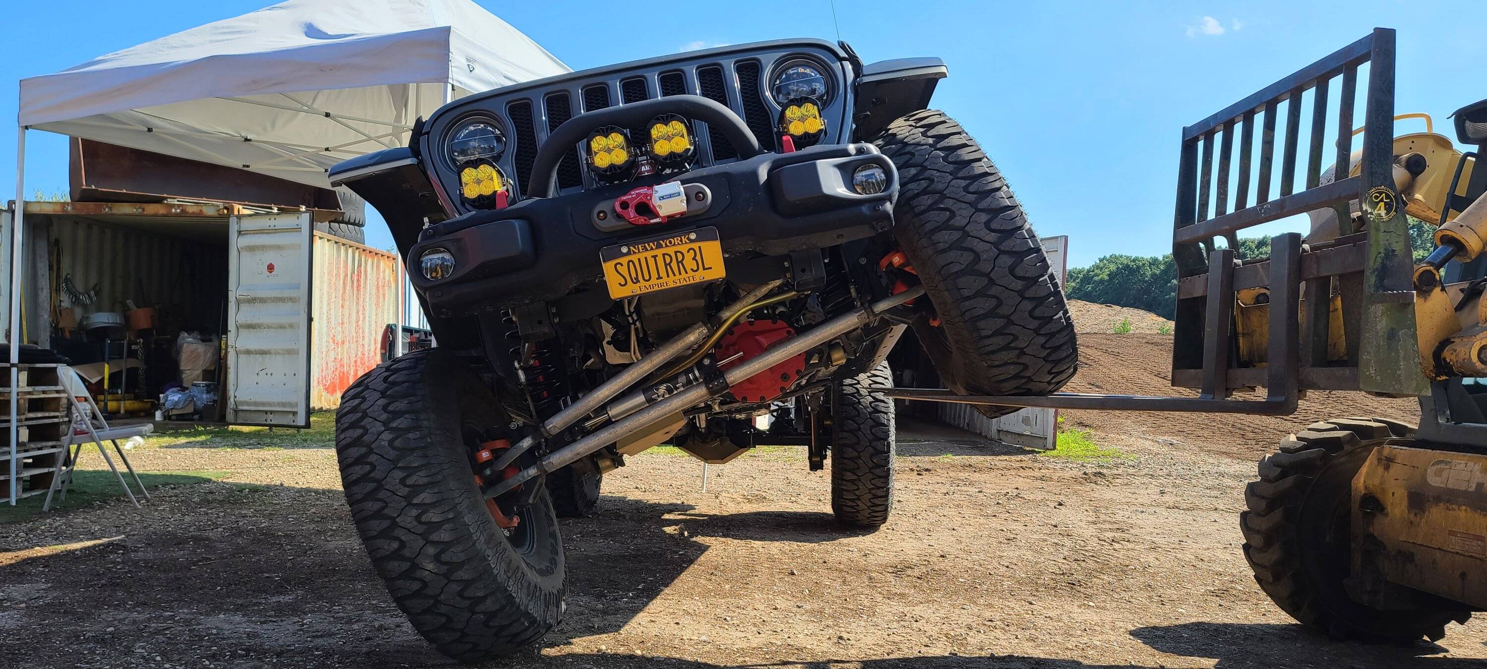

Actually, I used to have the 2" Dynatrac Endurosport lift that I completed with synergy control arms and rear track bar and SteerSmarts front end. All of that was pulled out when I went to the full Metalcloak Gamechanger.
SteerSmarts are great parts, but the front track bar was hitting the ARB diff cover whenever the front end compressed. I did a further upgrade from the SteerSmarts steering linkages to the stronger RPM aluminum setup because I was overhauling the front axle and figured why not. That pic you quoted was taken during that overhaul. This is the pile of parts that went on that day, followed by before and after shots...
