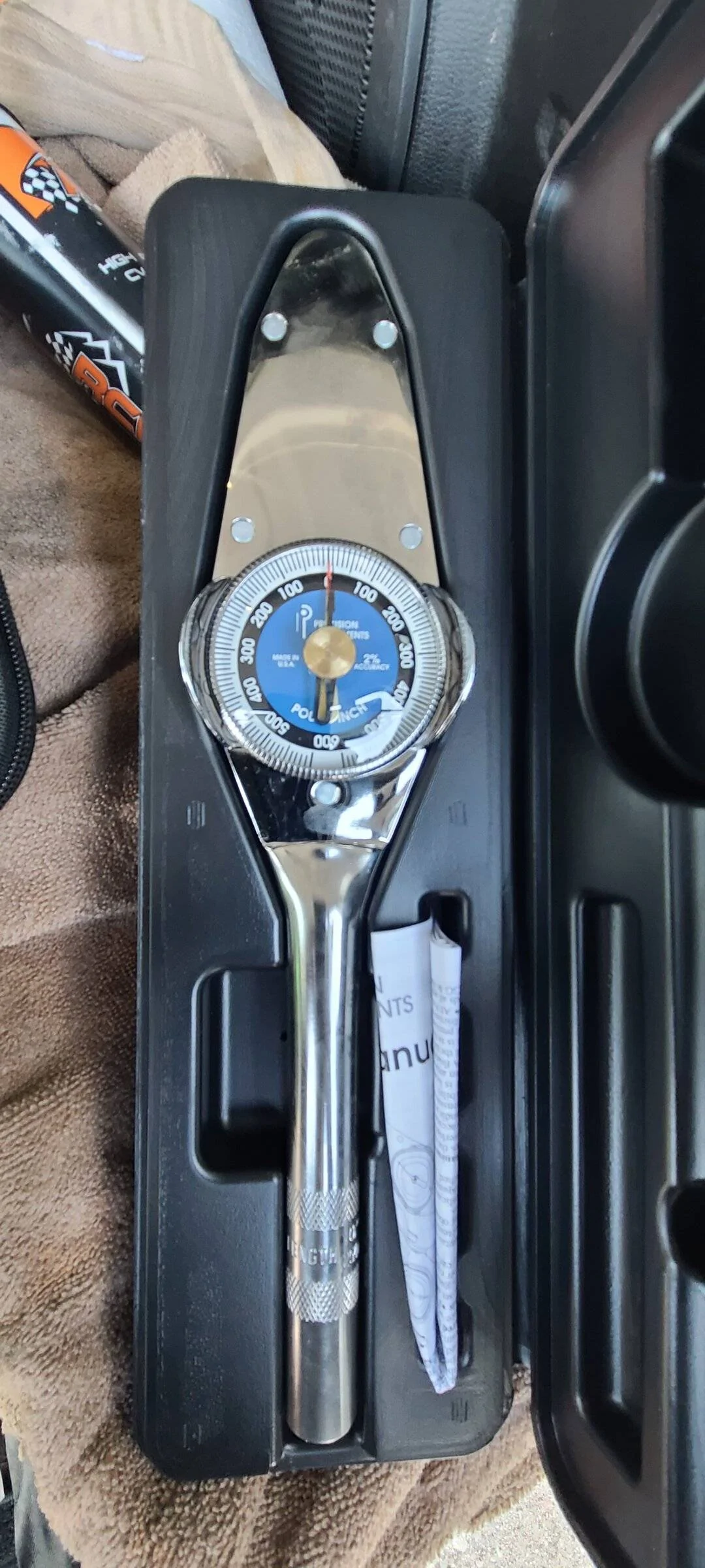

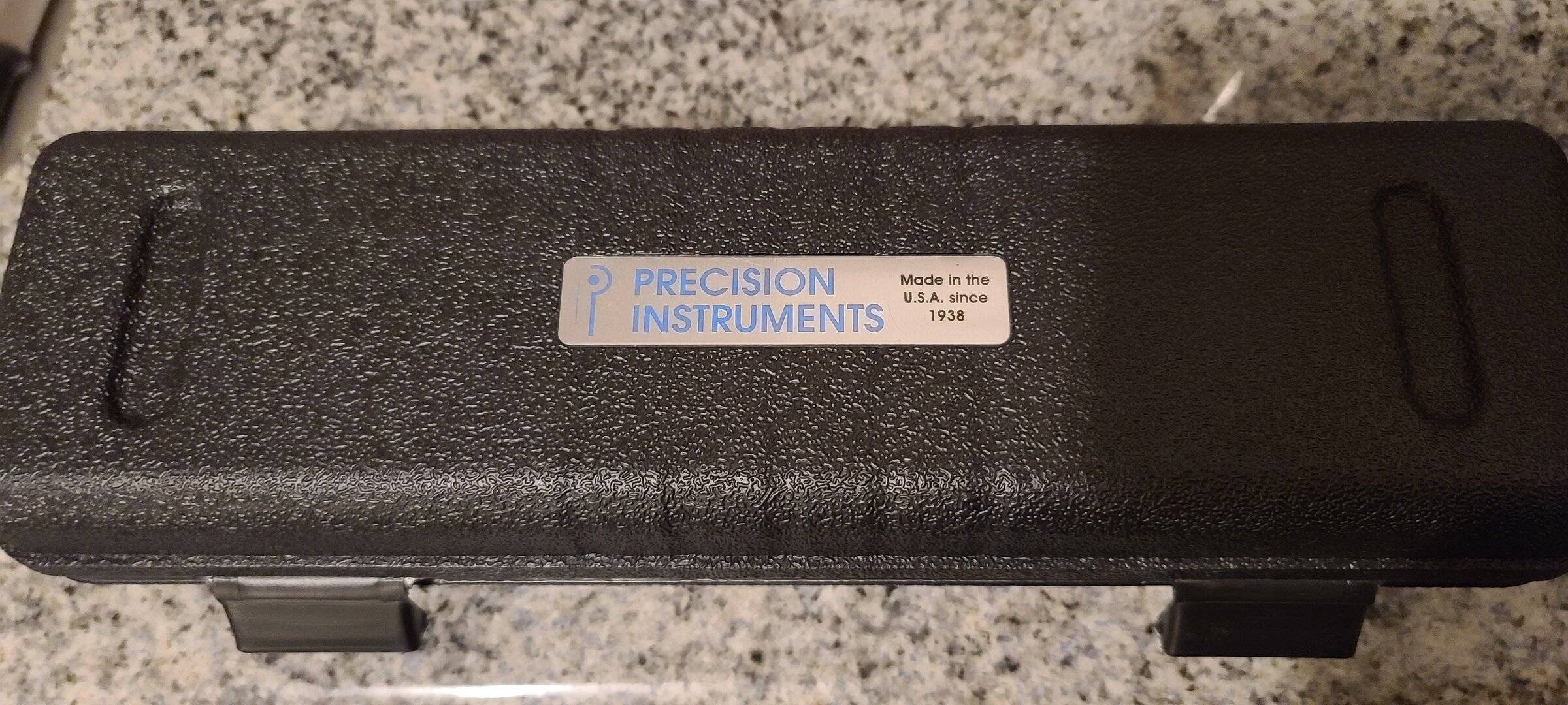

Here's the in/lb 3/8" drive beam style torque wrench with recording dial that I recently purchased for this install...

That seems like a much better strategy. The only issue I have is that with the ultra tight tolerance on that pinion bearing, 5in/lbs could easily put you above the spec. The roller bearings in the m220 axle is extremely sensitive to torque. You won’t hear it scream for thousands of miles. I’m sure you’re fine, but having done my own gears AND replaces that tail bearing due to being a hair over the spec, it make’s me nervous. The only benefit is now I can drop my carrier in about 30 minutes?
According to the JE Reel instructions, which again are the most complete and detailed I've seen with Jeep parts so far, the extra 5in/lbs is meant to ensure that the crush sleeve and bearing isn't under torqued. That can be as bad as over torqued. Also, on what's supposed to be a one time yoke swap/upgrade on a vehicle with some mileage racked up, it's safe to assume that the bearing preload was already starting to relax and that extra touch helps bring it back into spec range.
I fully agree with you in that it won't be proven one way or the other until some real miles get added. I just came across so much inconsistent and/or incomplete methods, such as tightening it until it doesn't wiggle, which doesn't give me a warm and cozy feel. So I thought I'd share what I felt was a great method, along with my immediate results of less drag on acceleration due to a vibrating oem cv shaft on a Rubicon sitting 4" over stock height. Hopefully it can help the next person who finds the same confusion as myself and others seem to have found on both YouTube and Google searches that kept bringing me to relayed threads on this forum. And of course, if I start to develop some issues I will certainly spread the word here on this very thread, so that next person has the full story. Same goes for when, knock on wood, everything stays solid with it. It will be at least a year or so before my 44's get swapped out for a larger set.
