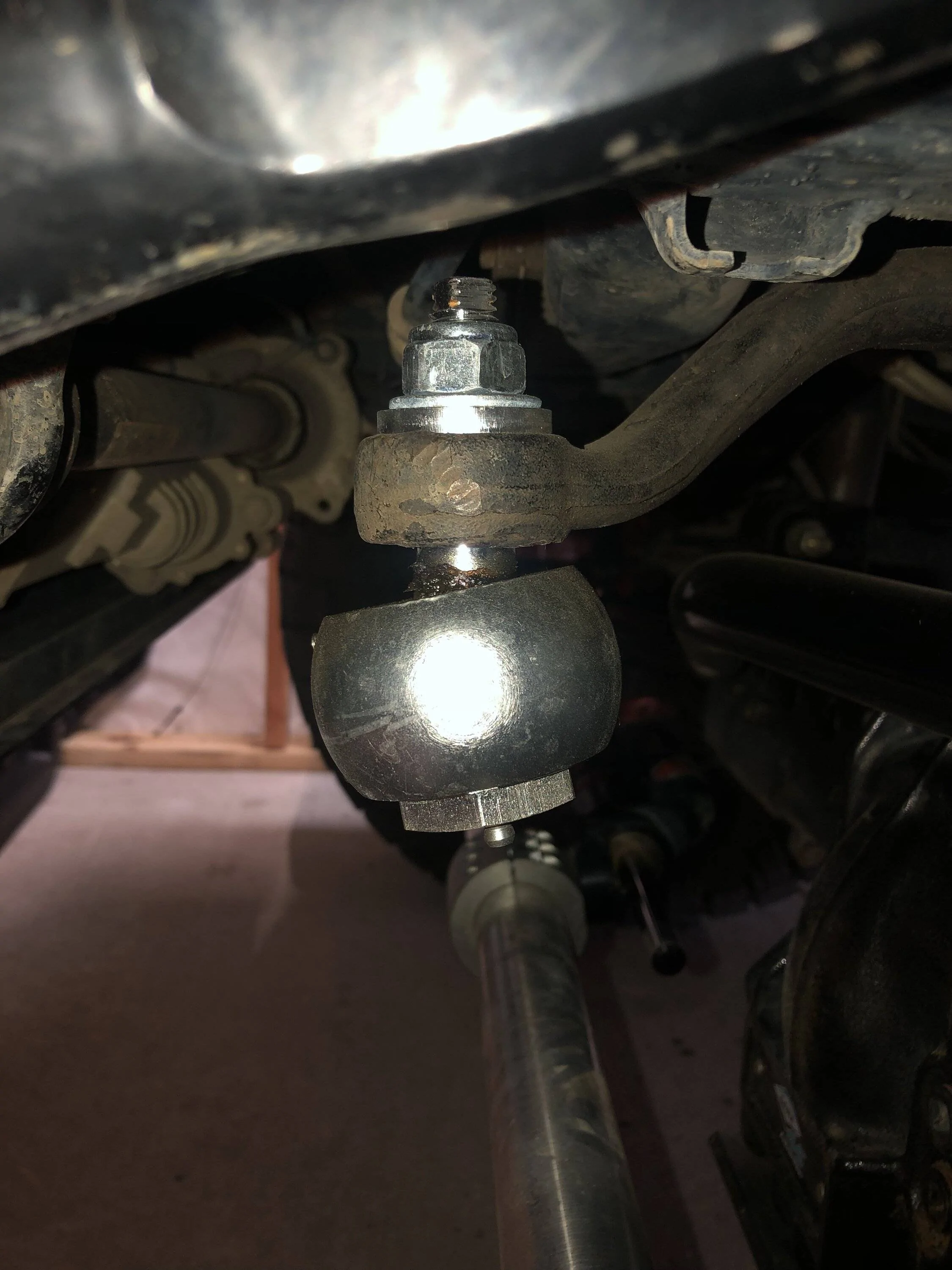

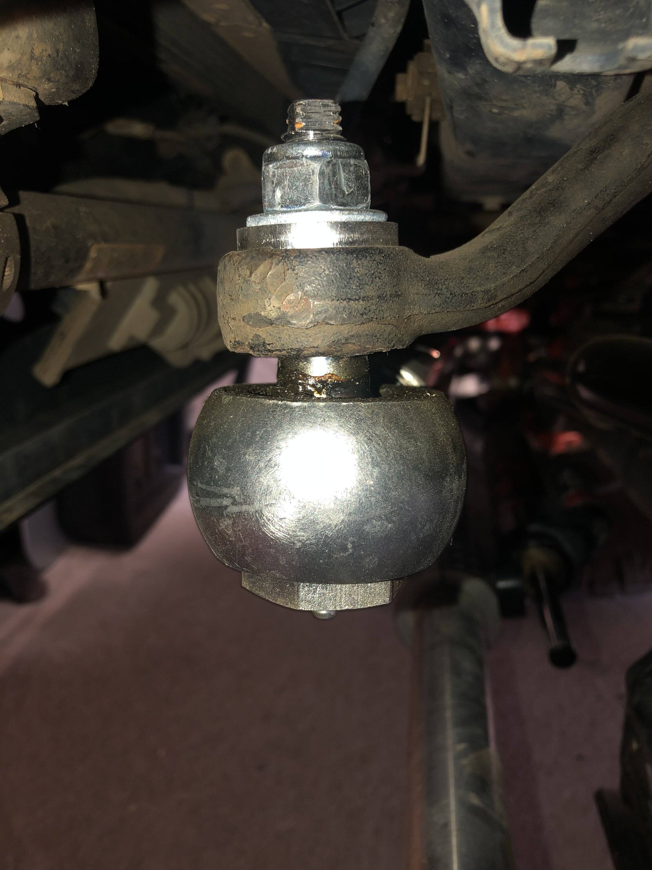

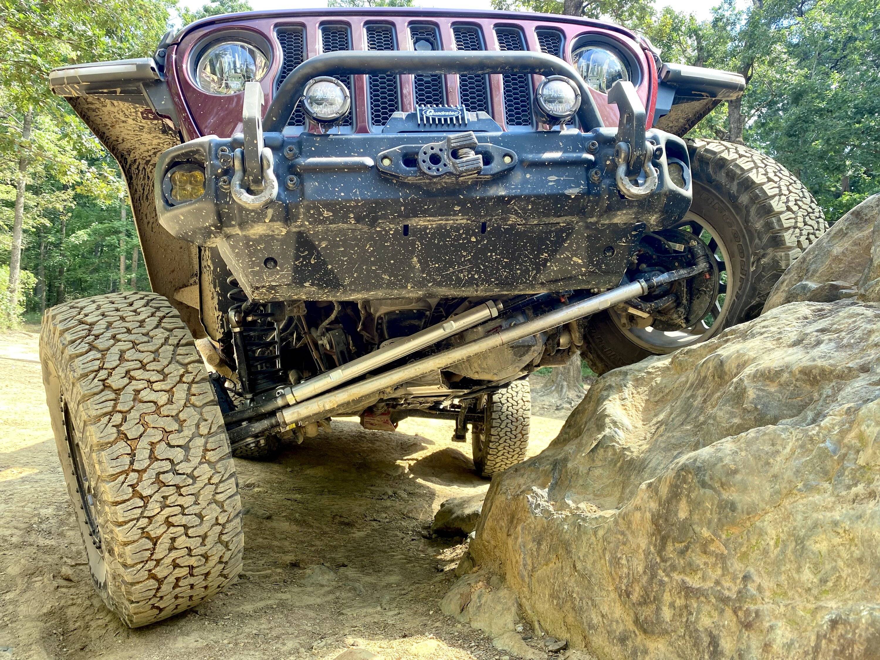

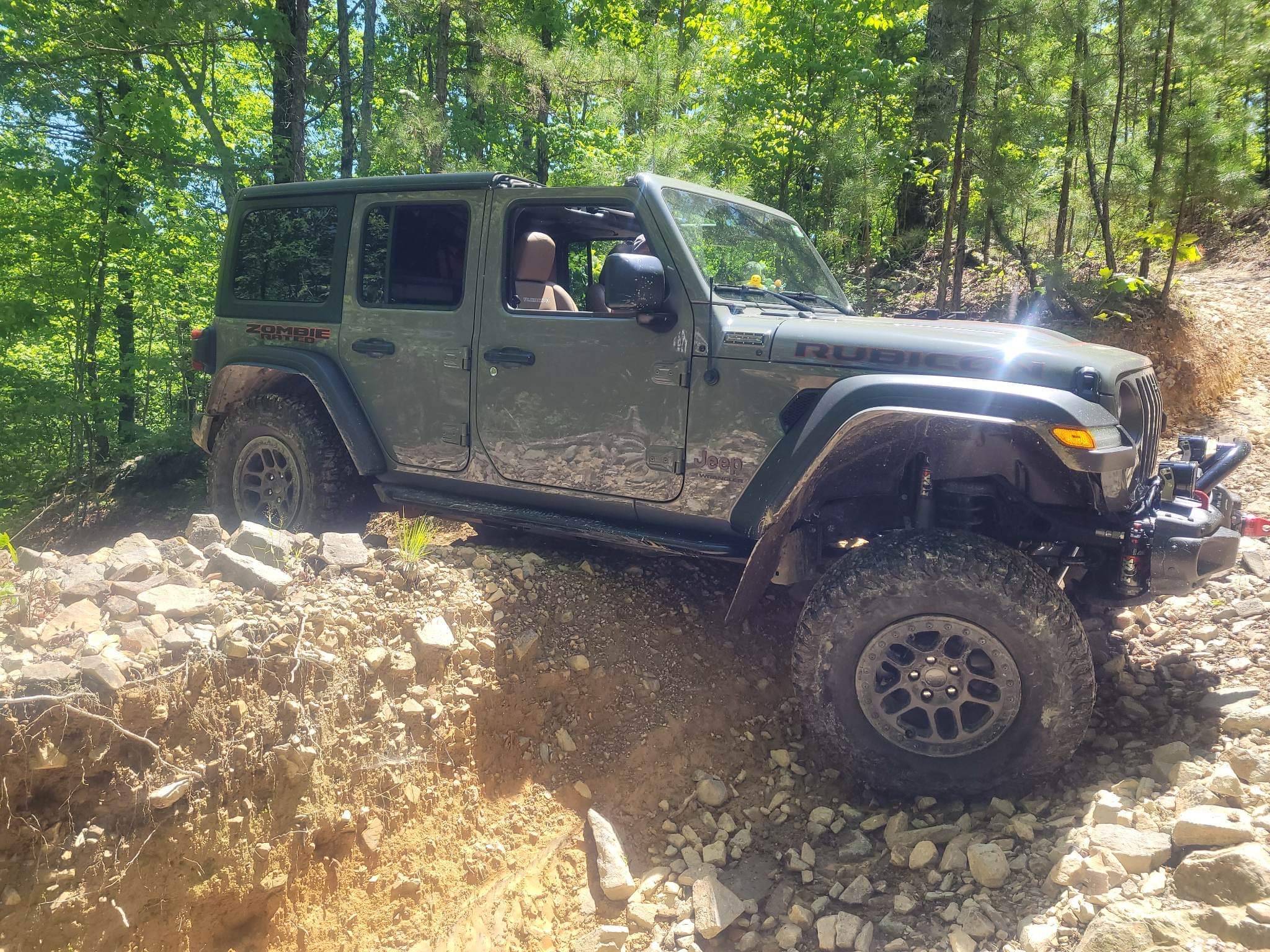

I wheeled the new steering setup pretty hard on Fun Run and Rubicon Ridge badge trails this weekend. Zero interference issues now. Way more positive. Ran great!

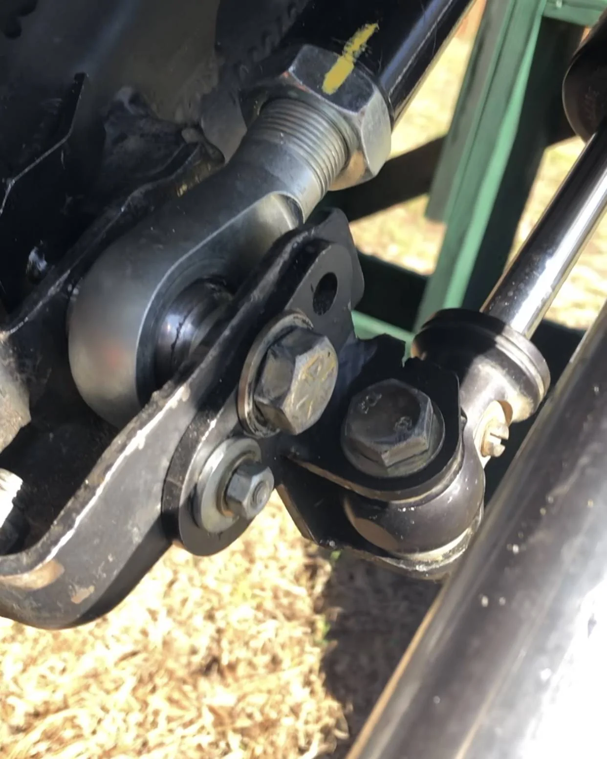

Apex ends will work on fusion tie rod……pic from another forum member……

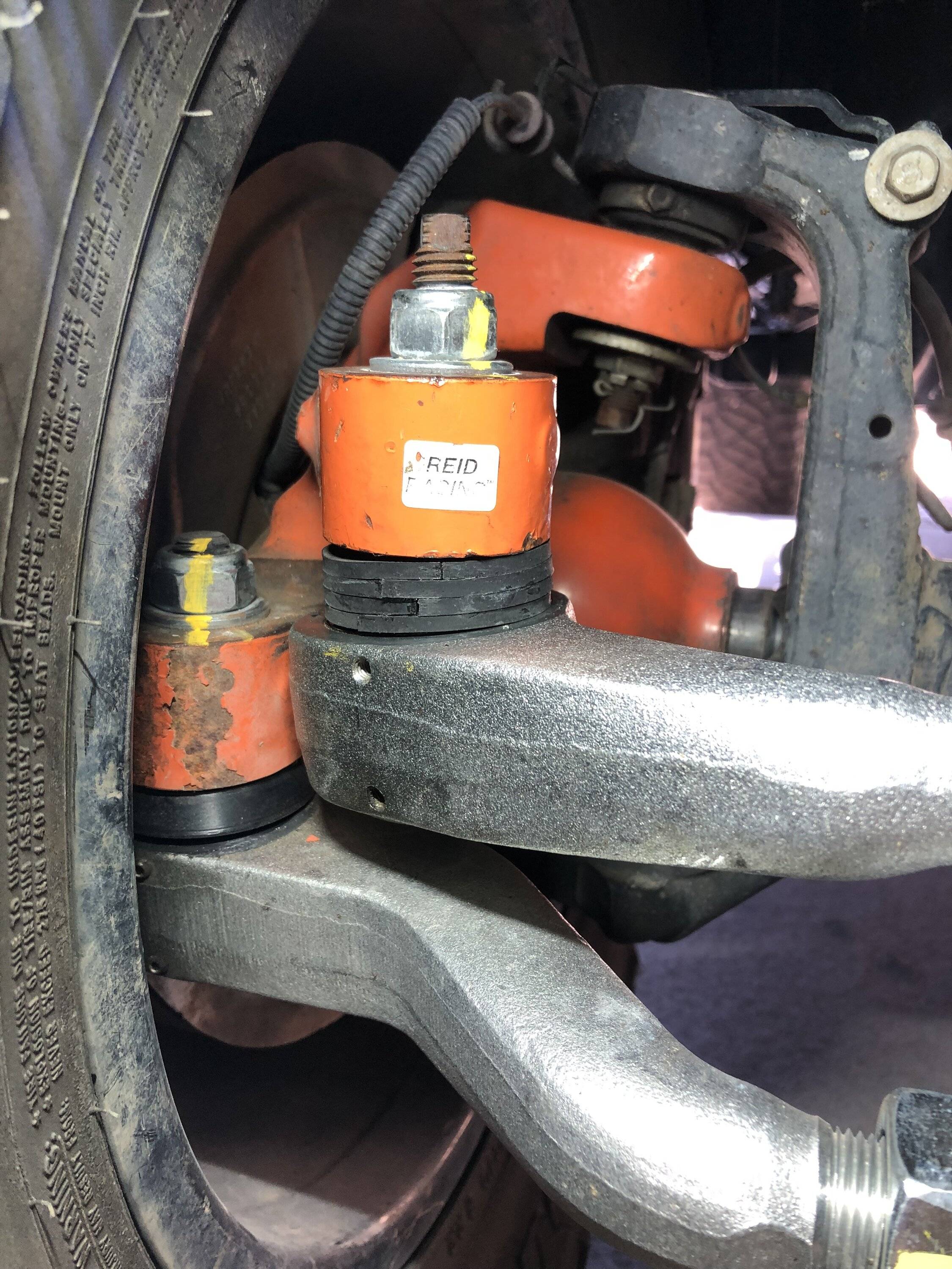

I’m running RK Pro X aluminum steering, it’s awesome, but I’ve been working my ass off to make them work like I want them to, lol…First I wanted to run my ss on the tie rod like we do but the drag link was hitting stabilizer before getting to full lock driver…. I finally figured out how to make it work with a modified upside down MC bracket…..
Jeep Wrangler JL Fusion 4x4 Steering Clearance Issues 0CE8AF69-C284-4783-918D-DBF5C885882F
So got that sorted out then I noticed I was driving around with drag link flopped over….
Jeep Wrangler JL Fusion 4x4 Steering Clearance Issues B398E992-A03A-4349-B87F-E9AC7615CA1C
According to RK this is acceptable, there’s a built in anti flop washer but they put a 15 -/+ degree of misalignment built in for long travel articulation…….
I put (4) 1/8” rubber washers on the knuckle end……..
Jeep Wrangler JL Fusion 4x4 Steering Clearance Issues 0335D9FD-4704-47C1-93E7-539C8C2FA214
and now I’m rolling like this……
Jeep Wrangler JL Fusion 4x4 Steering Clearance Issues 447BBFC5-72F8-41CF-80B2-17328EB49788
But now I wouldn’t trade it for any of them, lol…love the longer bars and compact ends….anyway, I’m pretty sure they will work on ud 60s, Jeremy is running it with fusion one tons.
