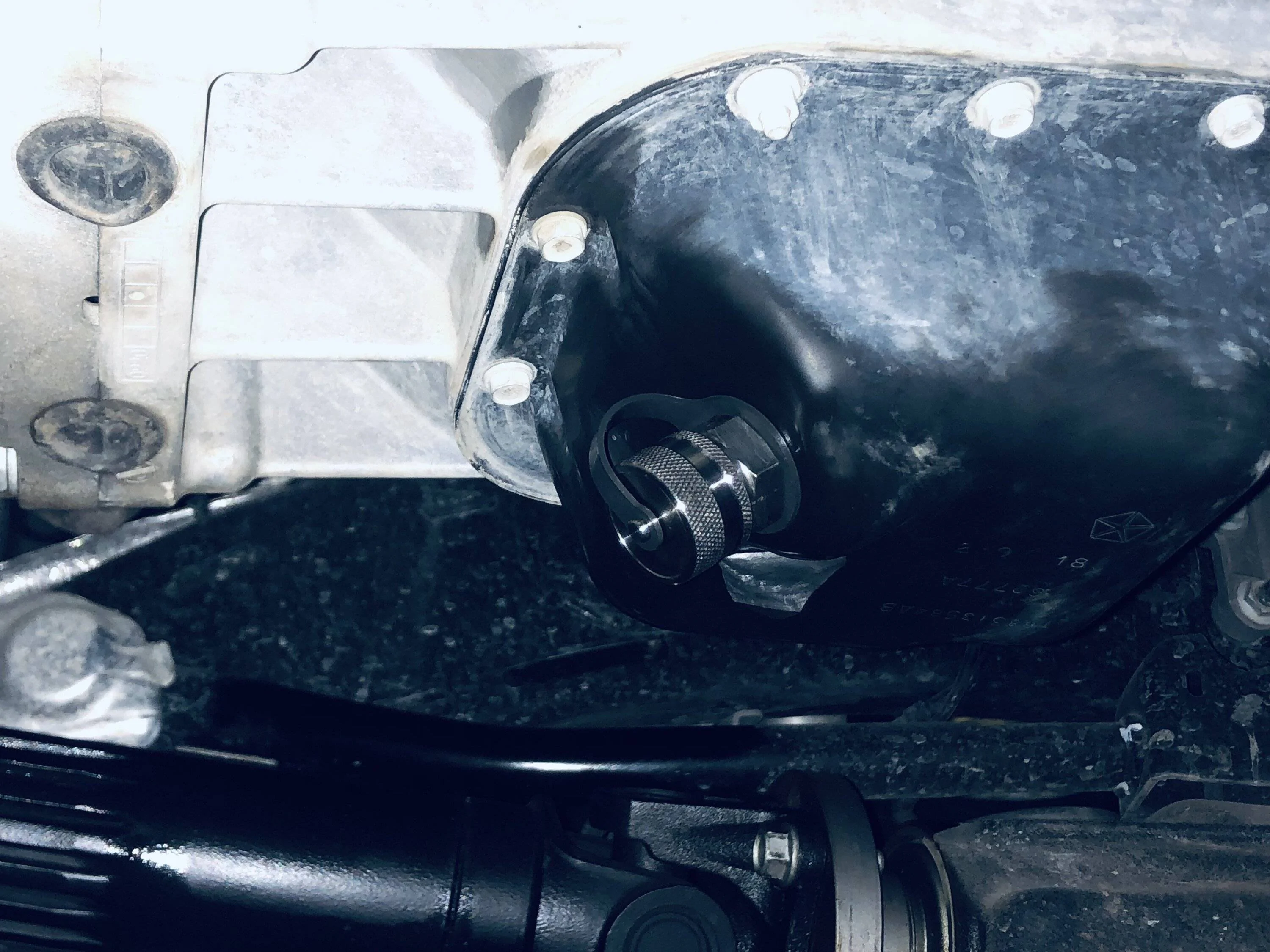

Sorry I know this thread is about the Fumoto, but since some are interjecting about others, just wanted to make my observation/input on the Stahlbus.
I have it installed and was able to use it for the first time this past oil change. First impression, what a breeze, clean and as advertised (as I thought). Then I closed it up and added my 5 qts oil thinking everything was fully drained. When I poured the drained oil into the emptied new oil container, it did not fill back to 5 qts. It looked like about 1 more qt could go into the container. As another forum member mentioned in the post I stated about this, he stated that it will not drain all the oil.
SO on my next oil change, I will use the Stahlbus again and then when all the oil seems to have been drained, I will unscrew out the Stahlbus to see if that remaining qt drains or see if I am burning oil.
If the case is more oil comes out, I will move to the Fumoto as I unfortunately won’t be doing any wheeling any time soon.
? Disappointing. But looking at the geometry of the pan-plug, it looks like any protrusion into the pan, by the quick drain, creates a certain amount of undrainable oil.
I had a stahlbus and saw this exact same thing, at first I thought I was burning oil too, I might have even posted about it. Swapped back to the regular drain plug and all is good. This looks like it's the story with all of these valves that are threaded in, 1/2" or so of thread into the pan will hold back an awful lot of oil.
I didnt even think about it holding back oil too. So I will def stick with the old fashion way of just pulling the bolt. Thank you everyone for your responses and enlightenment.

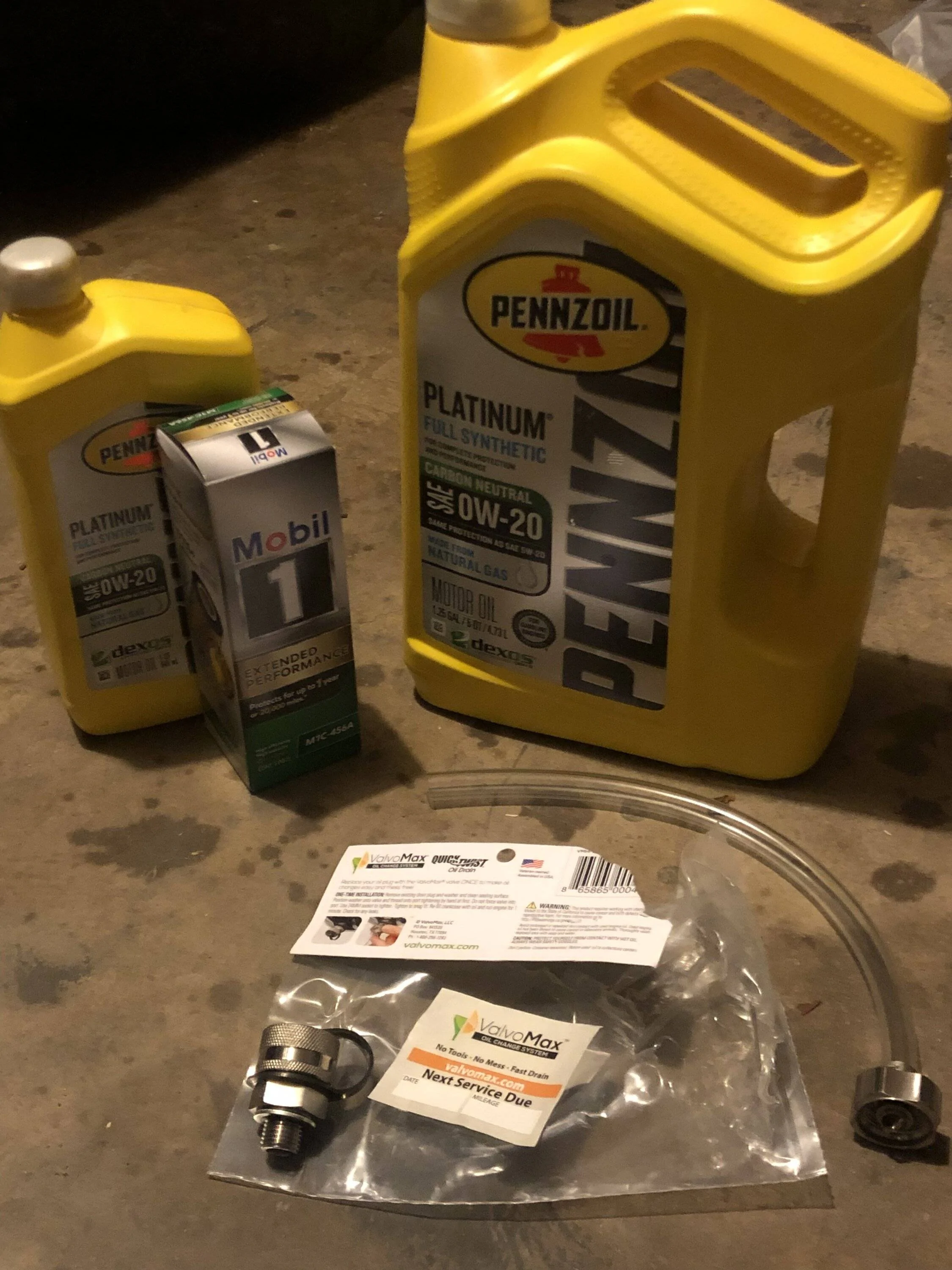

Precisely why I selected the Fumoto valve over the multi-piece ValvoMax "system". I don't want to faff about with compulsory, extraneous crap. I just want to drain the oil.
Well, to be fair, there are a bunch of tools I need to do one thing on the jeep. Torx for HT, wheel lug lock, spacers for my jack to lift the thing, specific tool for removing plate from spare, Allen keys for diff covers and so on. It's not like you'll need to do a surprise oil change. Lol. I just keep my Valvomax hose in the cubby in a ziplock along side my OEM drain plug with everything else that's specific to just driving this pig. Lol.

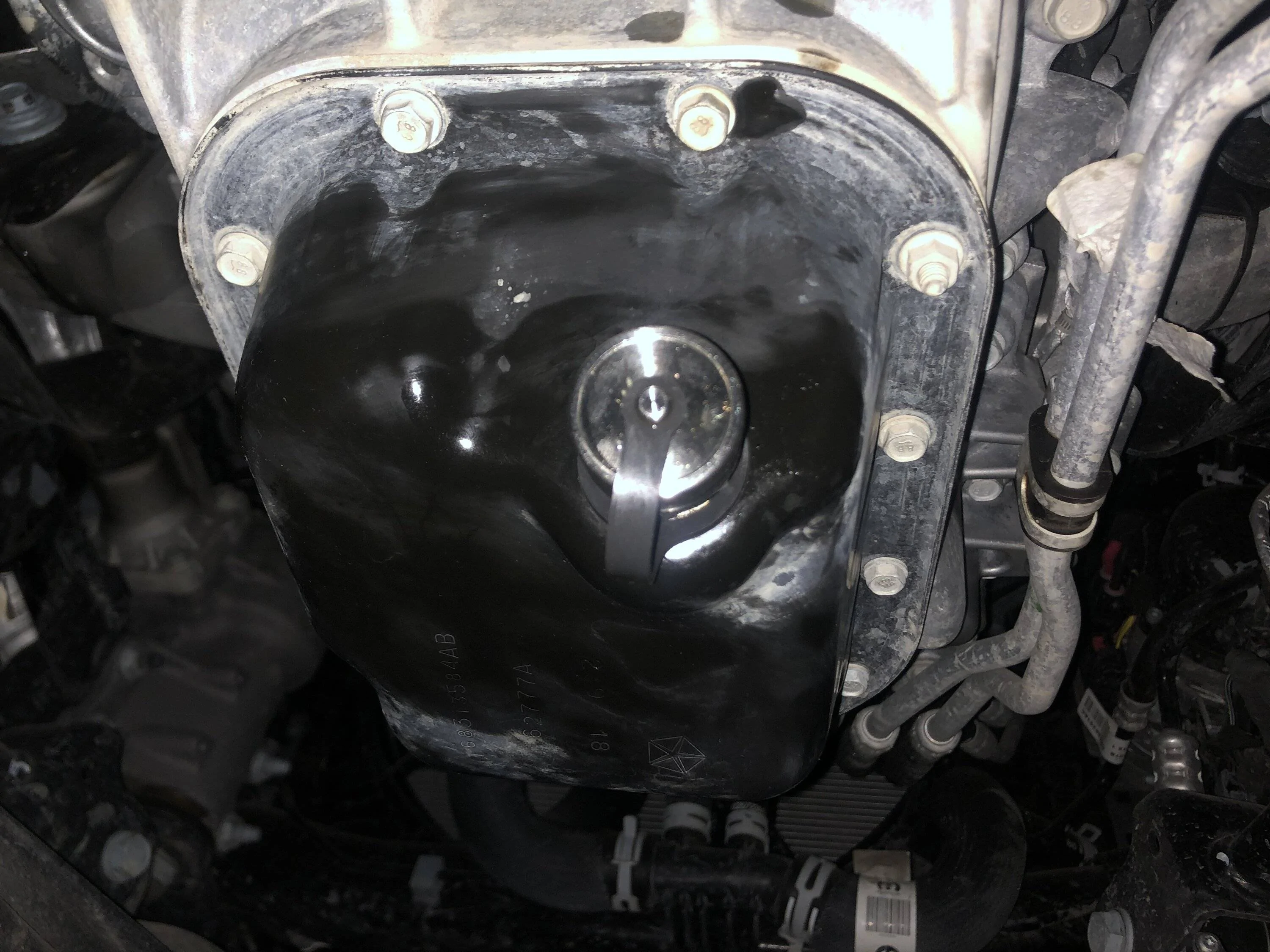

More then once, I have actually pulled a Fumoto Oil Drain Valve from a TJ/JK/JL oil pan immediately after draining the oil.
Probably a shot glass or so of oil came out (if that) after the Fumoto was pulled.
Fumoto Oil Drain Valves have been used on vehicles, etc. since 1976 when Fumoto's first hit the marketplace.
I have used them on Jeeps, Trucks, Airplanes, Heavy Equipment, etc, since 1984.
I know I have followed Fumoto talk on Jeep forums and other vehicle forums for many years.. I don't remember ever reading where someone reported an issue with a Fumoto Oil Drain Valve.
