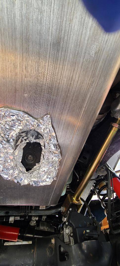

For those of you changing oil with a skid plate that has a small opening, you might try my friend's proprietary ;) "drainflector". Get some heavy aluminum foil and tear off a piece, form it around the hole and oil pan. Use a long extension and socket to unscrew the drainplug. Very tidy.
That's a method that I've used for years on my bikes that have skid plates (which has been most of them.) So, call it complementary in lieu of proprietary. ;)

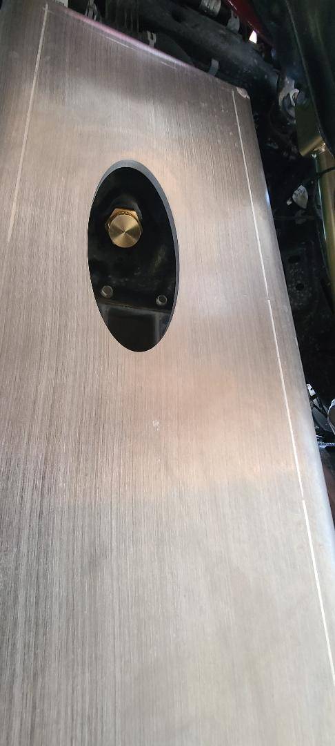

I ended up buying a Femco. However, the correct thread size is M14x1.5. Your thread appears to be M14x1.25.

Challenge is, if you don't have the ability to use a plastic tube to direct the used oil into a disposal container, you've missed most of the benefit of having one of these valves (or, a Fumoto, at least).
Hey, Im pretty quick. But i dont think i could get the factory plug out and the QD in without draining it first. (the Femco QD comes with a hose attached to the actuator fitting)
