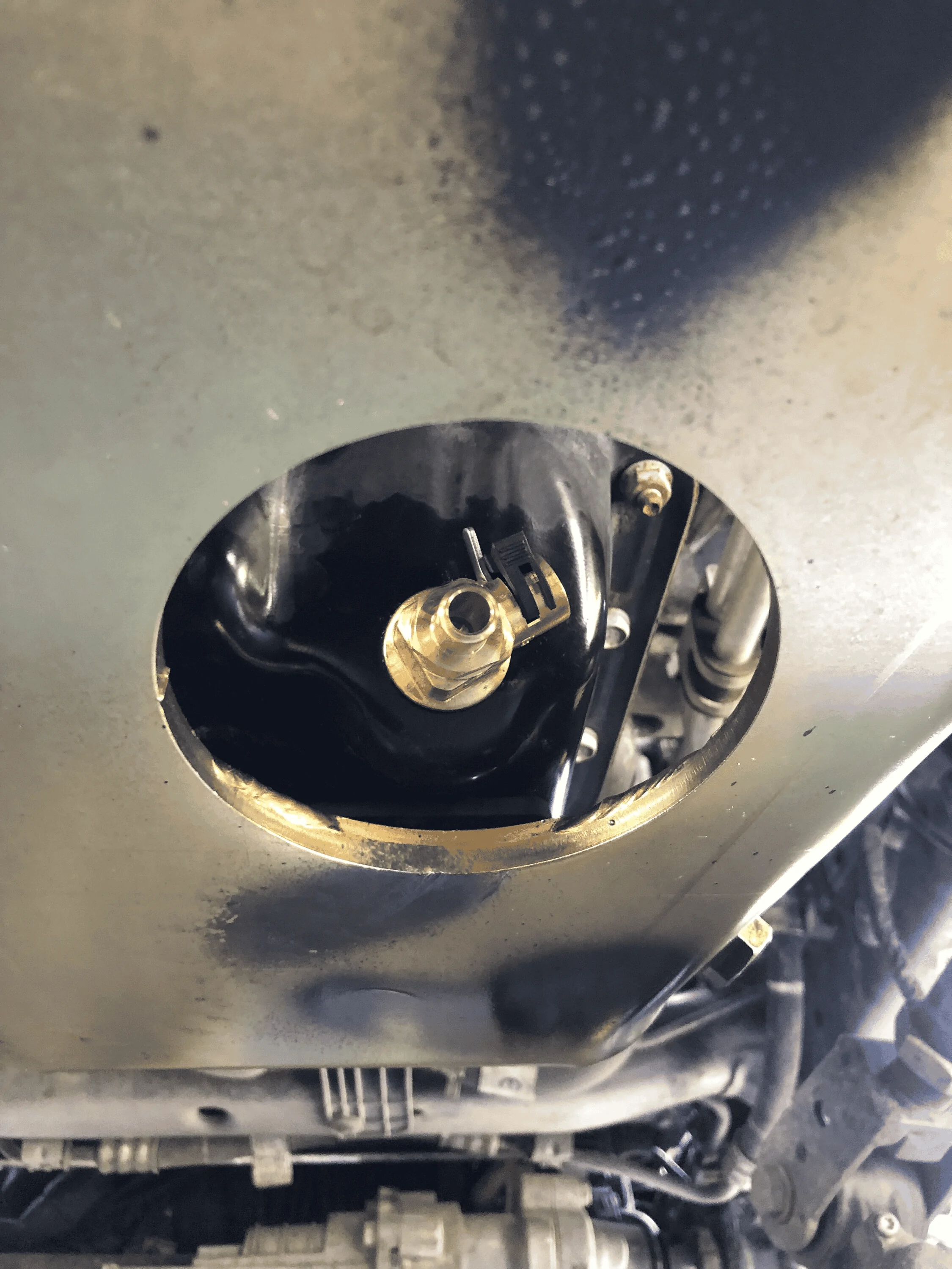

I have the N on mine. I have RR skid plates with a decent size access hole for the drain plug. No way anything will hit it. Without the plate id be more leery.

I have the Fumoto as well but didn’t put it on until I installed skid plates. It sits well recessed behind the plate. They are great to have. I would get the long nipple if you intend on using the tubing. You can spin the nipple up out of the way.

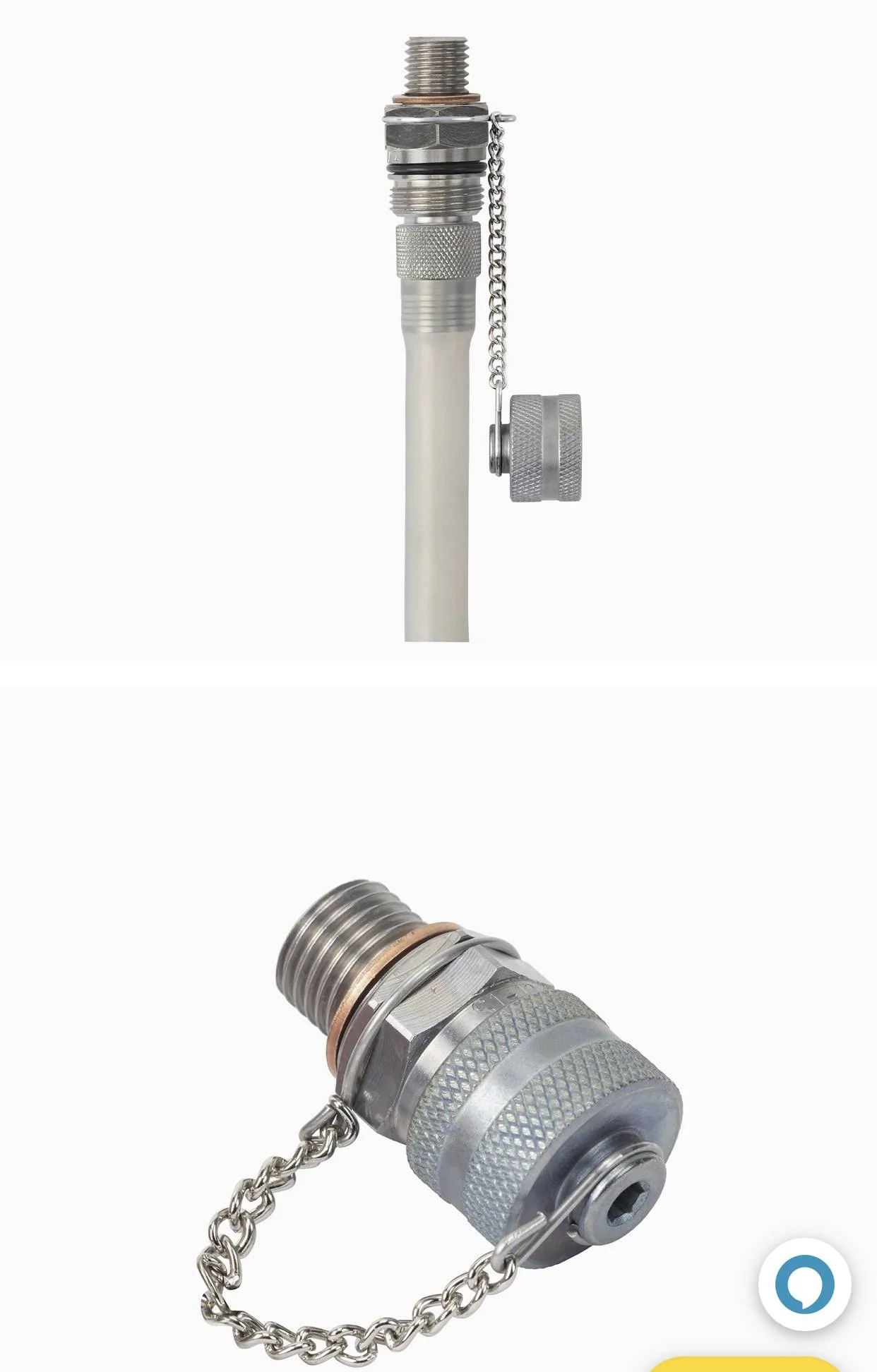

I used a Valvomax for the simple reason that in the very unlikely event that something hits the valve, stainless steel will take considerably more impact than brass. Either one is a good choice for oil changes made simple.

That Valvomax one looks pretty nice too. More to think about. I plan on doing an oil change soon. Im sitting at 5500 miles and want to go ahead and do a second one.
