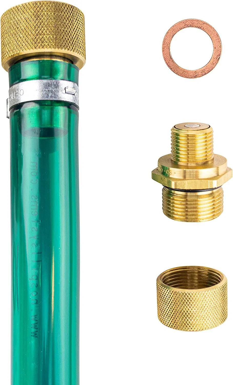

I have the No-spill drain on the Jeep and the last 2 Ram diesels I’ve owned.
The Jeep drain is really low profile and tucked well above the Artec aluminum skid plate.
Remove the protective cap and thread on the hose which opens the valve as it goes on.
Virtually impossible for the valve to accidentally open without threading the hose on.

I never liked the idea of a part that you must have to make the valve work.
Precisely why I selected the Fumoto valve over the multi-piece ValvoMax "system". I don't want to faff about with compulsory, extraneous crap. I just want to drain the oil.
If the makers of those types of drains like the Stahlbus and others that have a separate part that "opens" the drain when screwed in, are watching, they should think about a reversible "cap" that doubles as the drain hose adapter.
Sorry I know this thread is about the Fumoto, but since some are interjecting about others, just wanted to make my observation/input on the Stahlbus.
I have it installed and was able to use it for the first time this past oil change. First impression, what a breeze, clean and as advertised (as I thought). Then I closed it up and added my 5 qts oil thinking everything was fully drained. When I poured the drained oil into the emptied new oil container, it did not fill back to 5 qts. It looked like about 1 more qt could go into the container. As another forum member mentioned in the post I stated about this, he stated that it will not drain all the oil.
SO on my next oil change, I will use the Stahlbus again and then when all the oil seems to have been drained, I will unscrew out the Stahlbus to see if that remaining qt drains or see if I am burning oil.
If the case is more oil comes out, I will move to the Fumoto as I unfortunately won’t be doing any wheeling any time soon.
