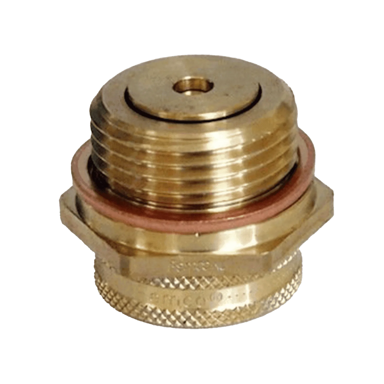

Femco valves achieve the same thing in a totally different way and are also in heavy use by fleet operators. However, the Femco compact sticks out from the oil pan no more than the stock plug.
Interesting, which one works with the JL?

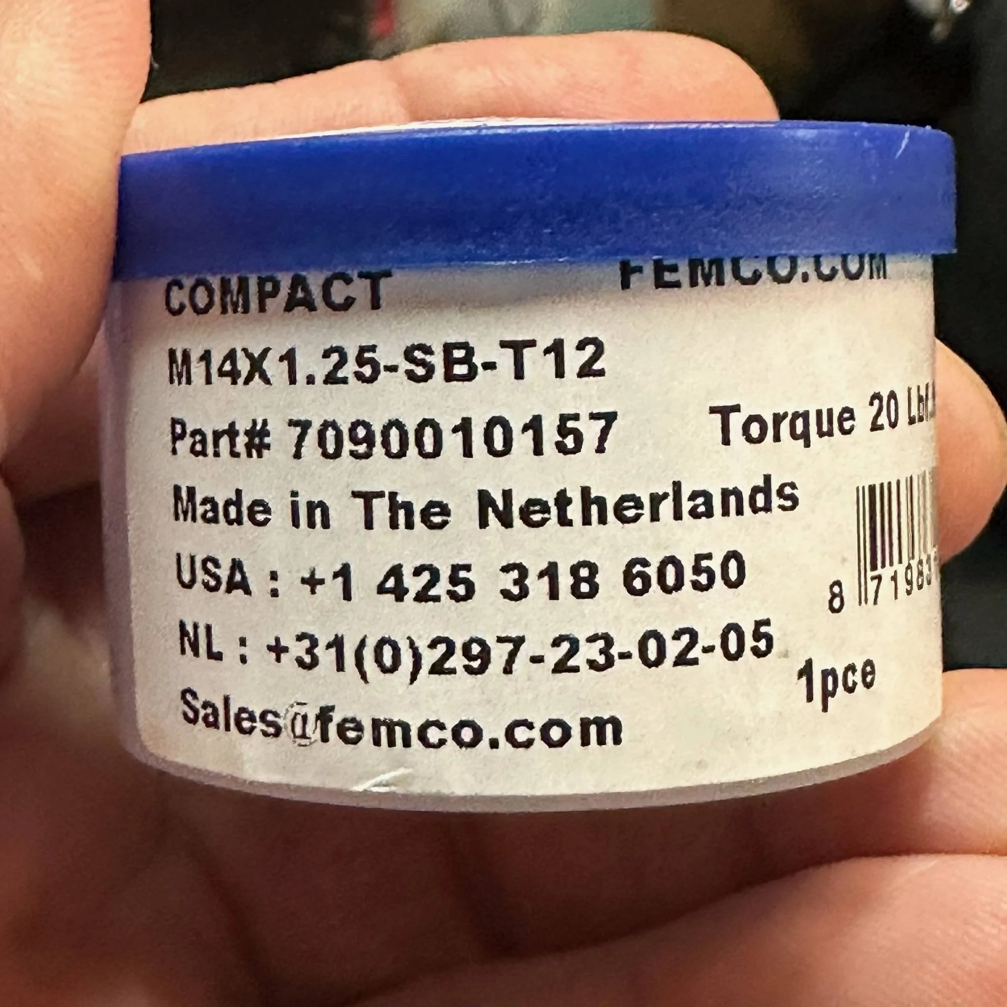

I can't seem to figure out how I came up with the right model. The website mentions to email them for info.
My packaging doesn't have any details. But the actual valve itself (in addition to the hose fixture) had this label on it. I haven't installed mine yet because I've got one more Wave oil change left. But it receives universally excellent reviews, just like Fumoto.

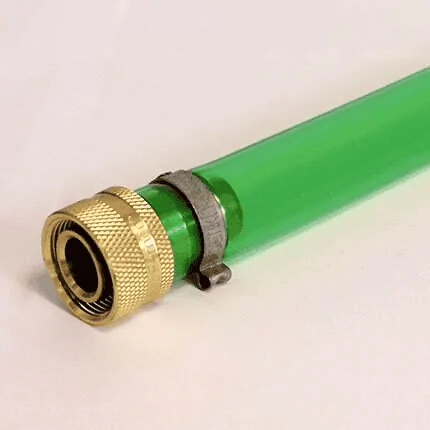

Someone asked about a hose. This comes with the kit I got. You thread off the safety cover and screw this in. After it seals, it opens the valve and oil begins to flow into your container.

Where do you keep the drain adapter fitting and hose?
I don’t have a pic handy, but I cut a length of 1/2” PVC and wedged it between the battery tray and the air box. Drain tube lives there between oil changes.

I've used fumoto valves for decades. They are top quality items. However, I was a little concerned about how much they all seem to stick out.
It's probably nothing and would not cause a problem. But there is no reason to even roll the dice when there is a competitor that makes a product that is very very low profile.
For some reason I thought the JL 3.6L was a 14x1.5 thread? Anyone?
Every reference I found stated the thread size is M14 x 1.5. The M14 is 14mm major diameter of the thread and 1.5 being 1.5mm thread pitch.
I just ordered the COMPACT LB 7090020181 M14X1.5-T10. The LB is for "large bore" faster drains which is different than the SB "small bore" drains they make and are on Amazon currently.
Here's the link to their direct website and this particular drain. There is a link on that page to the compatible drain fitting, purchased separately.
Compact LB 7090020181 M14x1.5-T10 - Femco
I hope I've got the right one. Like I said, I haven't actually installed mine yet.
