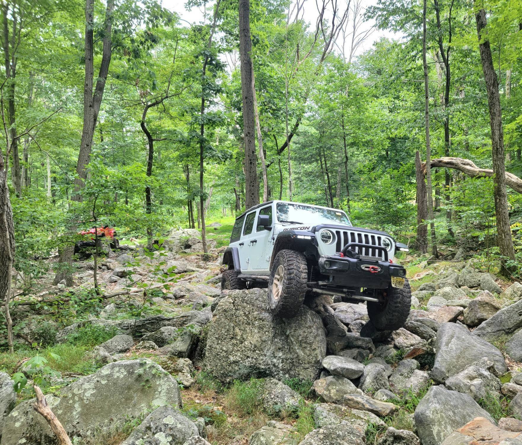

Considering how far up these oil pans are, if anyone is worried about hitting their Fumoto valve on a rock, maybe they ought to worry more about developing their driving skills, and learn to pick better lines...
Just sayin ?
Some folks wheel more than just gravel fire roads with their Jeeps. Just saying. ;)

Again... it's all about picking lines, regardless of where you wheel. ?
? Life doesnt always give you a choice of good or bad. There's always the lesser of two evils too. The pic was the best line. Come down on the rock rail and sliders or run the left line, cradle the rocks and have your passenger side doors smashed by the large rock. Then again, the mall curb or the snow pile aint gonna hit the "way up there" oil pan if you pick the right line. I'm just messing. You do you.
