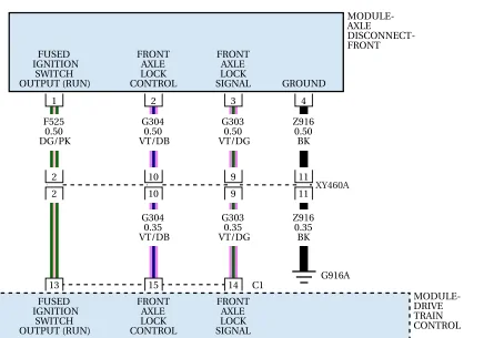

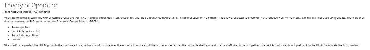

This is what I found... here is how the FAD connects to the Drive Train Control ( DTC ) Module
Jeep Wrangler JL FAD on separate switch 1678863398331
Jeep Wrangler JL FAD on separate switch 1678863441601
Jeep Wrangler JL FAD on separate switch 1678863588974
Pin 1 is Battery Positive (Ignition)
Pin 2 Controls Activation of the FAD.. short pin to Ground to engage the FAD
Pin 3 is a return signal back to the DTC Module of a sensor of the position of the FAD actuator
Pin 4 is Ground
Pin3 will send a voltage greater than 7.22 Volts back to the DTC Module to indicate
that the FAD was sucessfully engaged.. if this is not true.. then the FAD module is bad
So basically if you want to control the FAD manually...
Connect Pin 1 to Battery Positive (controlled by the ignition so you dont power FAD constantly)
Connect Pin 4 to Ground
Engage FAD with a switch connected to ground on one side.. and to Pin 2 on the other side
I hope this helps.. :)
Pin 4 is Ground

Whatever you do.. make sure that you are not connecting anything back to the DTC Module... as you could fry it.. and that would be a sad day for Humanity... LOL
The best idea would be to get a connector and make a separate connection so you can mess with the FAD directly.. if you fry it... then not the end of the World... but frying the DTC Module ... :whew:
