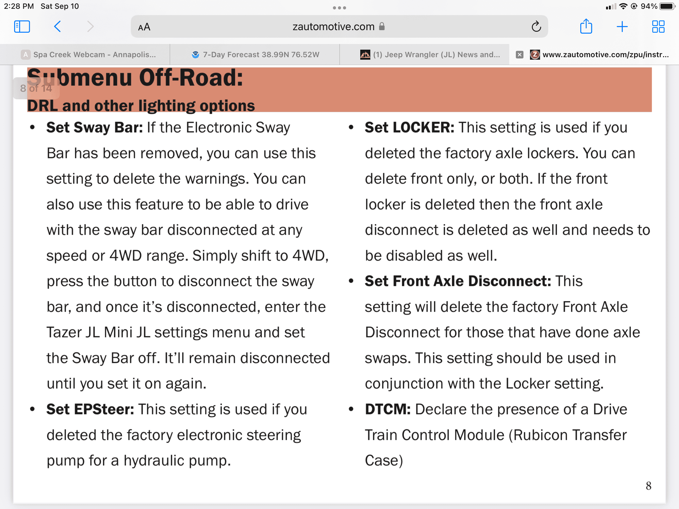

Is yours a jl? I read my 2019 sahara may need a reprogram update for the computer to be happy.
yes, I have. 2019 JL. I use a taser and have had no issues for the 3 years and 50k miles since I’ve done this.
