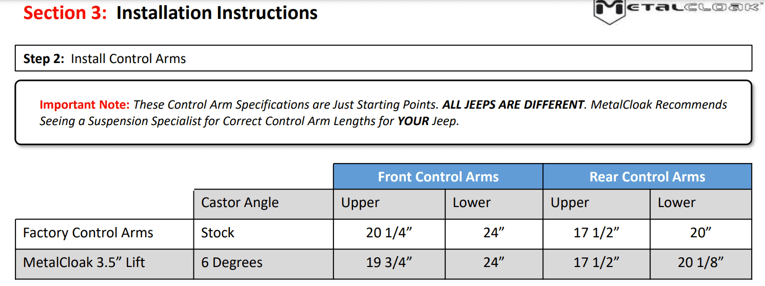

I have a 2021 392 Wrangler with the Metalclak 3.5" Game Changer lift with no FAD. Front driveshaft turns all the time. I have my castor set at 6.2 and run the Metalcloak front driveshaft. I have zero vibration.

It’s not something that will happen to everyone, it’s something that can happen. That’s why Adams adds the disclaimer. Just realize that if your caster is 6.2, your front pinion angle is not ideal.

Metalcloak recommends 6 degrees Castor
Jeep Wrangler JL Fad delete and rcv axle. 1653408002691

Stock 21 Rubicon I measured caster at 5 degrees. No vibes.
Added Mopar lift LCAs which are about 1/4” - 3/8” longer than stock. I measured caster at 7 degrees. No vibes.
Installed 2.5” MC GC suspension and front DS. They recommend stock LCA length and shortening the top 1/2”. I instead shortened the top 1/4” and lengthened the bottom 1/4”. Caster measures 6 degrees. No vibes.
Stock at 5 degrees was a bit darty. Both 7 and 6 degrees tracks straight and true to 80+ mph.
YMMV
