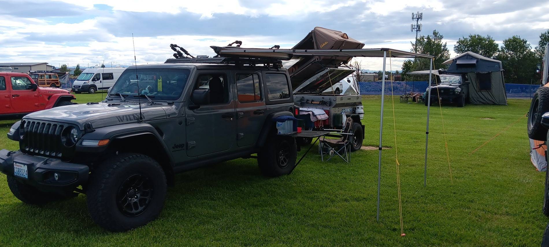

23 JLU Willys XR 2.0T. XR package included a factory 1.5" lift. I added an 0.5" spacer front and rear for a total of 2" of lift.
About 5,000 miles ago I added TrueTracs front and rear. Per their recommendations, I deleted the FAD up front with a MOPAR kit, and got a Tazer to make the Jeep think it was never there.
So far so good. And no noticeable vibrations.
