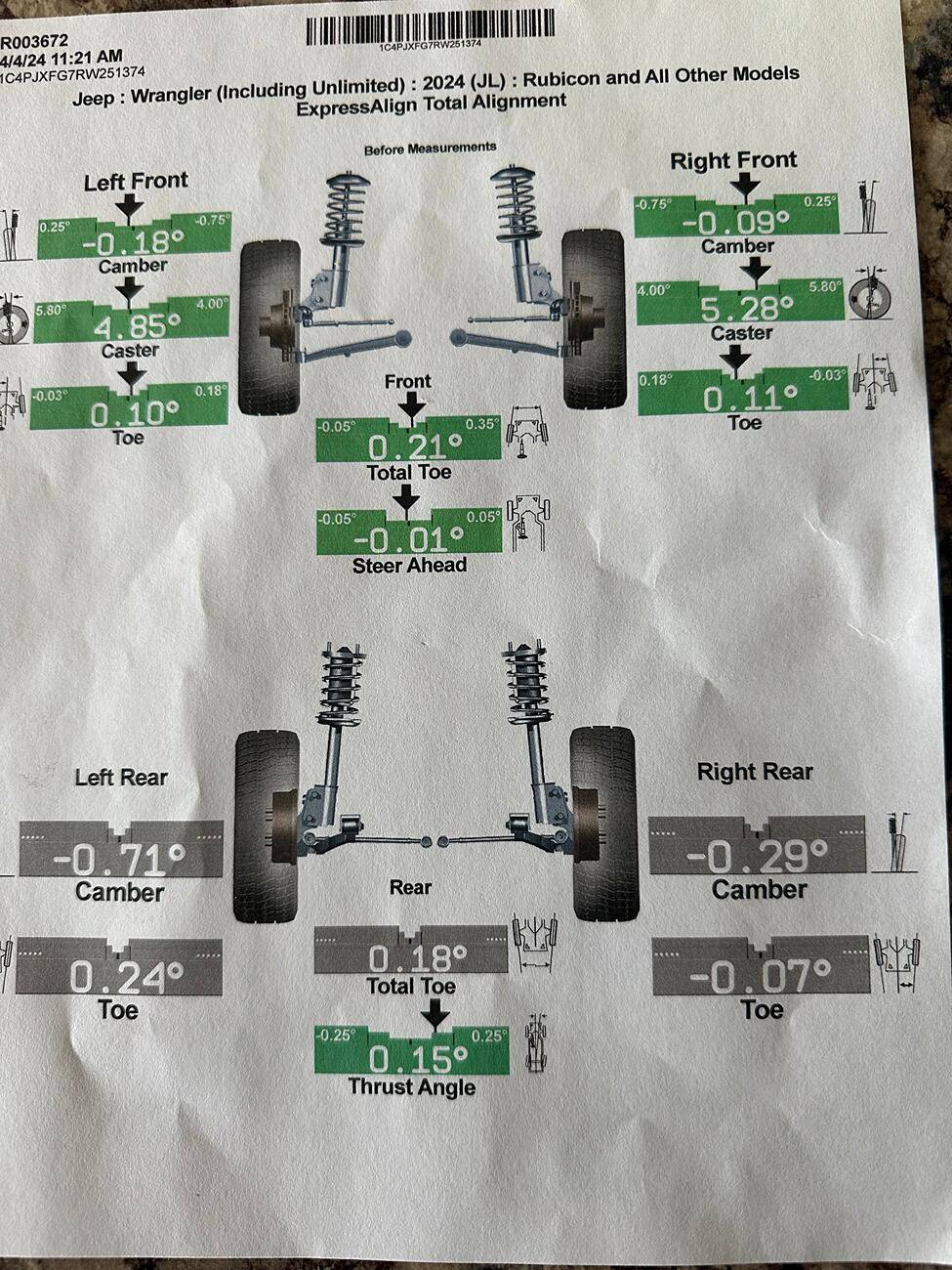

5.2 degrees on the JL with total toe in at 0.1”. Handles just fine on the highway on long trips.
ditto on mine as well. literally one finger steering at any speed. and my previous 4 JK's all lifted at least 3.5 same and about the same caster and toe
Jeep Wrangler JL JLUR FAD delete kit tempImageDq584e
