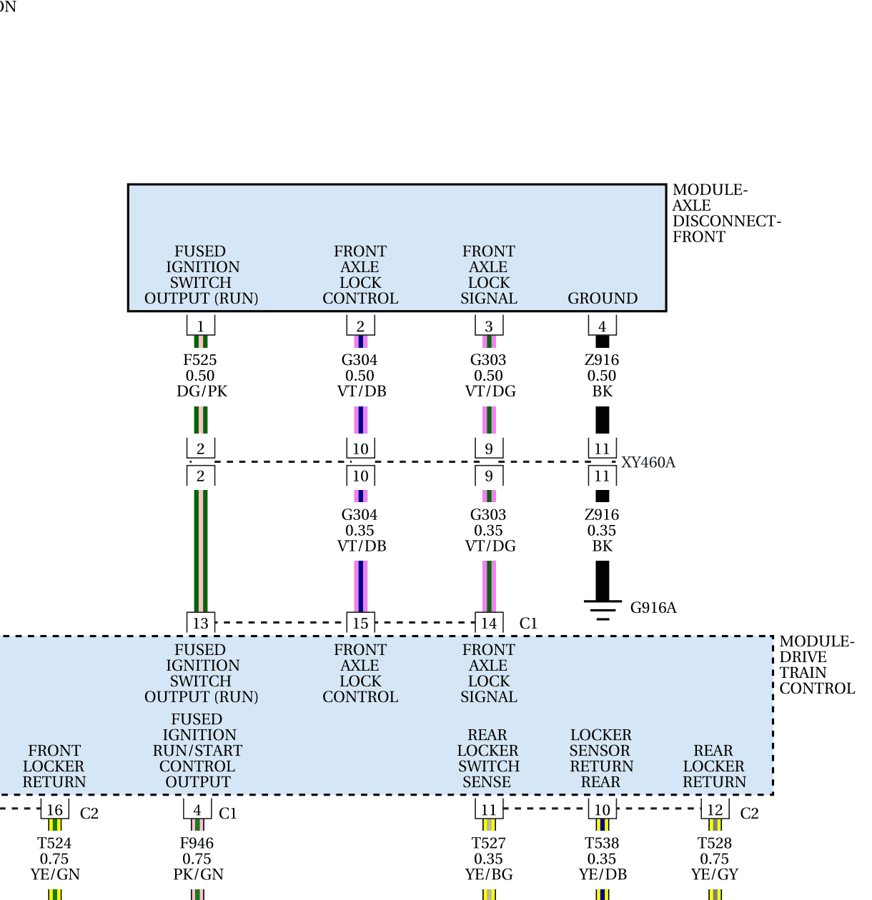

I would like to have 2-wheel drive low. Basically want to trick the computer when the Jeep is shifted into 4H or 4L that the FAD has engaged by bypassing the electric shifter circuit and not produce an error code. Anybody have or have access to a wiring schematic for the electrical plug that goes to the FAD unit.

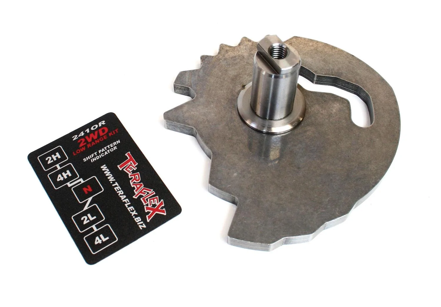

I installed the Teraflex 241OR 2WD low-range sift kit in my JK, used it a lot for backing my trailer.
No way....that is cool. Wonder if it'd work for our JL, I'll check. Thanks!

Well, no luck. Their website only shows a kit for the JK, and one for the TJ.

Yeah it would be nice but I don't think it's technically possible since the FAD is hard-wired to the drivetrain control module on the wiring diagram. I believe the tazer live functions operate by intercepting and/or inserting messages between modules on the message bus. But without a physical connection on the FAD harness there's nothing it can do to spoof it.

I’m bringing this back up. Has anyone seen a 2wd option for the JL? One option I just thought about was plugging a 2nd uninstalled FAD (with fork cut off) to the original wiring harness, and wiring an auxiliary switch to the original FAD on the axle. This would allow the 2nd uninstalled FAD to trick the computer, while allowing full control of the axle. Thoughts?
