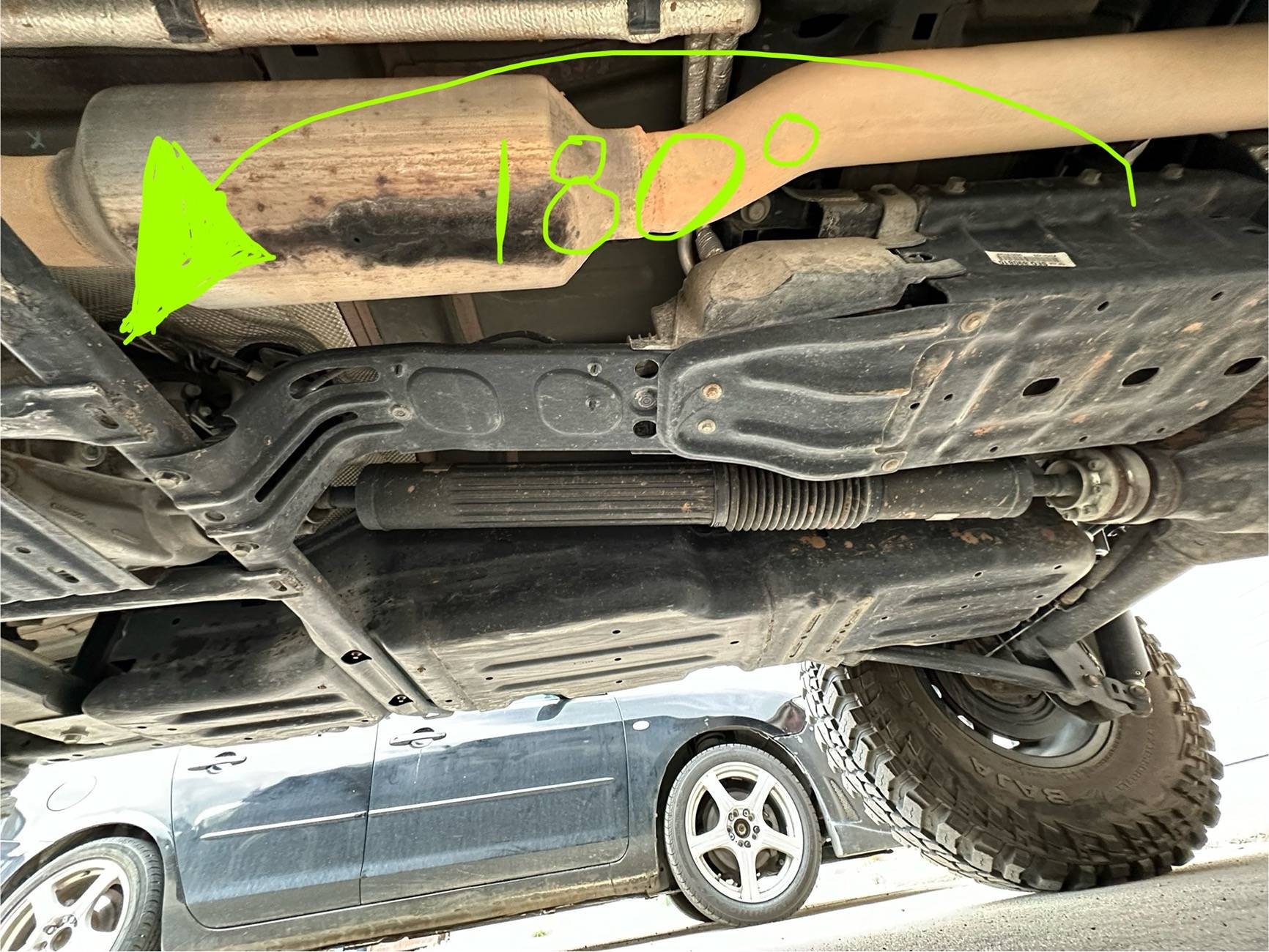

Jeep Wrangler JL E-Torque Relocation? IMG_1037
I was thinking a simple 180* rotation, like this.
It would sit farther forward, over the crossmember and center skid. As close as reasonably possible to the tcase.
Open to suggestion, critique, and/or advice.

The 2-door has the entire assembly mounted further forward. Maybe you can use some factory brackets/hoses.
Not many photos of a 2-door eTorque... but you can see it here next to the resonator:

Bet that resonator gets hotter than the tcase... I think I will try flipping it 180 and building a new bracket for it or something.
That picture was very helpful, thank you :D

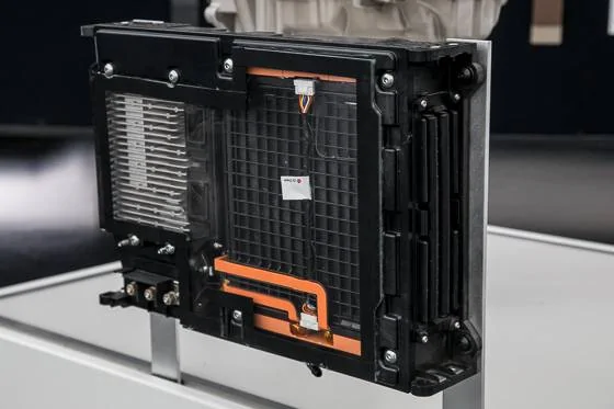

Interesting, the Ram battery doesn’t look like it has its own cooling system. Also looks quite a bit smaller than the Wrangler battery.
Ram battery on ebay
Probably doesn't need a cooling system if it isn't mounted right next to the exhaust...
The Ram battery looks like it might fit in a resized rear cubby.
