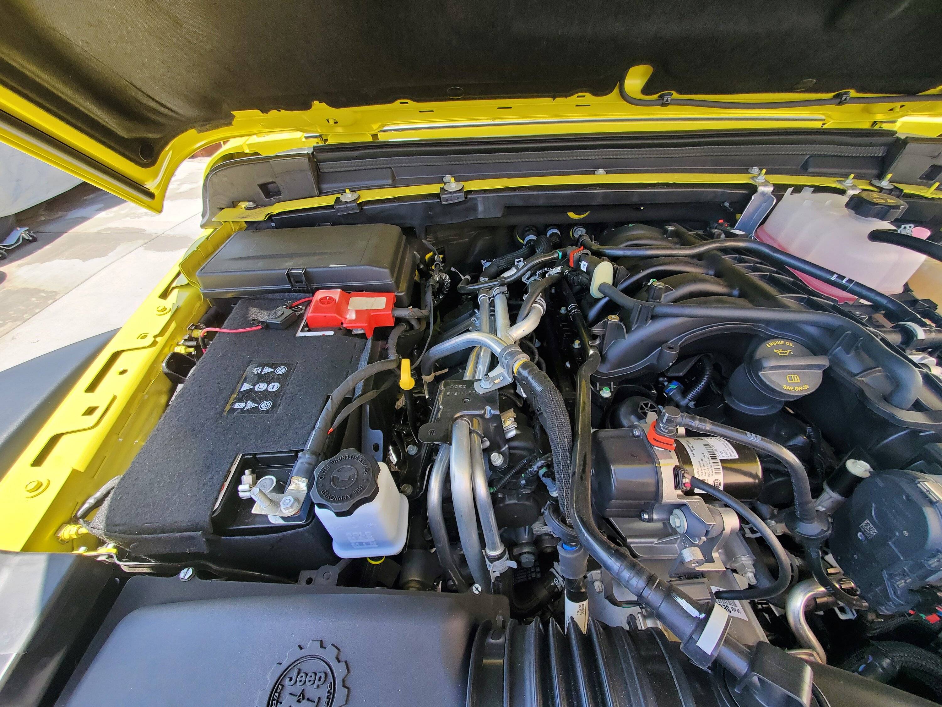

Here is a picture of the battery and it's only cable. I can take a picture of the fender ground if that helps which does have 2 heavy cables.

etorque has one cable on Negative side of Main battery.
So, leaning over the passenger side fender, on Neg side you find a threaded stud with nothing attached and the farthest has the cable.
To be honest, i responded via cellphone and missed you said etorque.
Disconnect 2 body grounds.
Carefully remove body grounds. Occasionally they are painted a bit and you can snap off with removal attempt.
