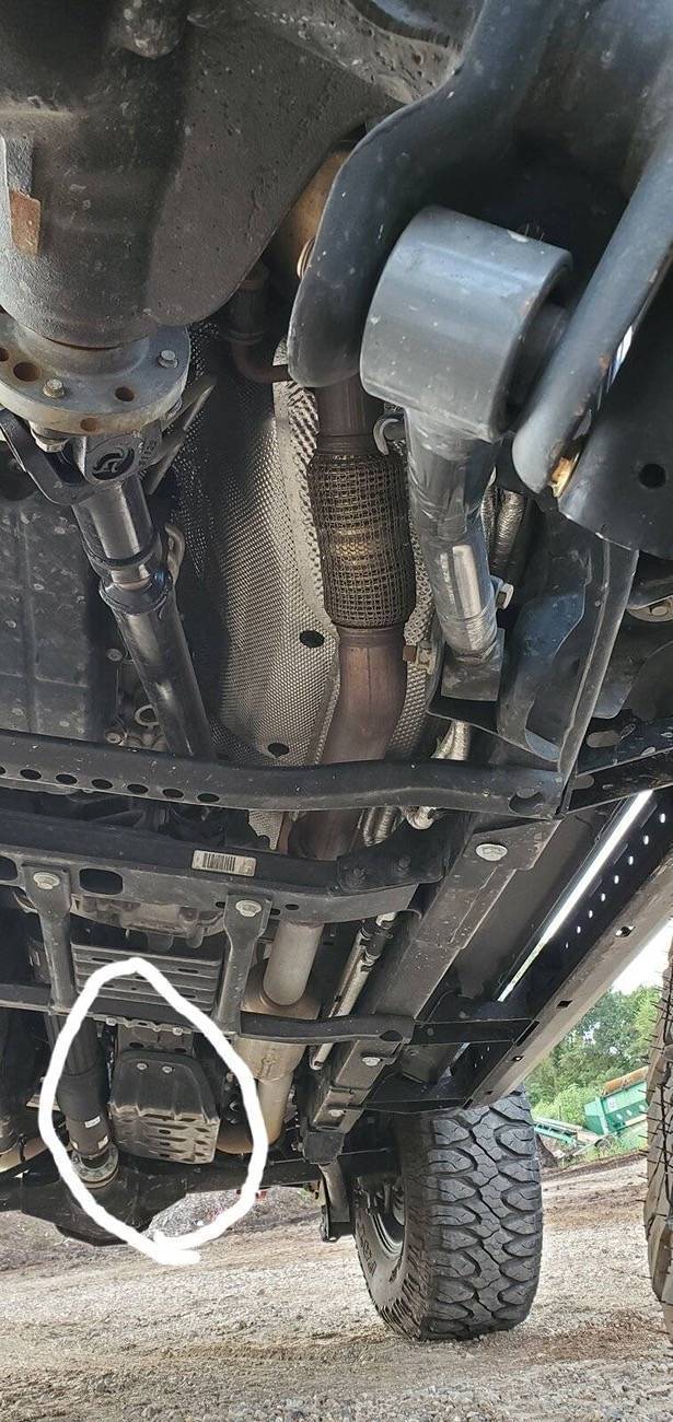

Your secondary or auxillary battery is the 48 volt etorque battery under the Jeep. About the size of a small suitcase and covered by a skid plate. Not serviceable by the vast majority of us, and has an extended warranty.
Jeep Wrangler JL E torque have start/stop aux battery? IMG_2682
Jeep Wrangler JL E torque have start/stop aux battery? IMG_2681
