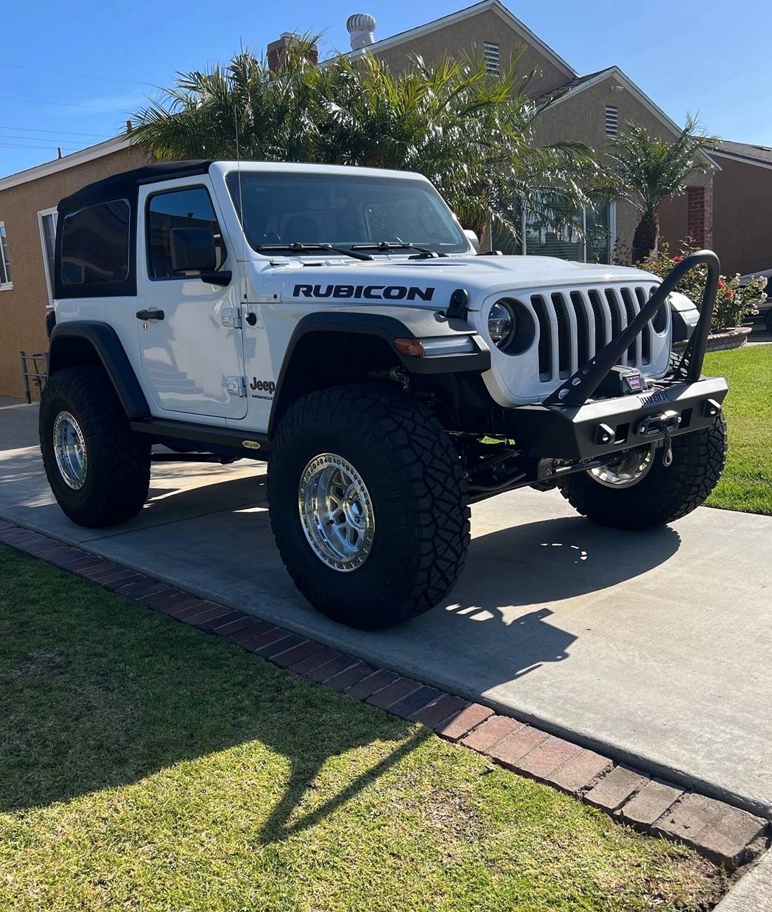

Side note………. On my wife’s 22 e torque, the factory 12 v battery did not last even six months before it crapped out. Then I purchased the odyssey battery which lasted a little over two years. Just recently I replaced it with a full throttle much bigger battery.
