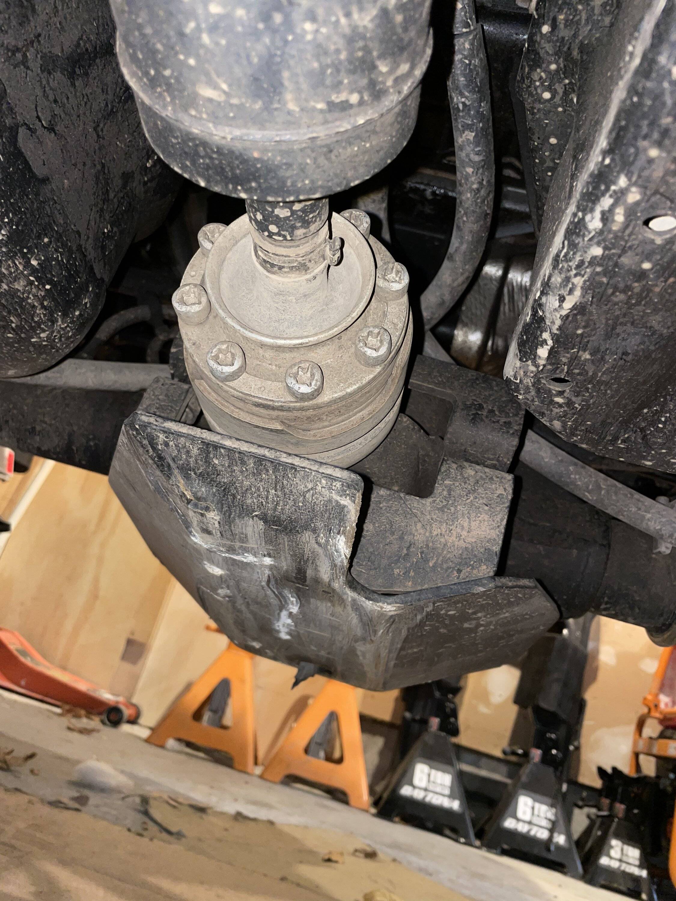

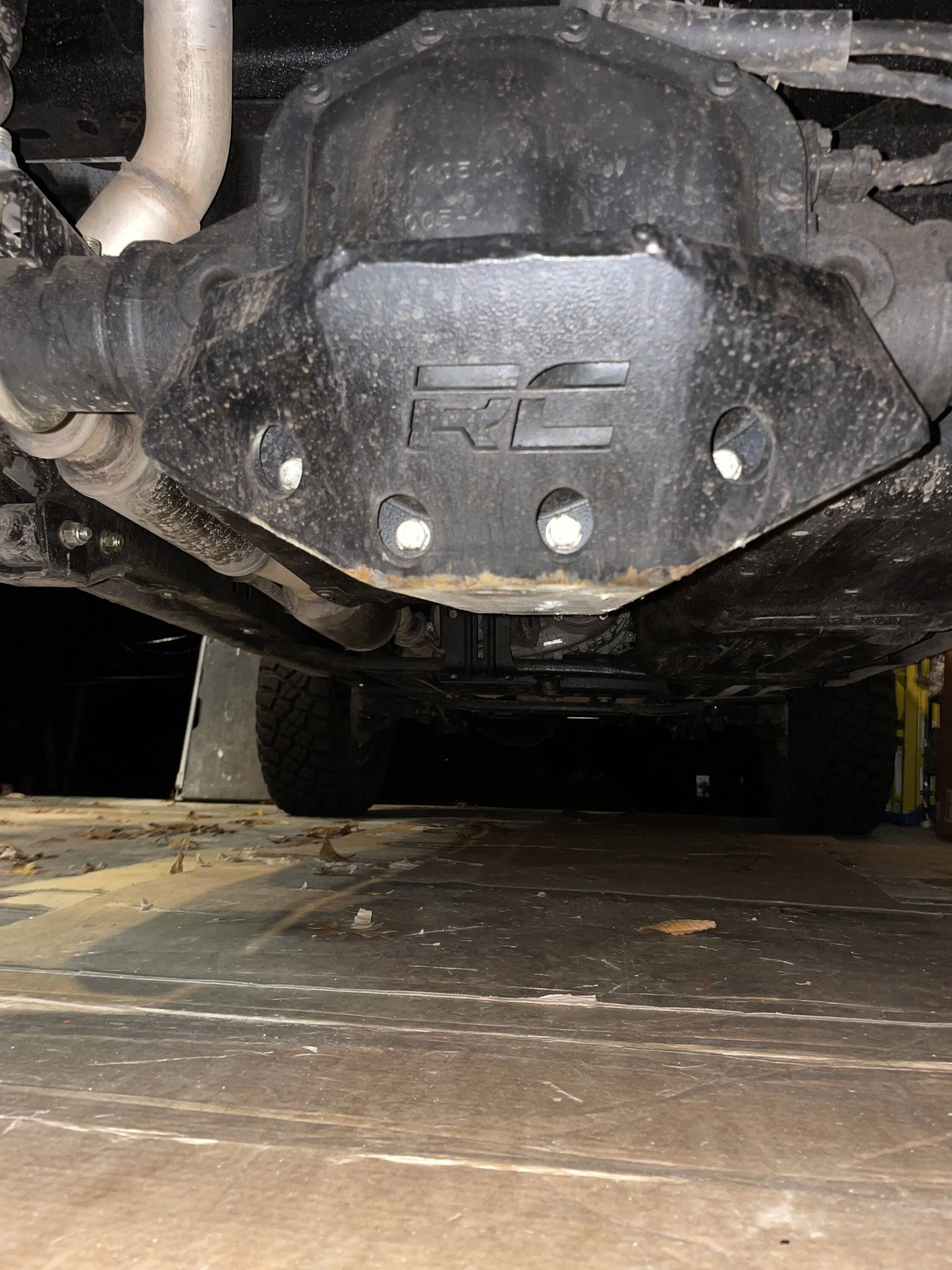

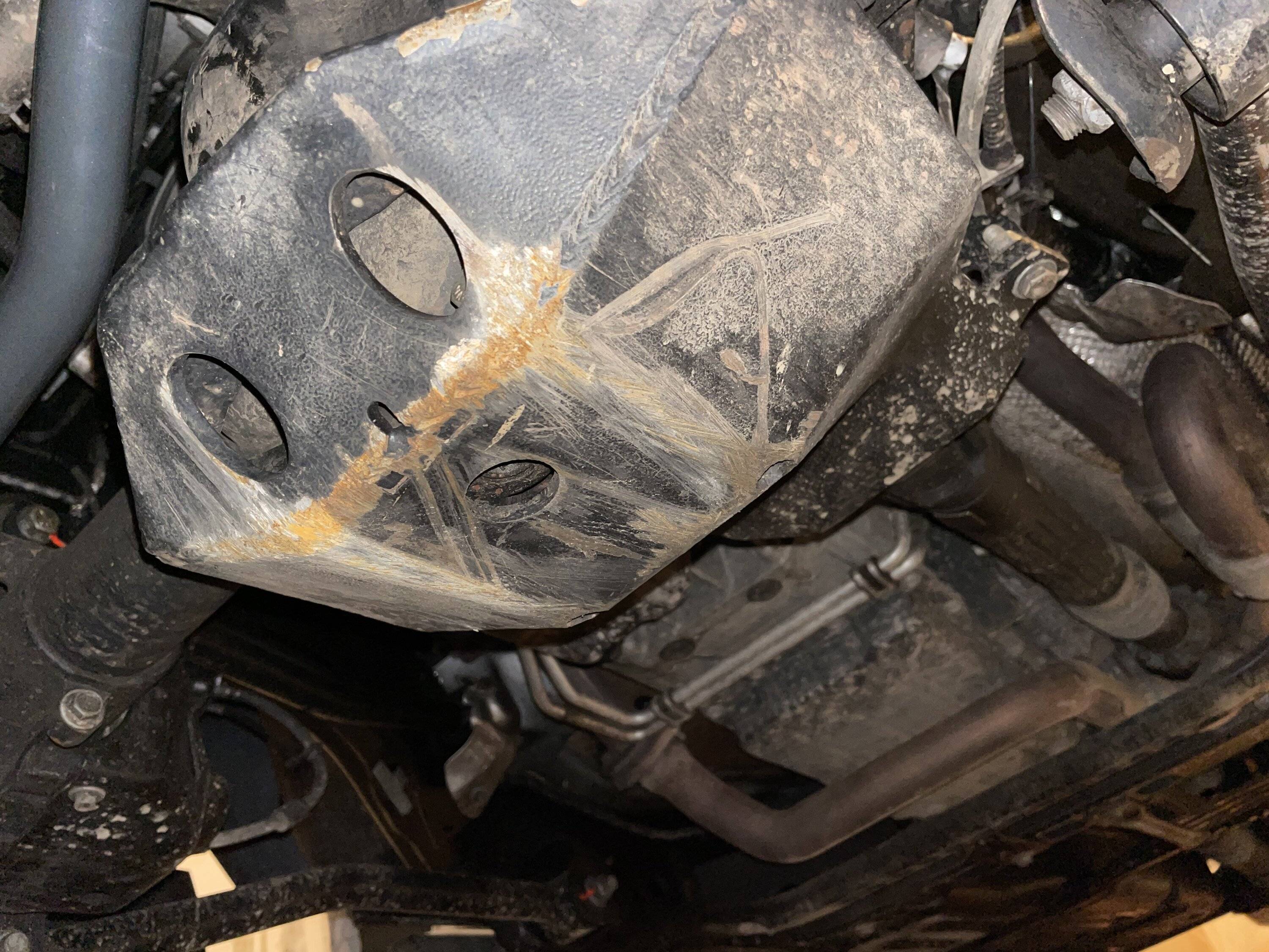

I bought Rough Country diff skids in a pinch before a wheelin trip. I wasnt expecting much but I have to say, they have done the job just fine. They’ve taken a few shots and havent budged. They protect the diff cover enough that I dont see the need for aftermarket covers.
Front:
Jeep Wrangler JL Diff Cover Experts Weigh In 5AC973AE-C9BD-4CF9-AA14-9F9064BBE43D
Jeep Wrangler JL Diff Cover Experts Weigh In 32BF95E5-A99F-4C62-99AF-62CD67E78599
Rear:
Jeep Wrangler JL Diff Cover Experts Weigh In 838B0BA1-B999-482B-800A-214E66D82734
Jeep Wrangler JL Diff Cover Experts Weigh In 45F4E716-21E3-482D-A449-592FF5D1660D
Front:
Rear:
People love to trash RC but they make some good stuff took all those hits like a champ...

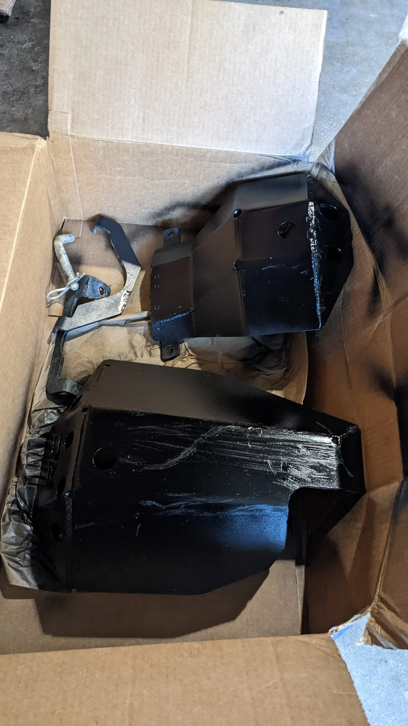

When it comes to skid plates they are F-ing awesome for what you pay for. I have their front and rear diff skids, oil pan skid, transfer case skid, and rear control arm skids. I think I paid no more than $700 for all of them and they have not disappointed.
After my last trip, I took the diff skids off to clean out the mud that caked in between, spray painted them, and they are good to go for more beating. Still running the OE diff covers as RC skids do a decent job covering the lower 1/4 of the differ covers and bolts.

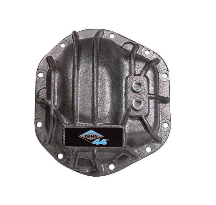

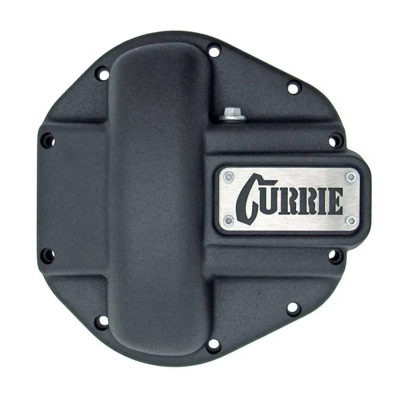

I know this is an old comment and I am no expert on gear or differential. And I have no need for anything other than oe diff cover, but this is what have found interesting. I have seen this video way back and I think he has a point. Whether their products do what he claims, or a little less areation and more oil flow to the pinion really makes any difference in the long run, I do not know.
If you look at all the diff covers for jeep in the market, there are only two designs: cast iron style and sheet metal welded style.
Dana, ARB, Yukon, Currie, dynatrac, G2, and even Teraflex all have the same design.

These companies design keep the curvature and shape close to the OE cover. These companies that make it this way are either in the axle or gear business and I would tend to believe they keep their diff cover they way they are for a reason.. more fluid flow makes sense to me.
And you look at other "fabrication shops" that use a sheet of metal bend and weld a diff cover together like this where it has more flat surfaces and sharp angles..
Jeep Wrangler JL Diff Cover Experts Weigh In r1270-main
Again, I don't know if that means anything just something I noticed.
If I were in the market for diff covers, I would tend to believe those axle and gear companies know a thing or two on making the "right" covers and stay with those brands.
I have no other proofs to prove my theory, nor am I saying one is better than other.
Just something to consider.
