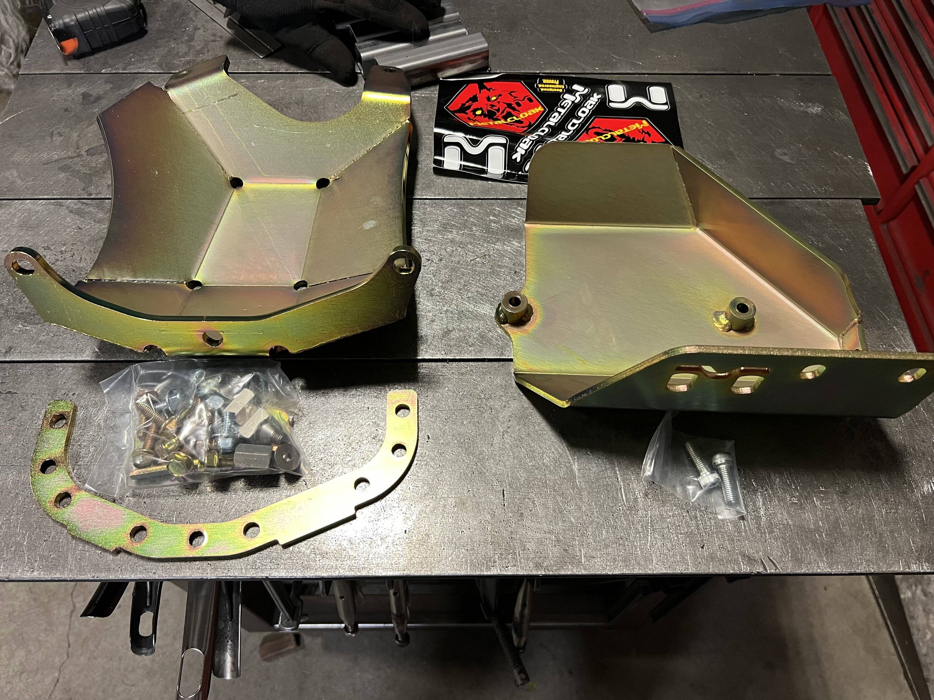

I’ve got the @Metalcloak skid but not the cover. There’s a version you keep your oem cover
Was any drilling required? Can’t tell how the bolts near the pinion go in I don’t have any holes there on mine.
svc707
Steven
May 30, 2022
24
236
342
Vacaville,ca
23 JLR, 21 JTM, '23 4RNR
yes, one hole where its flat. once its all bolted up it was fairly easy to drill with skid in place. Ill take a picture when i get home

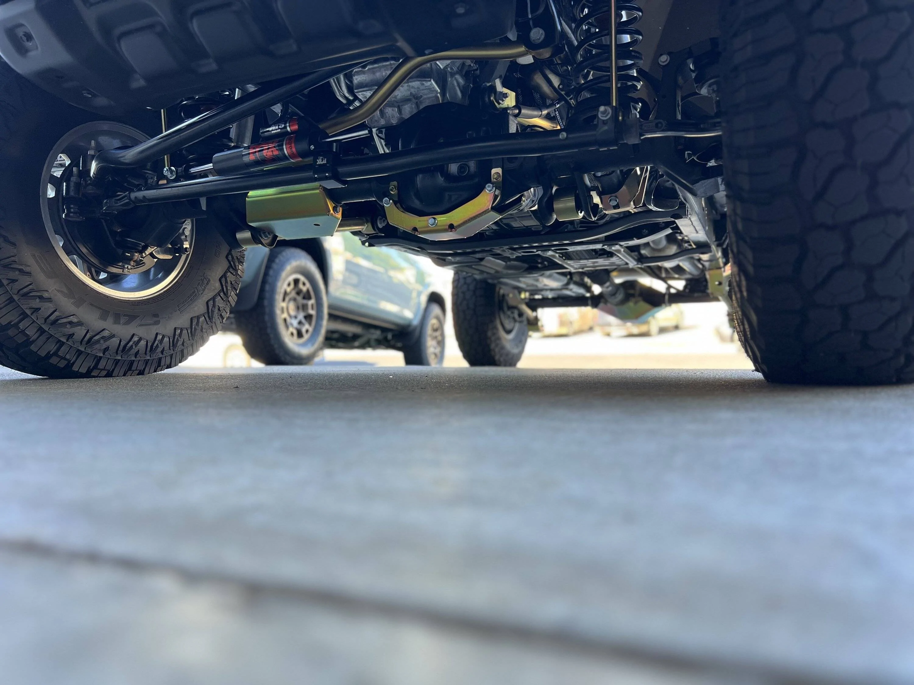

I just installed the same one last weekend, it's a great product. Went on very easily, only took maybe a half hour. All you really need is an assortment of sockets/wrenches, and a drill with a 3/8" bit, and a couple smaller bits to drill pilot holes so you're not doing all 3/8" at once.
I also own the version that comes with the MC diff cover, it's been sitting in a box for the last 9 months because I never found the time to change the diff cover over. This one for the OEM diff cover is a great solution for lazy people like me.
