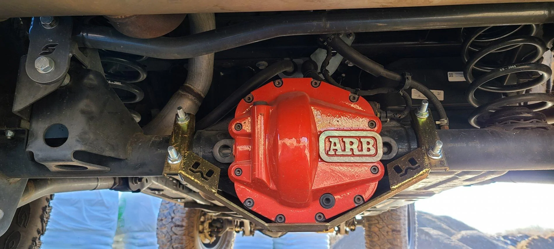

Has anybody installed the metalcloak diff skid plate with the Dana Advantek cover on the rear? I wonder if there is an issue with the ribs hitting the skid plate.
I have the ARB diff covers, which are pretty thick, and still have plenty of clearance from the Metalcloak rear diff skid. The skid extends a decent amount rearward of the cover, before it angles up. You should be good.

Thank you. Pic was very useful.
