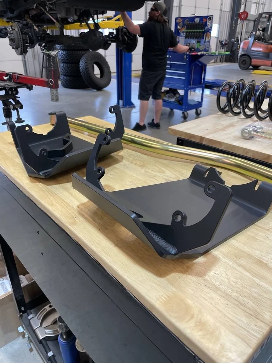

I use the rancho skid but shop had to address clearances on the skid bracketry to make it fit.

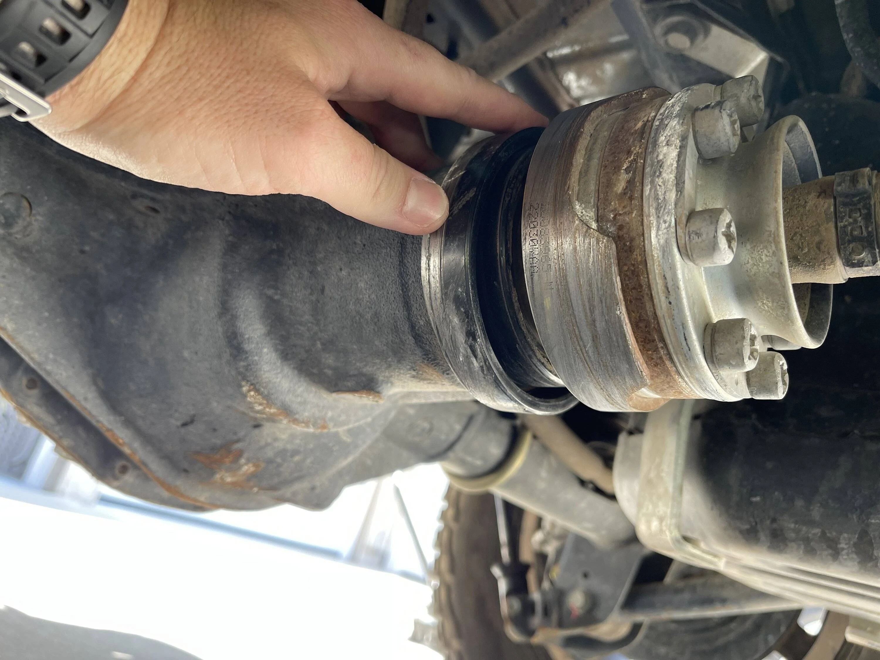

I wondered the same thing and have the same covers. Then I ripped this sucker apart on a trail, when a skid that protects the pinion area would’ve prevented it. Thankfully @chevymitchell had a spare he could send my way. Looking at my front axle I see scrapes on the driveshaft u joint ears, which makes me wonder if I damaged one of those slipping off a boulder how ugly that could get.

Rancho Rear
Rancho Front
As I mentioned these will fit but require some clearancing.

We've got the front D44 skids in stock:
https://www.northridge4x4.com/part/...ho-performance-front-diff-glide-plate-dana-44
Showing out of stock the rear, but shipping from the mfg. in 1-2 days:
https://www.northridge4x4.com/part/...cho-performance-rear-diff-glide-plate-dana-44
No mention of them being discontinued....yet.
Good to know. Thanks for laying that to rest!
@sourdough confirmed these don’t cover the pinion area, I thought they did. Shoot.
Regardless, they should work with some effort apparently. Anyone else have any recommendations for those of us with the Advantek covers?
