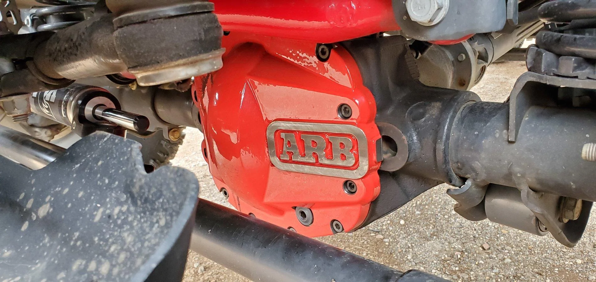

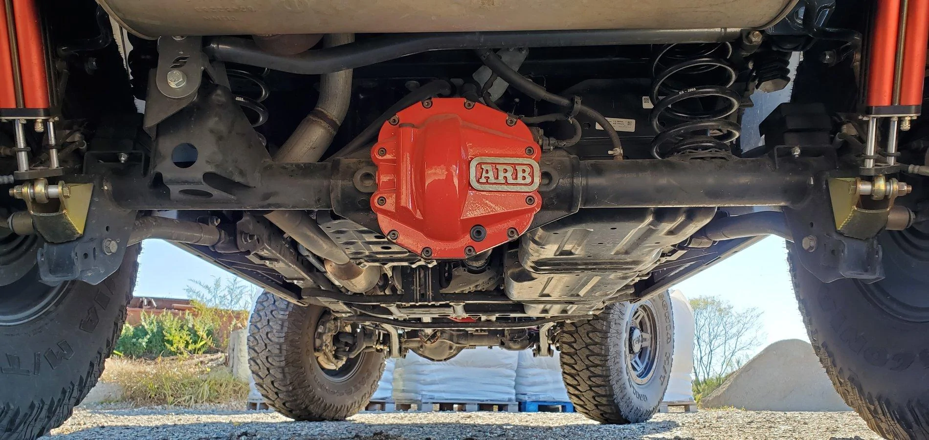

I say test it. If you do your own work, it shouldn't be too much to do. I honestly could end up having my shop test for me when I swap out springs in the next few months. I'm also going to talk to them about just pulling out the grinder and making a very small notch on the track bar. Surely that wouldn't reduce strength much. Because at the end of the day, part of the reason I went ARB diff covers is I think they are the sexiest and I'd like to keep them. Here's my rear. LOL.
Same thoughts here about the ARB covers. That's why I opted to lose the SteerSmarts track bar, which I'm also a big fan of.
Yeah, I'm the only one who touches Baby. If there's any interference, it couldn't be as much as there is with the ss, which isn't really that much. Just enough to want to address. The cast iron is plenty thick enough on the ARB cover. I would sooner trim that than the track bar. Its only that top front corner of the dipstick outcropping that would need it. I'm hoping to find out this Saturday. Been busy and parts are piling up.
Definitely sexy!
