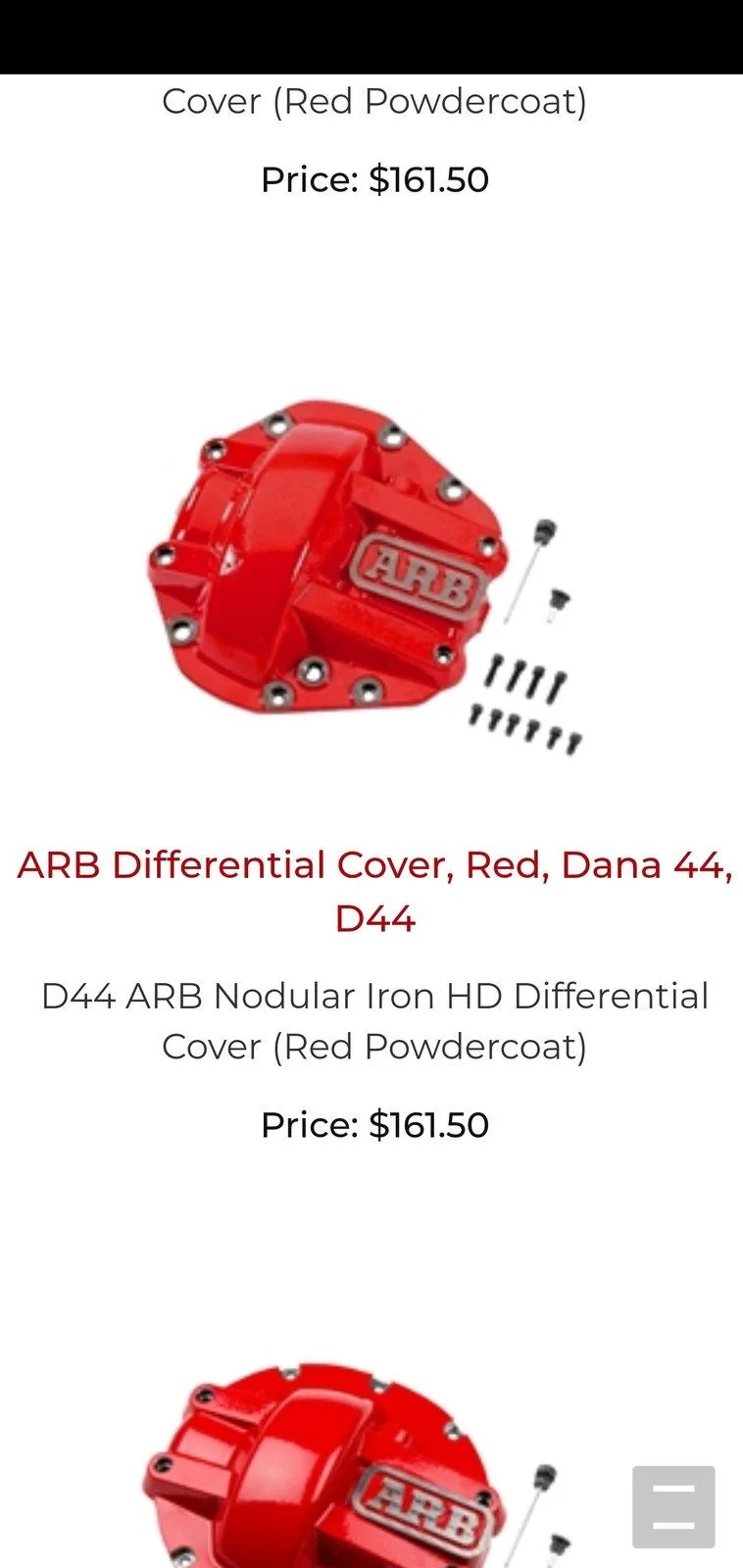

Any idea if those Poison Spyder Dana 44 covers are compatible with the JL/JLU Rubi?
Just checked their site, and looks like they only have the D44 covers for what I assume is for JK's. I recently upgraded the covers on my Rubi, and found that most places used the term D44 but the cover shown only had 10 flange bolts. We have 12 bolts front and rear. That led me to the company Just Differentials. They have covers that specify M210 (front) and M220 (rear) with the 12 bolts.
I posted pics in an earlier post on this thread of what I bought. Here is a shot of the D44 listing from the same company's site. This is identical to what I just saw on poison spyders site. This will not work for a JL Rubi.
I ended up e-mailing Poison Spyder after posting and they confirmed it is indeed not for the JL. Appreciate the suggestions and clarification--looks like I'll have to do a bit more research.
