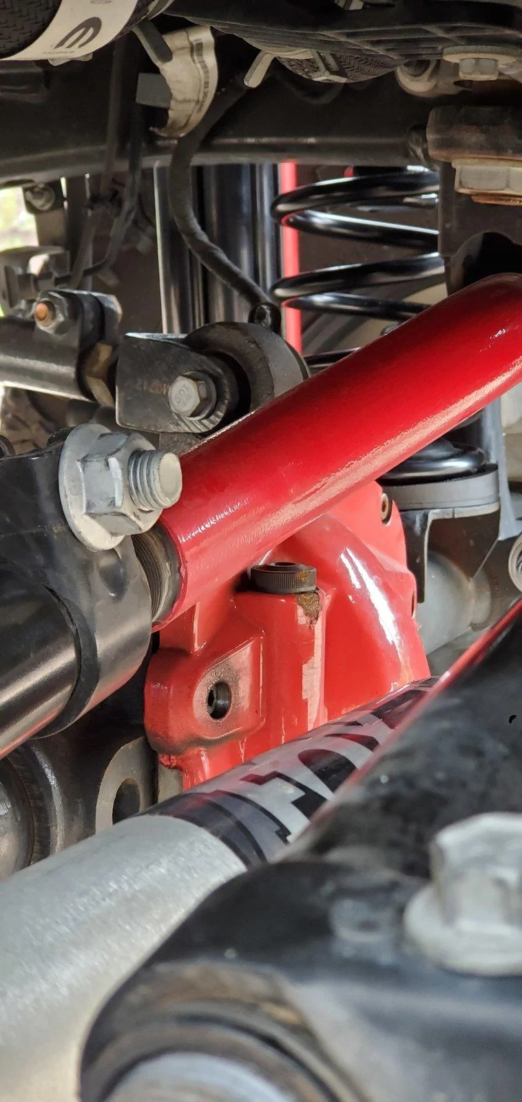

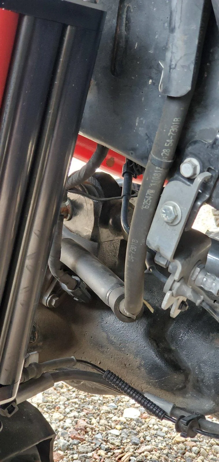

In my opinion, lifted or not has nothing to do with clearances. If something interferes at stock height, it will just have to travel a bit further for the same hit with a lift. So far, the SteerSmarts front track bar is the only one that doesn't play well with a thicker cover. It was hitting my ARB front cover at the dipstick/fill point. I'm switching the SS for Metalcloak's front track bar, which is advertised as offering the most clearance for up travel, compared to all other bars on the market. Enough to fully clear a Dana 60 axle diff. Here's a couple pics of the SteerSmarts/ARB interference.

Ouch - I can see where it hit both of them. I am guessing that is at full or nearly full articulation?
No, not an issue at full flex in either direction. Only hits when the whole axle compresses at once. Same thing happened to TxJeepers. I responded to his post further up on this page. I found it funny that we both decided on switching the track bar instead of the diff cover, and that we also chose the same replacement.
