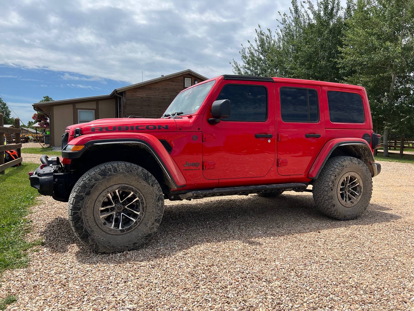

100% recommend getting your self a good brand of rock slider or you will at some point put the willy's rock rail into the body and cause a nice size dent. ask me how i know. i currently have both lower door seal body damage. i went out and paid more than i wanted for a good set of frame mounted rock sliders and it has save my jeep more than wroth the $$ spent on them.
Agreed. Went with Lod signature rock sliders.

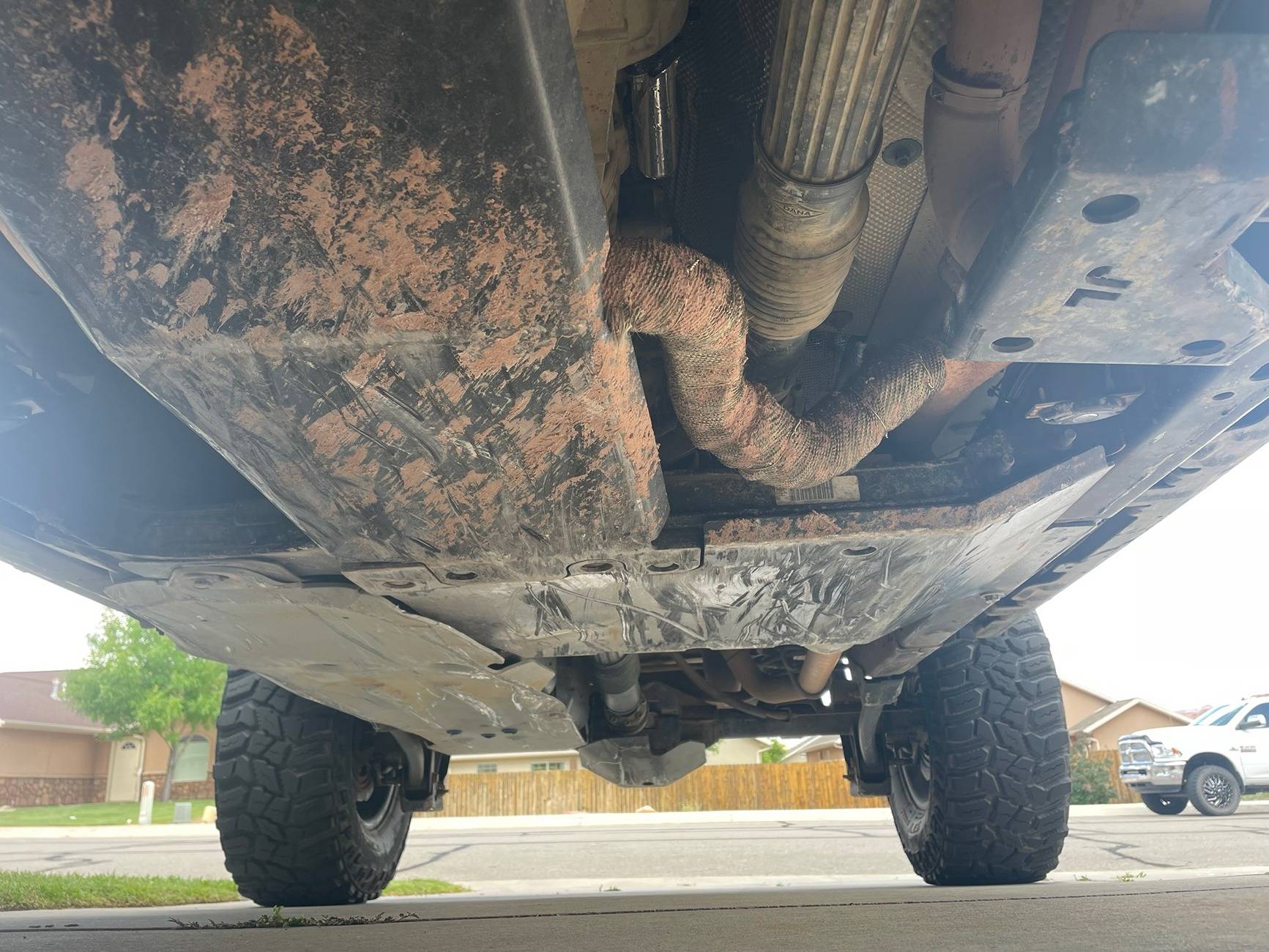

If you are not ready or wanting to go on difficult trails, I say stick with stock. Diff skids are a simple piece of mind. I have been on more than several challenging trails with OEM set up… before and now lifted.
Best thing is to first learn better lines, using a spotter if possible and understand how to avoid hitting your pumpkin and your lower shock mounts. I see many newbies avoiding driving over rocks. That is the key… put your rubber on the high points and the rocks between them won’t be in play.

Based on your post. Maybe go for a Rubicon take-off lift. Save up and get some 33's with a bit of offset. And just have fun!!!! Go slow, use your spotter, and be amazed what a mostly stock jeep can do!!!!
A couple of skids isn't going to change how you wheel. And skids have a lot of downsides too!
But if you decide to go bigger... plan it all out ahead of time... have an end picture in mind and build to that plan. Know what you are getting into!
