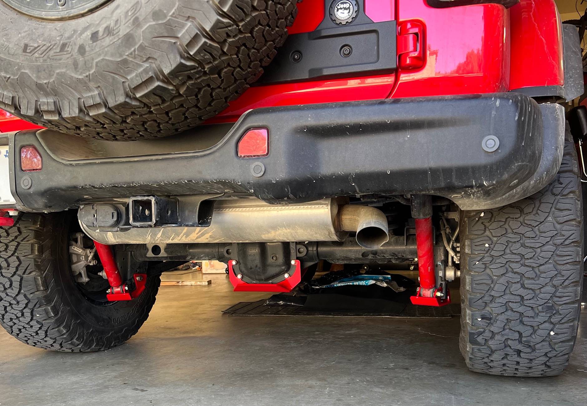

I installed the rancho slides. They fit well.

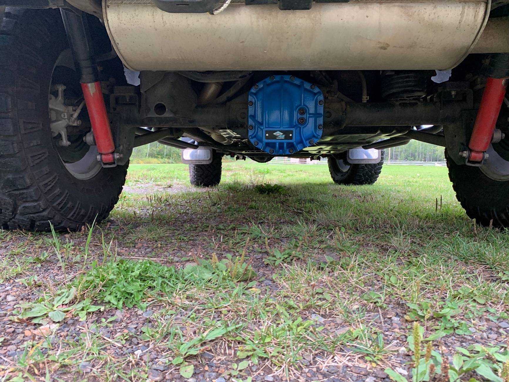

Dana/Spicer covers front and rear.
