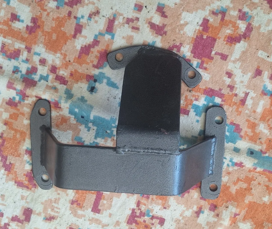

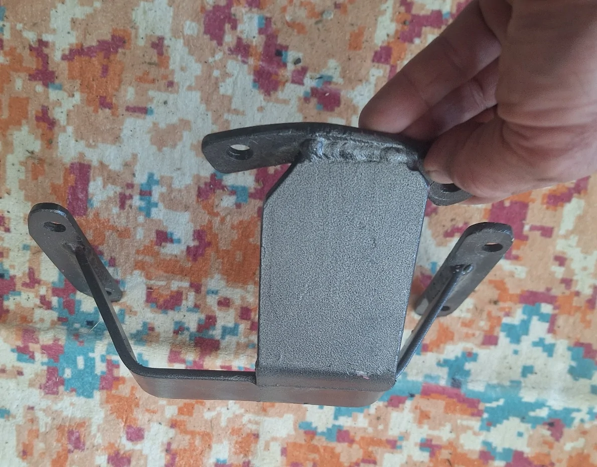

my opinion is 99% of people dont need them, if you hit a stock steel diff cover hard enough to bend it 3/4 of an inch to contact ring gear and then continue to drive to wear a hole through 1/8 steel?
so we always used them on our ifs rigs because you constantly abuse the rear cover.
easy fix I did for out beater race trucks was a couple pcs of 3/16 or 1/4 bar and a spare gasket. These never broke off bent and $25 is better than $150+
example of a standard D44 protection ring.
mods...its on marketplace dont ban me.

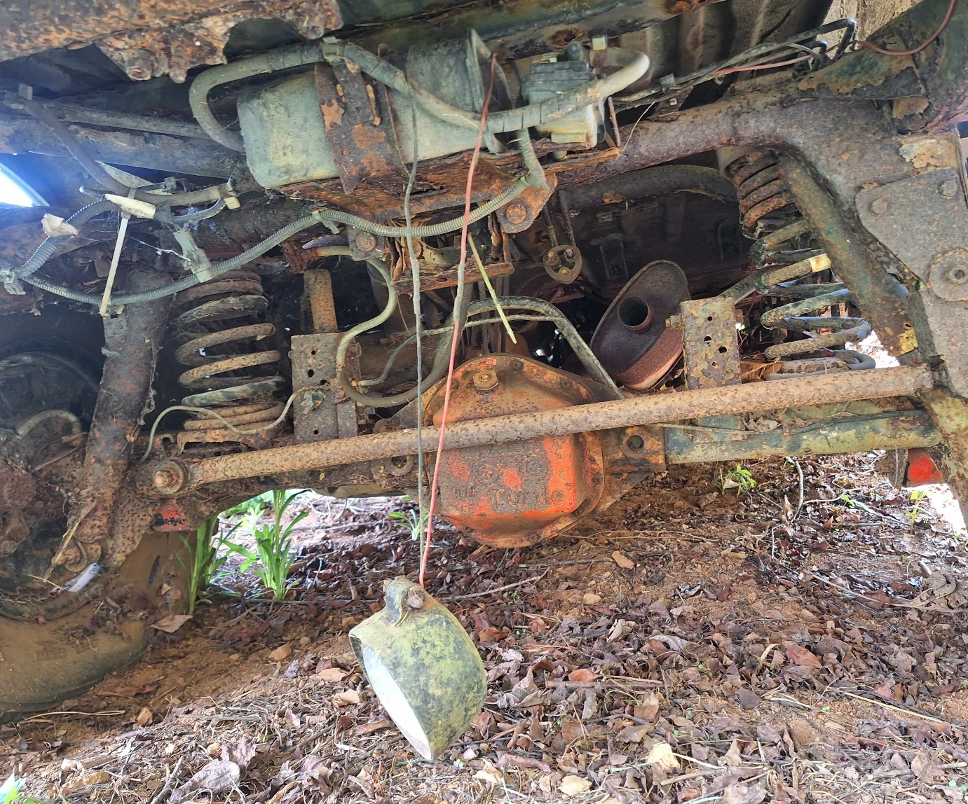

Were as this is like a 20 pc 1/4 thick cover i built for the turtle back 2002?
Jeep Wrangler JL Diff covers and Diff Skids ? 20260318_103851
I always built hvy covers because isuzus 1998+ had aluminum find covers. Every time you would back into stump fins would break and put a hole in it.
Bad picture...

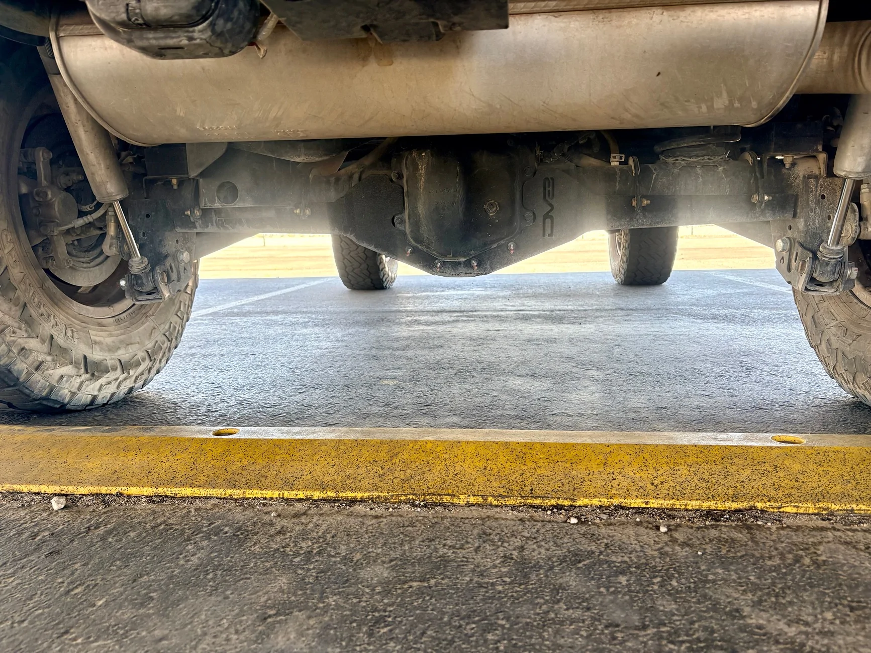

Our JK has HD dif covers. our JL has original covers and skids. Both have hit a lot of rocks. So far, neither leak. TBH with a JL I would be more worried about damaging cooler lines by the oil pan or the steering stabilizer than the dif.

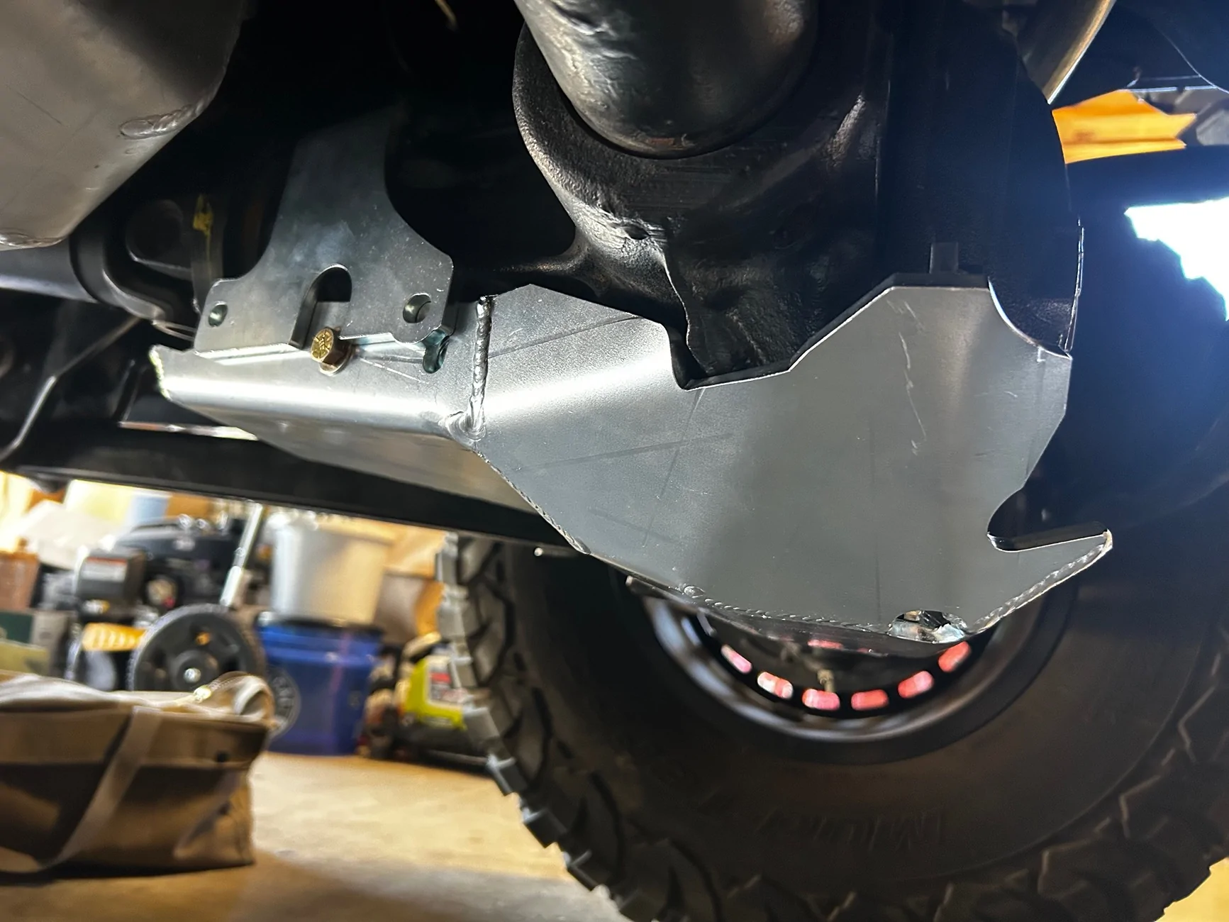

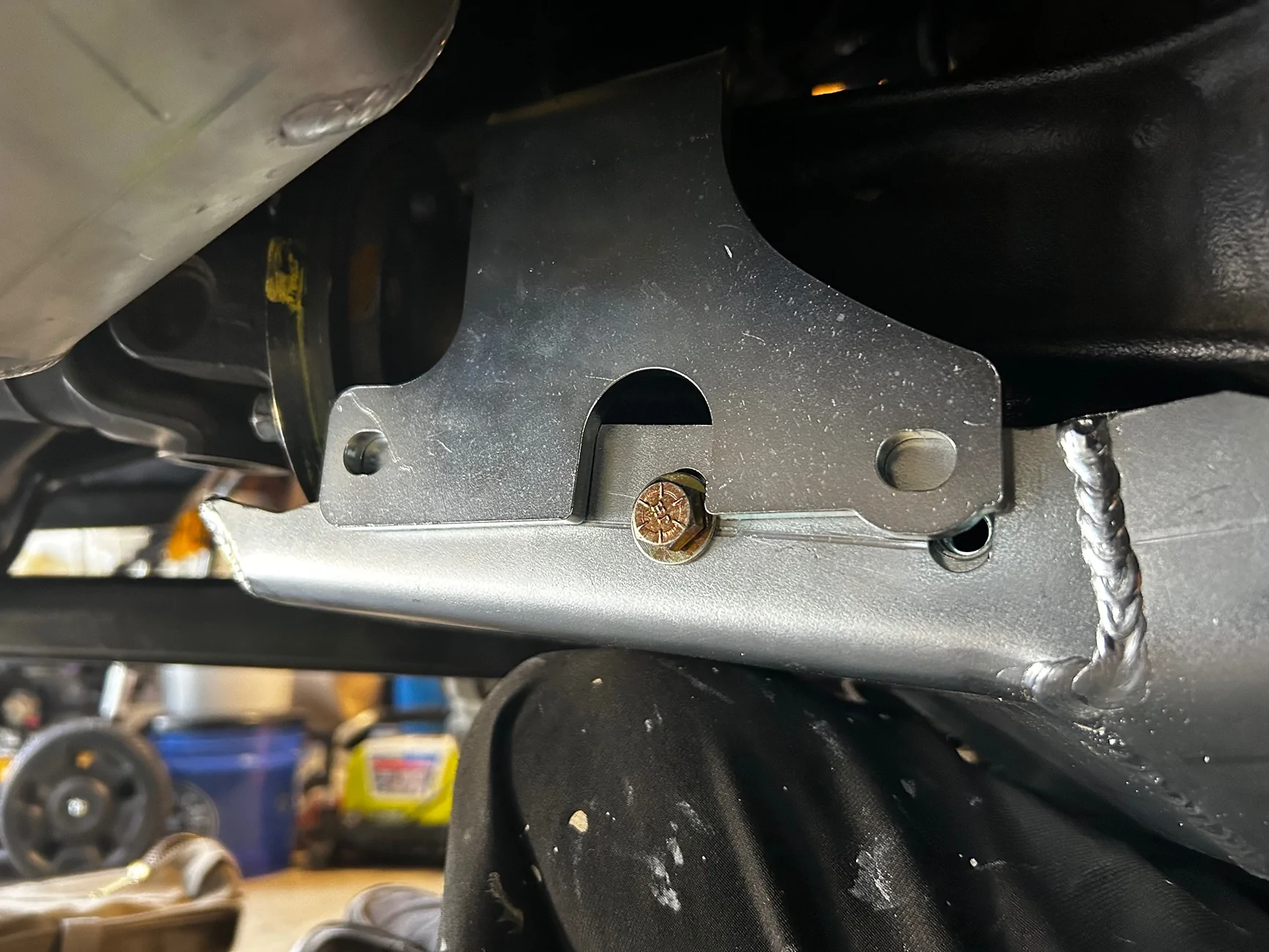

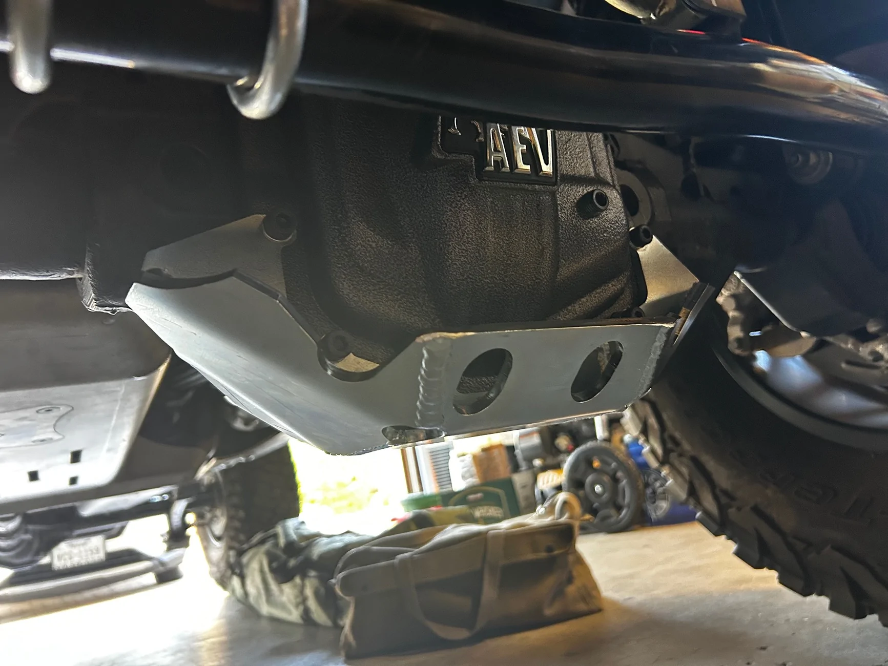

I’m with 3.5” lift and 37” tires. Off roading around Big Bear and Johnson Valley. Got the AEV diff covers and a skid on the rear which has taken some hits and done it’s job.
The front has a few minor scratches, so I attempted to install the Next Venture Motorsports front diff skid, but it doesn’t work with the thickness of the AEV cover despite what one of their customer reviews says on their website. The holes for the collar that goes over the pinion don’t line up because of the thick cover. Would have had to pay more money to have it modified at a local shop in order to make it work. Ended up returning it.
To be honest, I didn’t like how the front of the NVM skid mounts to the cover and hangs down to lose a couple inches of clearance. So, just rolling with the heavy duty cover up front.
I had the same experience with NVM's diff skids over AEV diff covers. A local shop was able to get them on after I failed to, but it required a lot of grinding.

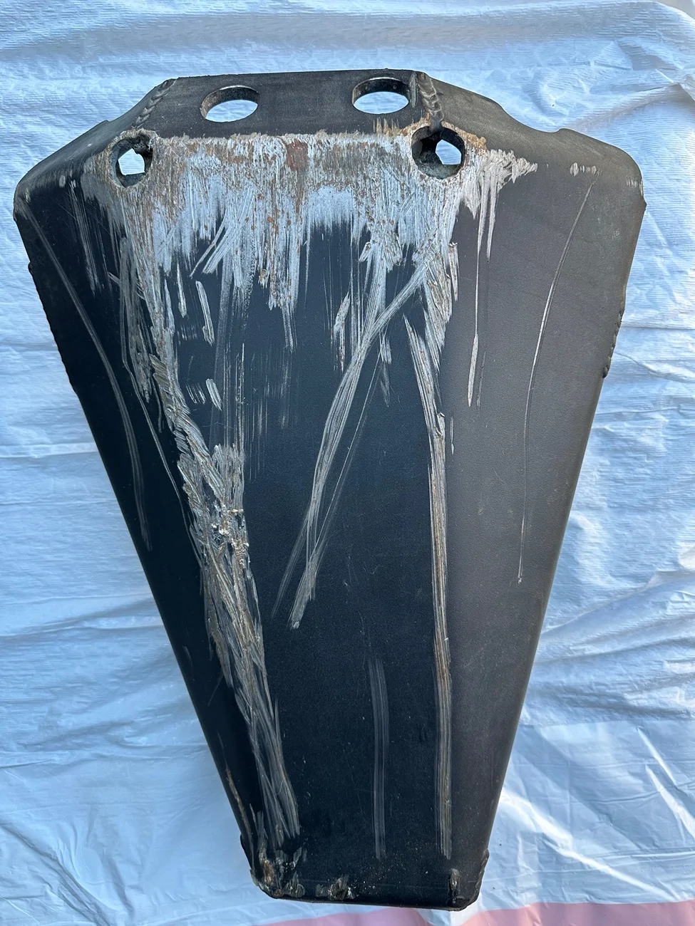

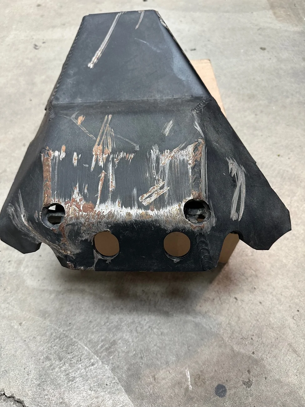

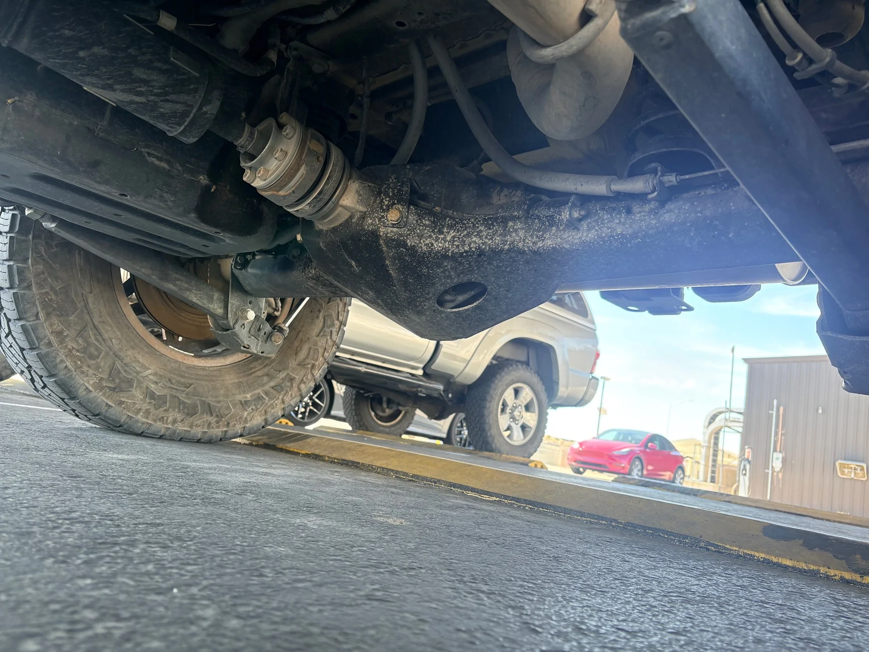

I use a cover on front but not on the rear.
On the rear I use a skid with the stock diff cover. I get the protection of the skid and better heat dissipation with OEM cover vs a 1/2” thick iron cover with no heat sink fins.
The DV8 rear skid also covers the axle tube. Maybe not necessary but I got it.
Jeep Wrangler JL Diff covers and Diff Skids ? IMG_2288
Diff cover peel back when dragged over boulders is the biggest danger and the skid I use offers good protection for that.
