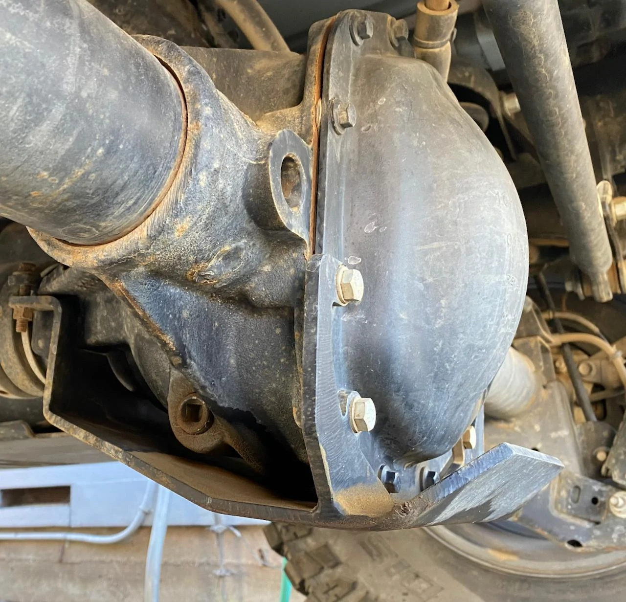

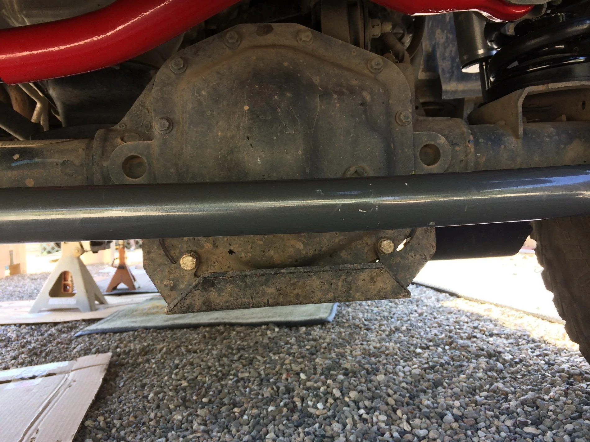

To the original post. HD covers are not needed if you install Rancho skids that deflect and cause the differential to ride over a rock. Much of the front diff. cover is behind and above the Tie-Rod and protected from bashing. They totally protect the front drain plug too....
Jeep Wrangler JL Diff Cover Upgrade vs Diff Skids vs both? rancho frt. skid
FAD design is the weakest link in the front D44 and a HD cover adds nothing to this issue.
Jeep Wrangler JL Diff Cover Upgrade vs Diff Skids vs both? JL rancho rear diff skid
The rear diff. cover does have more exposure without a tie-rod bar like the front. However the Rancho skid projects out past the cover face and protects to verticle when reversing. The likely hood of backing into an overhanging rock is very unlikely IMO. Issues mostly arise from forward movement an pealing the diff. cover flang. As far as a HD cover strengthening the pumpkin housing. The axle tube to housing is the weak link and a HD cover does nothing for this. Save your HD cover money for other armor.
