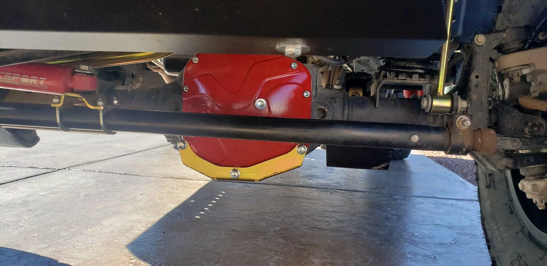

Thanks.I just used a good quality self etching primer then a couple of coats of hi-temp paint and never had any issues. It's also easy to touch up when you bang it on rocks.
Mine was a Poison Spyder cover but the process is the same for both. It's pretty straight forward, just take your time and do it right.Thanks.
Do you have the front or rear cover? I noticed on their website it says the front cover will not work with the factory trackbar.
like the red!I just used some primer and tractor and implement paint from Tractor Supply.
It looks like to me that's the MC track bar not the stock track bar. Although you can just barely see it just above the MC stabilizer.like the red!
Looks like you retained the stock track bar?
Thank you! coming from a Tacoma, the solid front axle is part of my new learning curve.It looks like to me that's the MC track bar not the stock track bar. Although you can just barely see it just above the MC stabilizer.
Definitely a MC track bar, part of the lift kit. Since this pic, I have added the MC drag link and tie rod. All blingy under there...but solid...and it flexes like nobody's business.like the red!
For the metalcloaxk front diff cover did you reuse the gasket? Or scrape and apply new?I just used some primer and tractor and implement paint from Tractor Supply.
I reused the stock one. It's like a lubelocker gasket in that It's reusable.For the metalcloaxk front diff cover did you reuse the gasket? Or scrape and apply new?
They did, it offers more protection for the pinion side of the diff. It should bolt to the cover the same.FYI it seems MC changed the skid setup with their front diff cover recently
