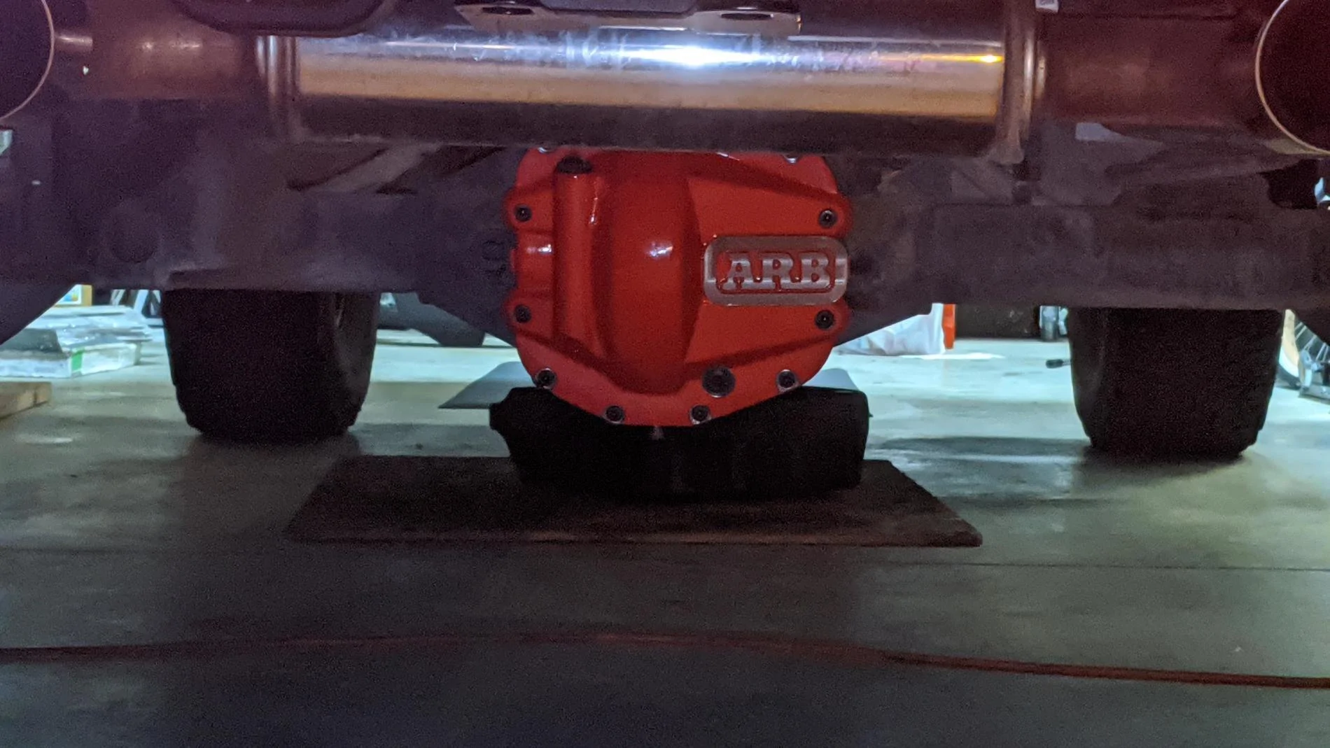

After a trip to the Daniel Boone Backcountry Byway in Kentucky a few weeks back and watching some guys bang rocks on their differentials, (one had a rancho glide shield on the front and glided right over them), I decided to add some protection. I didn't hit the rocks because I adjusted my line based on their experience, but if I'd gone first, second, or even third, I'd have bumped them, for sure. Anyway, I added a couple weeks ago a Rancho glide plate on the front to not only protect the cover, but the vulverable drain plug especially. I then turned attention to the rear, which I don't think is as vulerable, except to maybe backing into a rock.

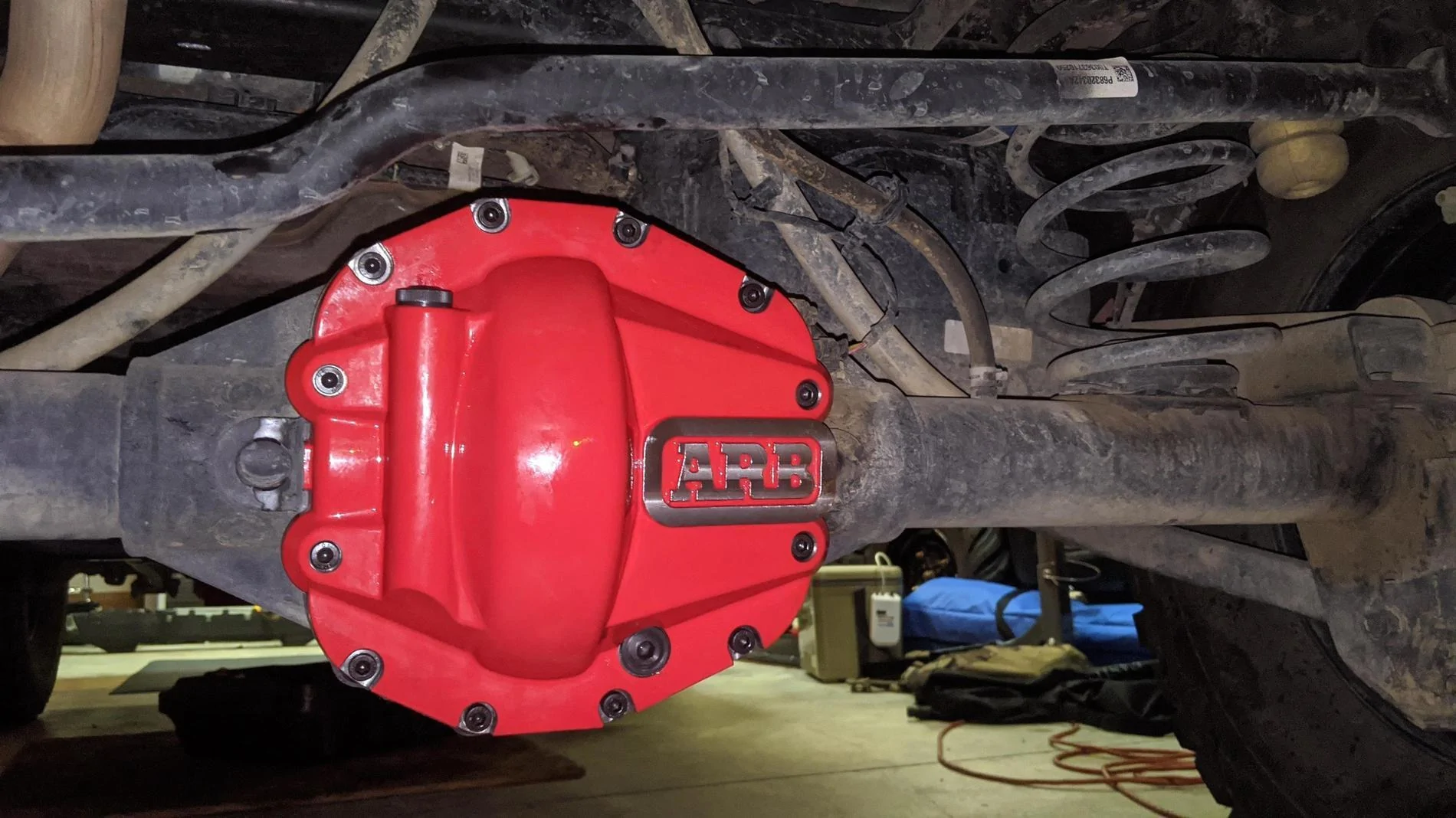

So i looked at all the diff cover options and I chose the ARB. I liked that the inside of the cover somewhat resembled the stock cover. I also liked the recessed bolts that use a hex wrench, so you don't have to worry about chewing the edges off of them. The drain hole is neither here nor there with me, since the M220 has a drain hole already, and the dip stick is ok, I guess. I had no problem with using the fill hole as a level.

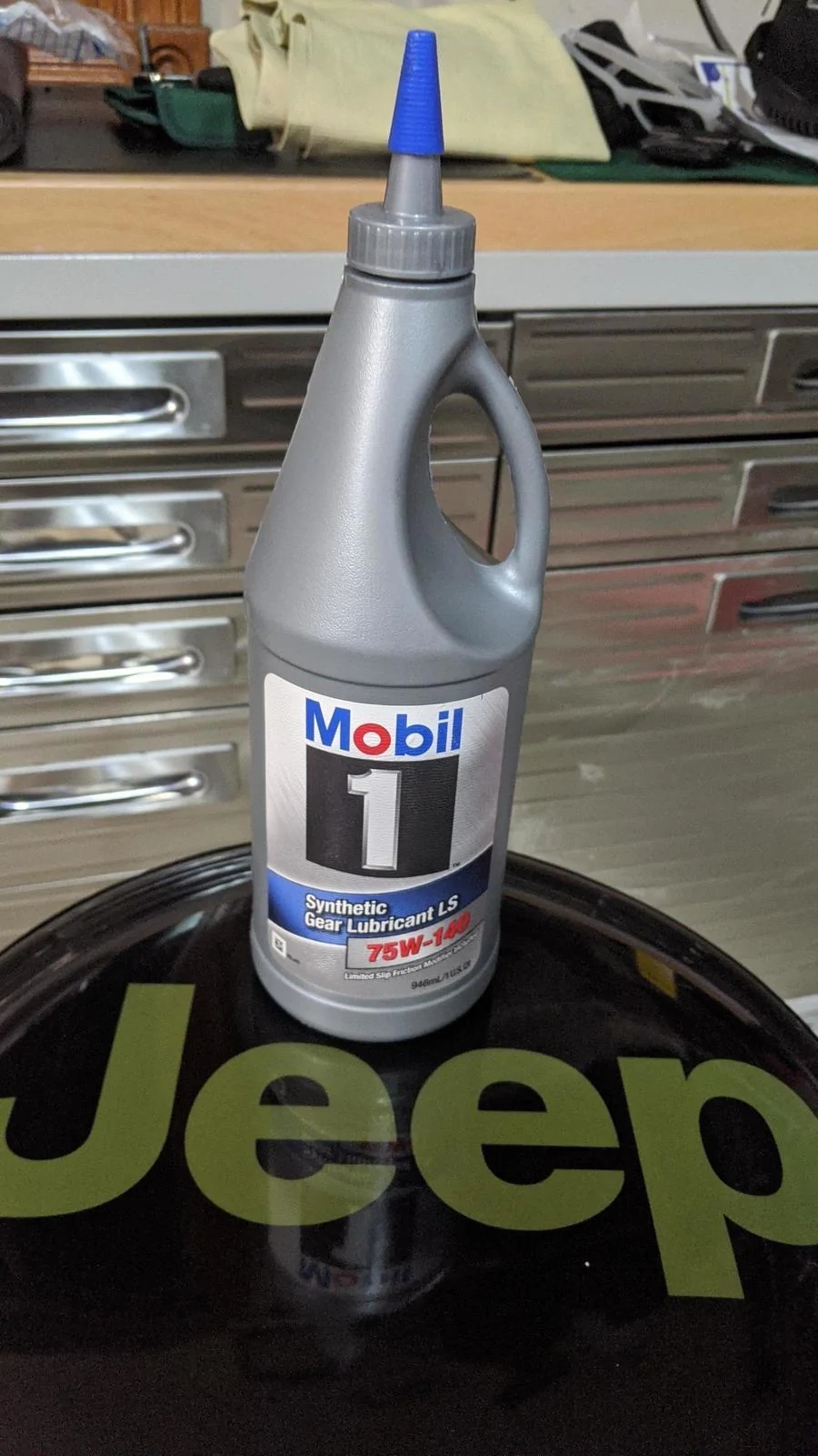

@CarbonSteel I'd like your opinion on this......I put the 3.06 pints of 75w140 in there. It came out slightly above where I marked the dip stick, which I did according to ARB's instructions, so it might be slighly high (maybe 1/4 inch over the mark) If I overfilled it, I don't think it is enough to bother the axle vent or cause any issue. @CarbonSteel what do you think of that? I just couldn't bear to put less than the rated capacity with the OEM cover. My bet is that the method of marking the dip stick is slighly off, or at least isn't that accurate. I wish they'd marked it from the factory, but this cover apparently fits multiple applications, so it does make sense.
