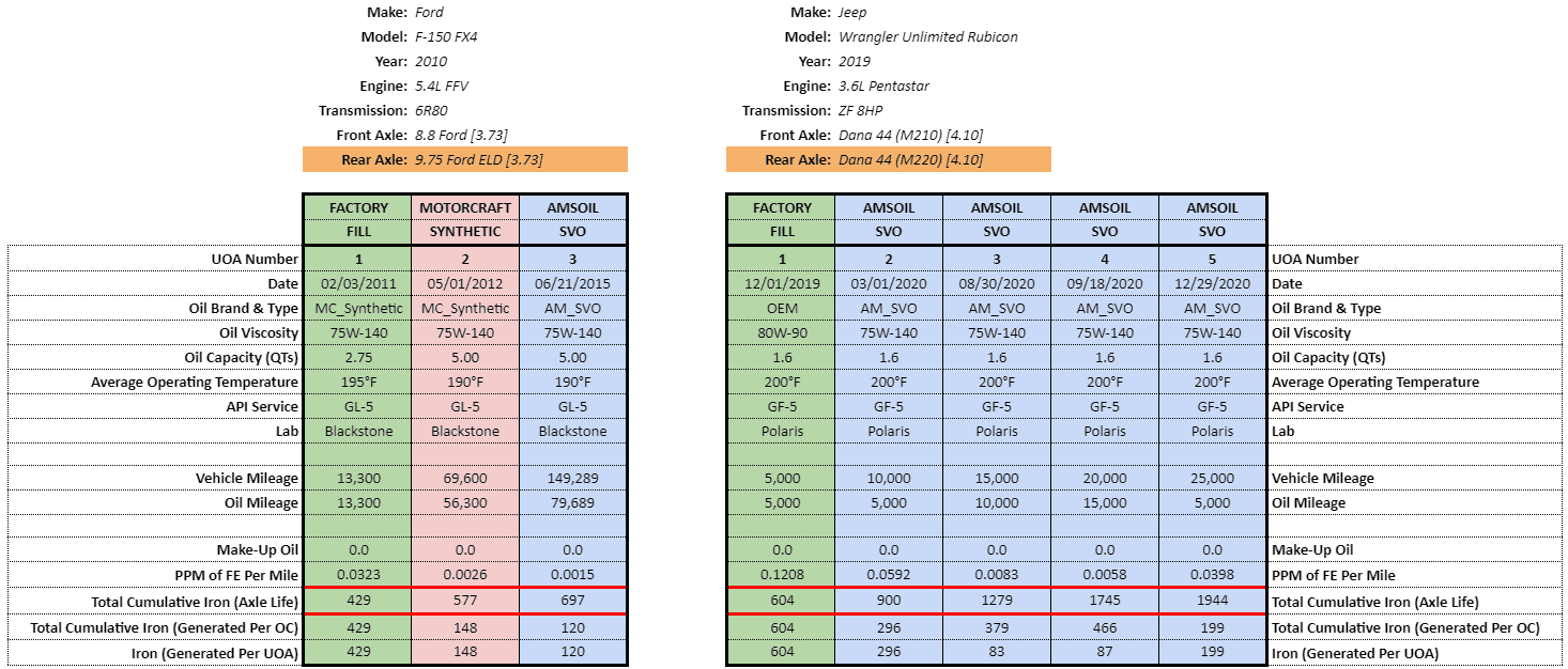

Well, I do not consider myself an expert, but have graduated from the school of hard knocks (no pun intended) :LOL:. The oil quantities that you posted are in line with mine and what others have posted (1.4-1.5 QTs in the front and 1.5-1.6QTs in the rear) for the Dana 44 Advantek axles so I think you are good at this point.
The capacity of these axles is less than other axles of the same size and (for me) this is not conducive to long oil change intervals (i.e. you should not go 100K without an OCI). For whatever reason, these axles also produce higher amounts of iron than other axles of comparable size and duty and that is also not a good thing since the oil system is splash and not pressurized or filtered. Now that I think my axles are fully broken in, I will likely land on a 30K OCI going forward if things remain the same.
To give you an idea of the differences between this axle and another, below are the UOAs for my 2010 Ford F-150 FX4 versus those of my Rubicon thus far. The FX4 towed 8-9K pounds for about 45% of the miles that were put on it. Conversely, the Jeep has not seen anything close to the loads the Ford had, yet look at the iron generation between the two--even for the factory fill on both. The Ford produced 429PPM over 13,300 miles (with about 3K miles of towing in there) versus the Jeep producing 1279PPM over 15,000 miles. In fact, the Jeep has nearly produced 3x as much iron in 25,000 miles as the Ford did in 150,000 miles.
The axle in the Jeep also runs hotter which is likely due to the lower oil capacity. I added a Mag-Hytec cover to the Ford which nearly doubled its capacity and through the life of the axle the average temperatures (loaded and unloaded averaged) are less than the Jeep not towing.
Add it all up and I am not sure what it means, but (for me) it absolutely means that I will be changing the axle oil more frequently than any other vehicle I have ever owned.
