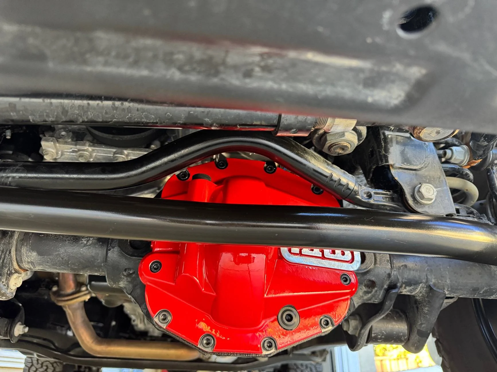

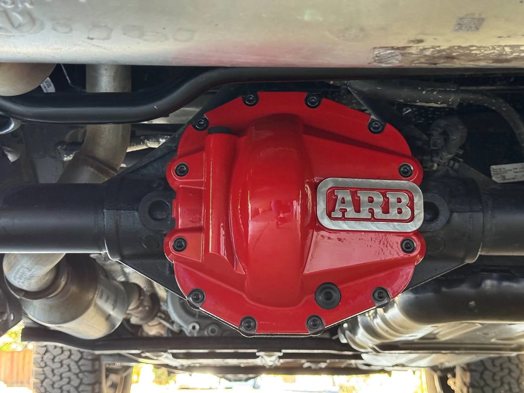

Covers installed, dipsticks marked, diffs are filled with some fresh synthetic 75W-90.
Front still takes about the same 1qt as before and rear took maybe a touch over 1.5qts
Excuse the mediocre photo quality 😅

Pretty sure the front needs more than 1qt but otherwise looks good. Somewhere I have the exact number.
-edit-
1.31qt-1.24L
1.83qt-1.74L

I did another drain and fill out of paranoia in case the new covers had something on then that I couldn't clean off (~100 miles or so on the fluid after driving down south today).
I don't have anything to measure with that much precision but i think I'm at 1.2qt ish in the front, maybe 1.75qt in the rear. I used 3 and a tiny bit of a fourth valvoline 1-quart bags. Indicating a touch higher than my markings on the dipstick (man those are tough to read!)
If I recall, the factory spec for the M210 with locker is 2.18pt (1.09qt) and the M220 with locker is 3.06pt (1.53qt), so I think I'm at those levels more or less.
Fluid level seems to rise a bit on the dipstick when hot.
:like:…of course I meant until the track bar is slight ABOVE the diff cover. Not below…
"Do what I mean, not what I say" 😁
Thanks again folks
