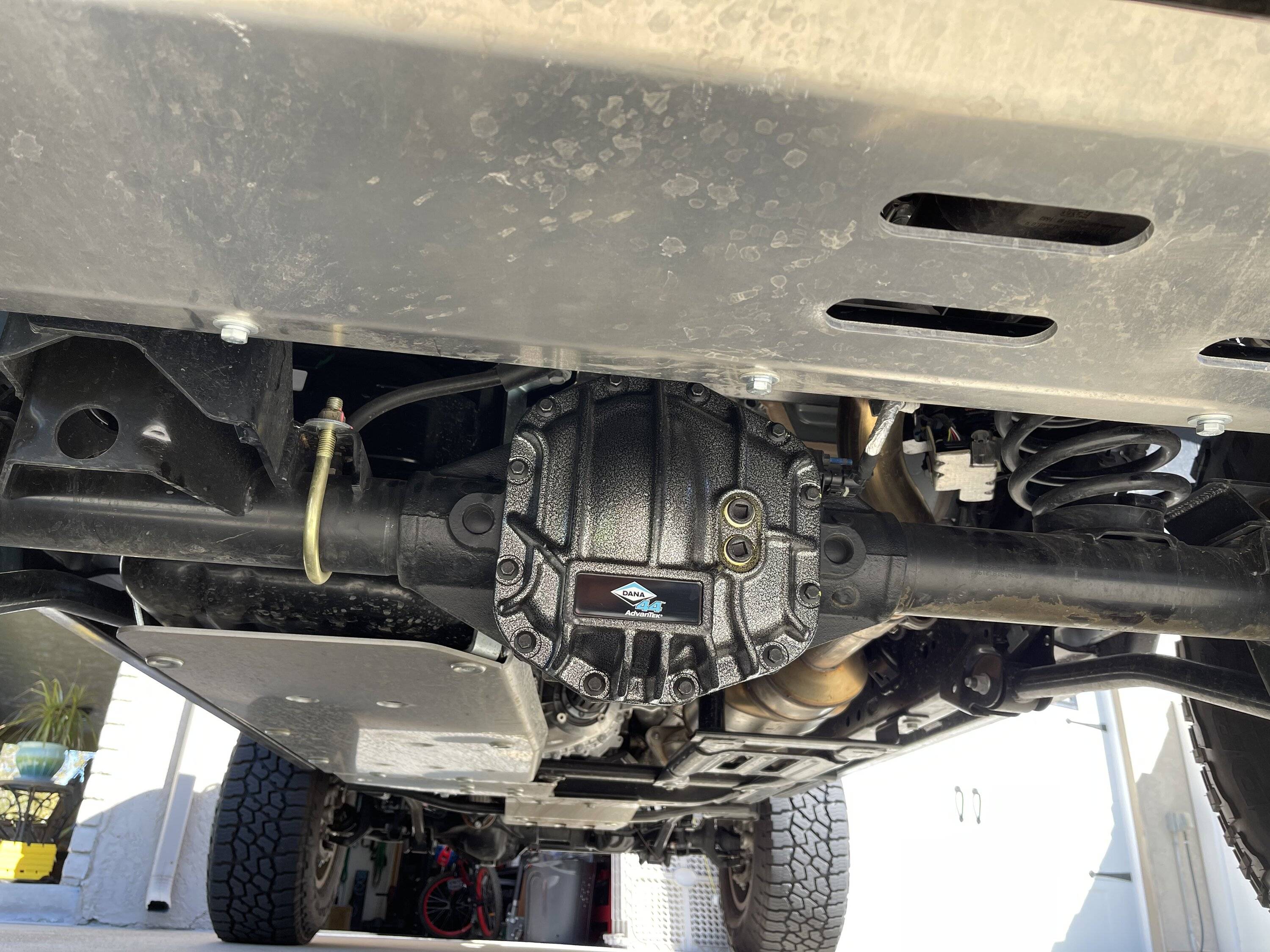

I personally went with the Dana Advantek covers figuring they were OEM in a way. I like the factory+ look to them and they are super beefy. Thanks @Roky for the inspiration!
That does look nice. If it had drain plugs I would like those better lol.
Yeah, drain plugs would be nice don’t get me wrong. At the end of the day it’s so easy to just crack the bottom open to drain thanks to the reusable gasket that the drain plug wasn’t a deal breaker for me. I figured with the Dana cover the dealer can’t argue they caused warranty issues. Or they can try and I’ll shut them up ?
