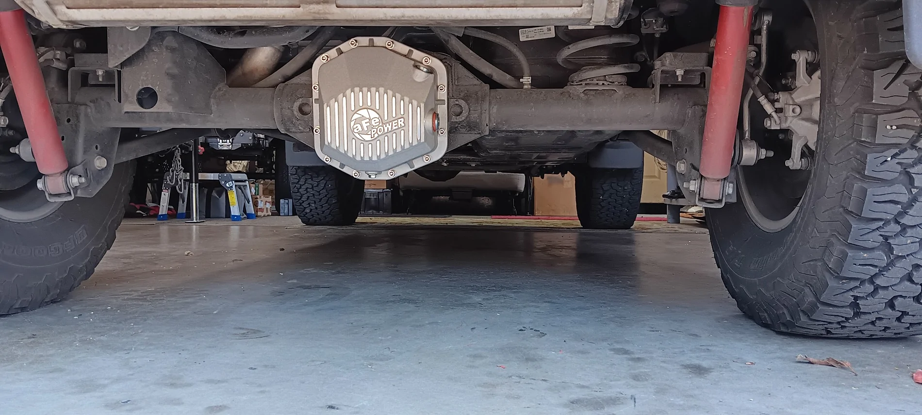

The other threads on the D44 got me rethinking this. I am thinking of using the AFE alu finned with extra capacity for the rear and either leaving the front stock or upgrading later with nodular iron. I tow a light off road trailer but with the electronics in there I would feel a lot more comfortable with having the extra cooling capacity over strength for the rear cover, especially since I do most of my towing in AZ summer mountains. What are your thoughts on this approach?
That's the rear diff cover I'm using, and for the same reasons. I too tow a small trailer.
Jeep Wrangler JL Differential Covers 20250414_141533
I love the idea of a sight glass to visually see how much oil is in there. I'm not in love with the drain plug location. My ARB diff covers have a hard life.
